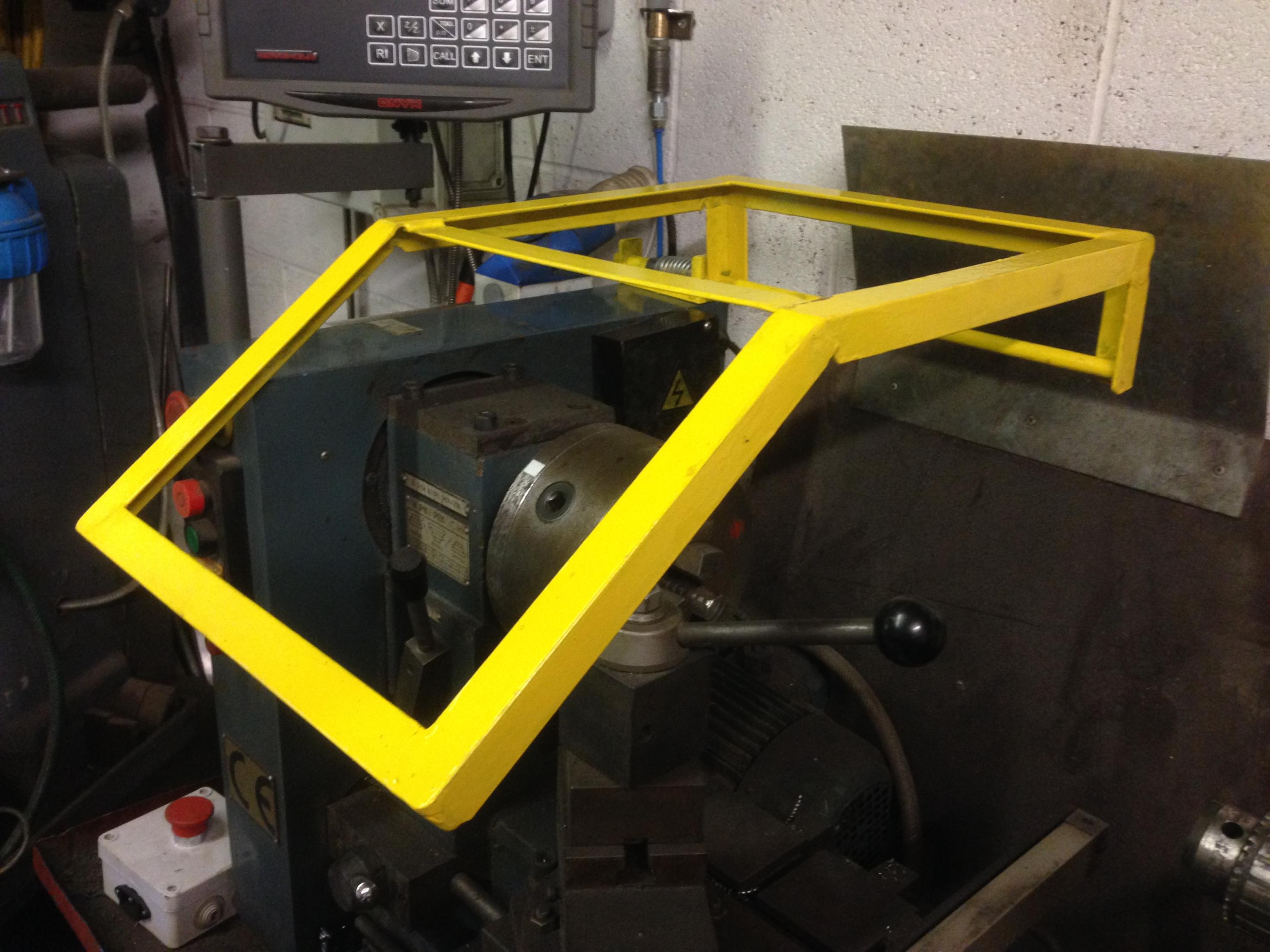

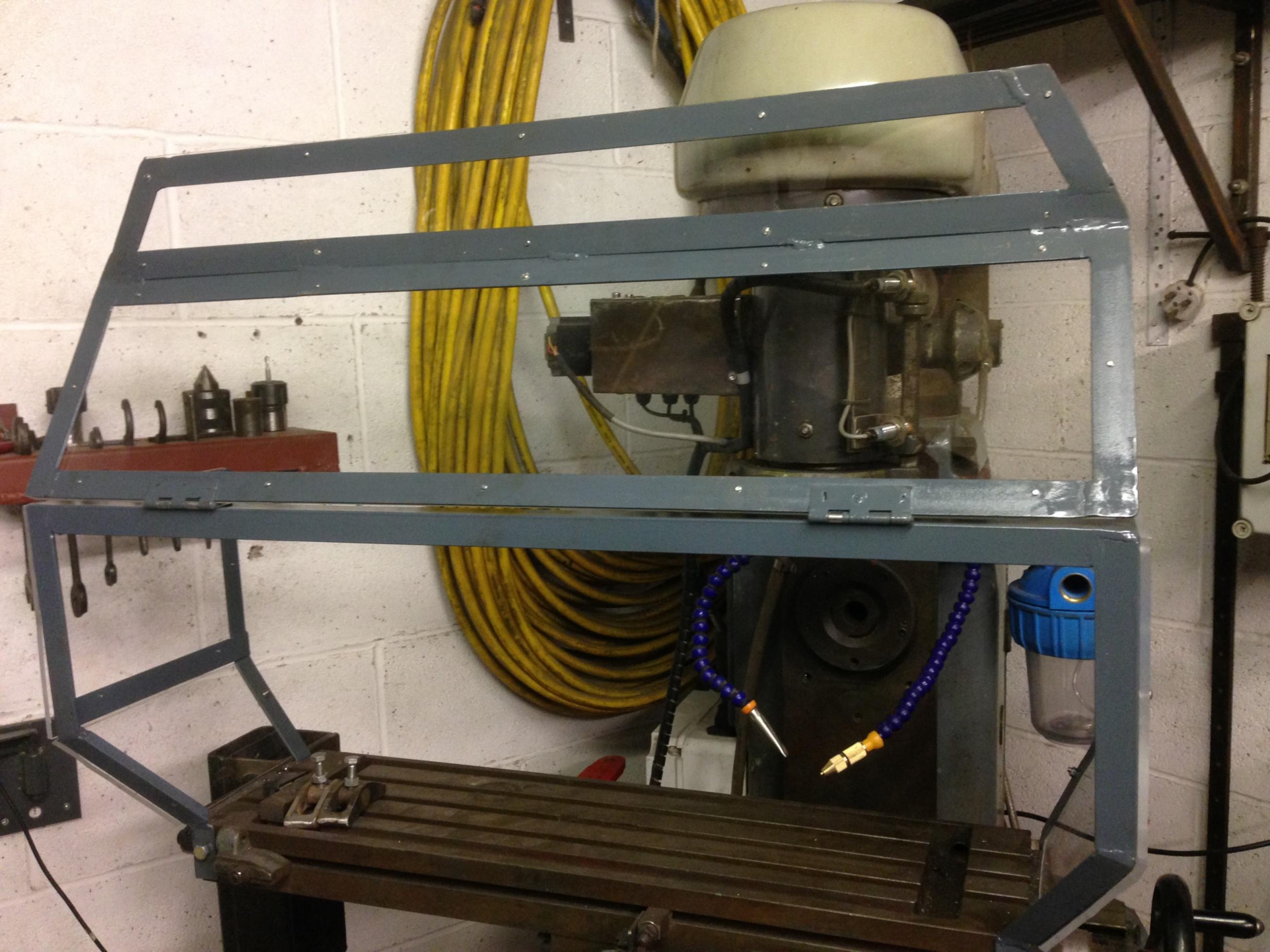

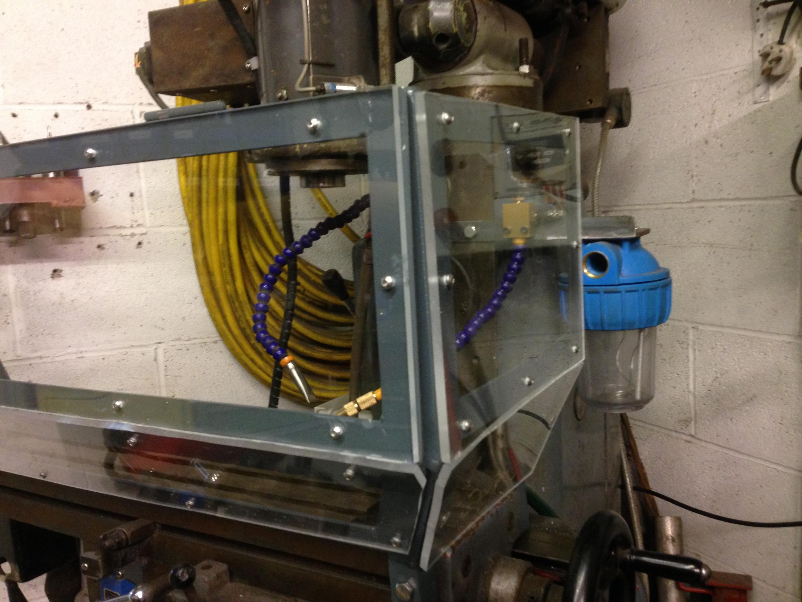

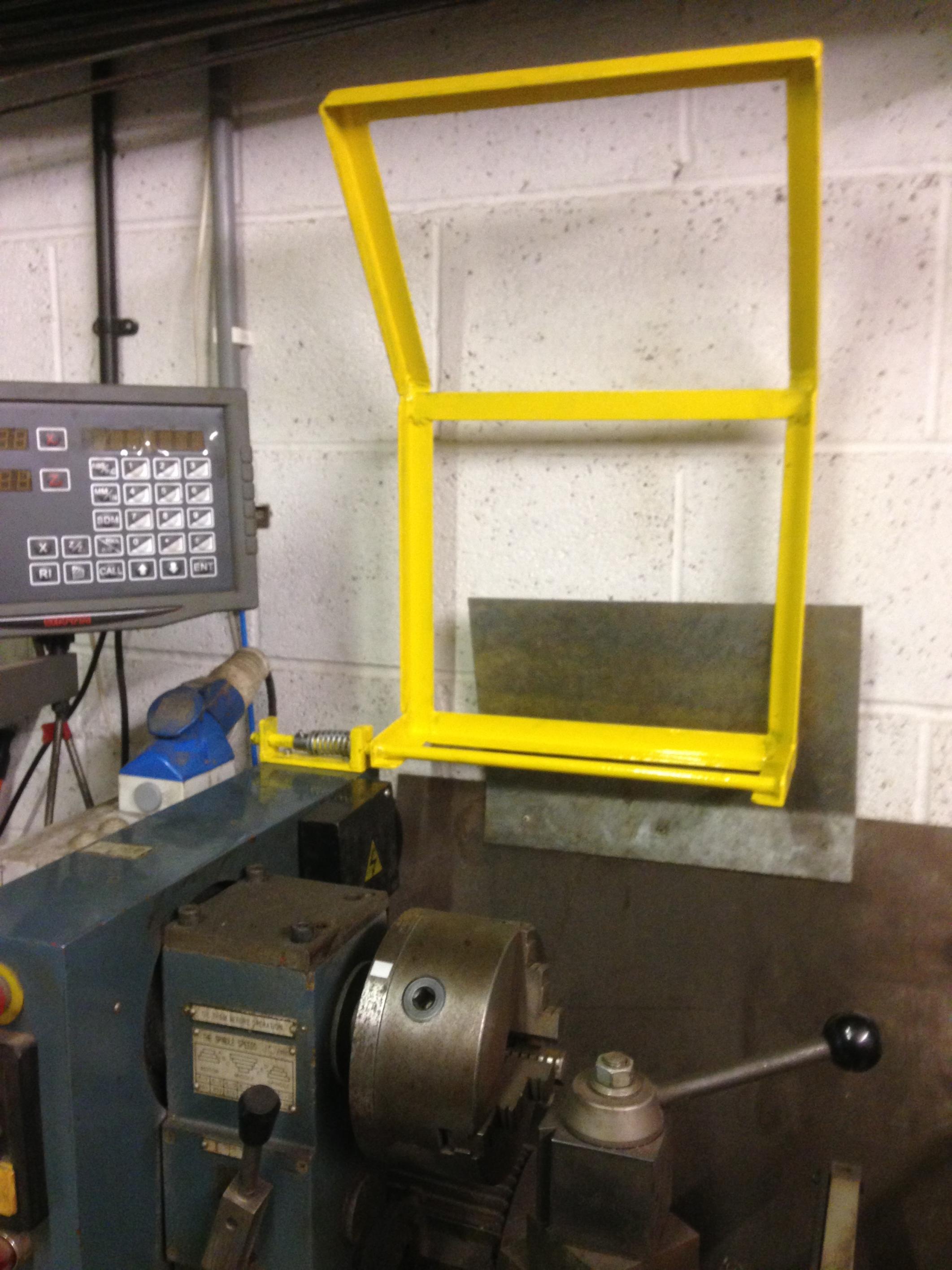

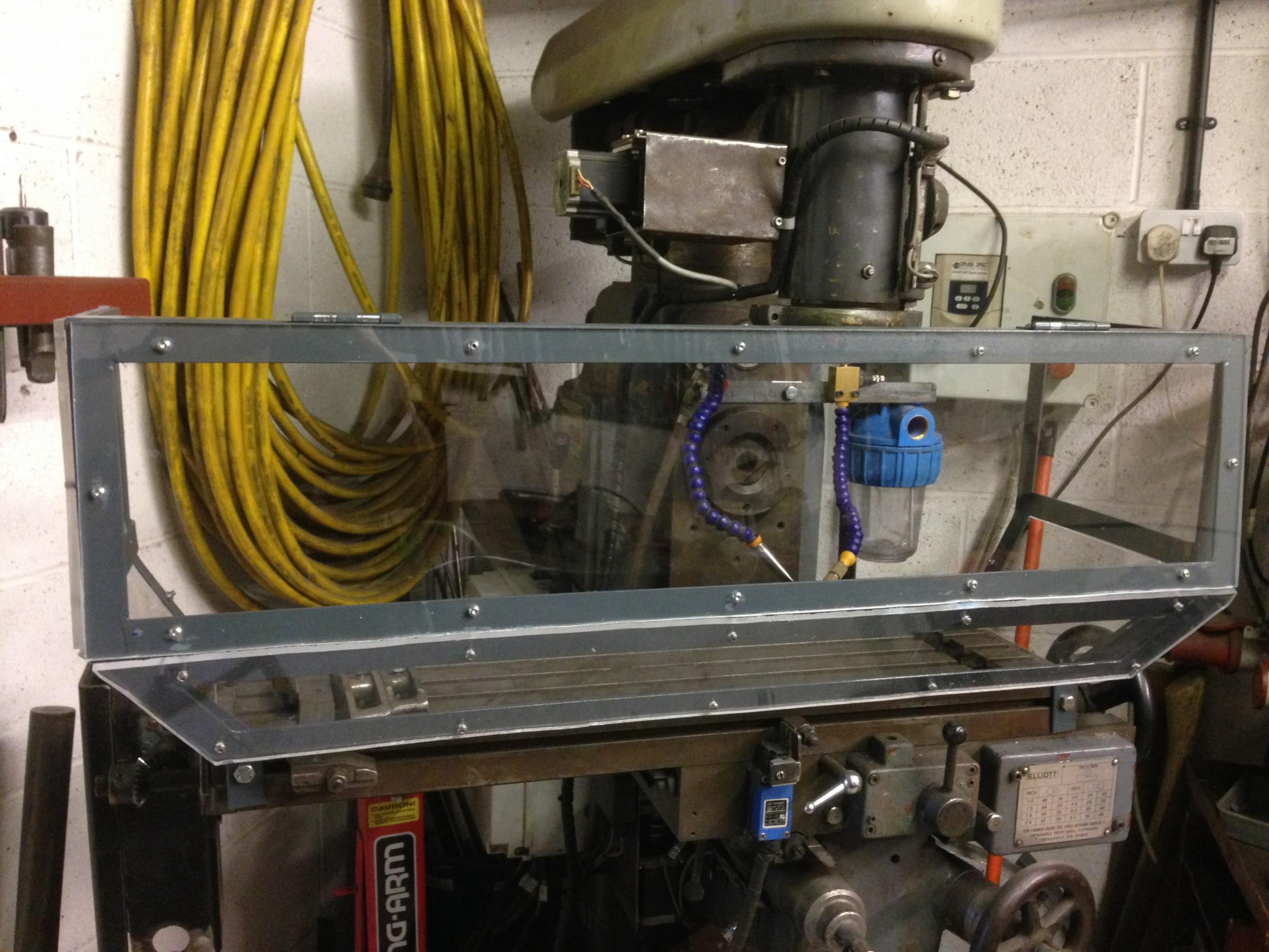

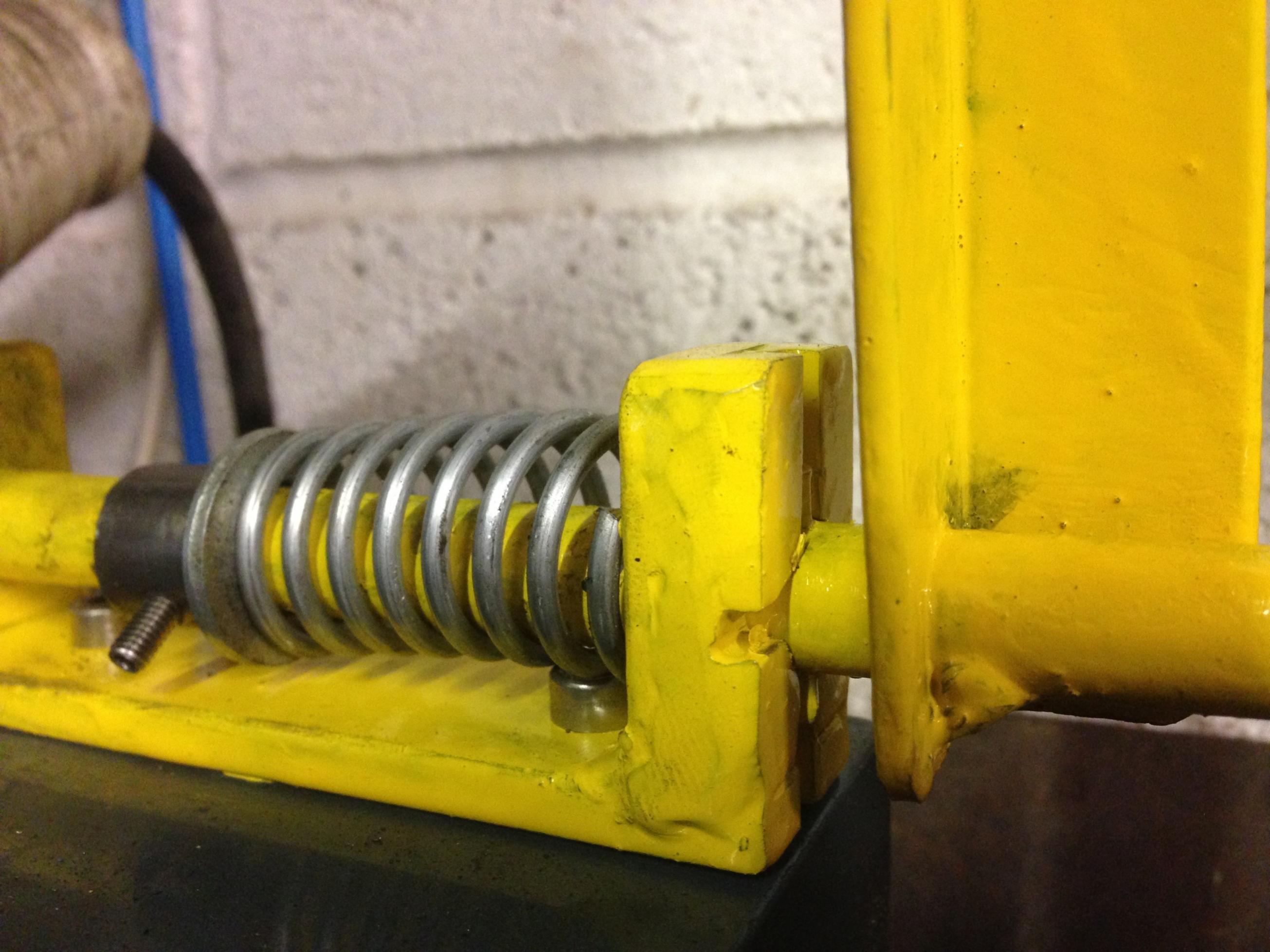

Having converted my old Elliot Miller into a CNC VMC, i began to scare myself with the prospect of throwing an end mill across my shop (not if but) when an NC file goes renegade. For this reason i have retro fitted a machine guard and whilst i was at it i made one for my lathe as well.
Attachment 19885Attachment 19886Attachment 19887Attachment 19888Attachment 19889Attachment 19890
hope they give ideas.
The frames have been made from 1" steel angle and flat 1" bar x 1/8th and clad with plexiglass (perspex or similar acrylic)
Some with a keen eye will notice the lathe guard has no plexiglass in it yet.
Could you use a steel mesh instead? you'd still have to wear eye protection, but you wouldn't have to keep cleaning it.
