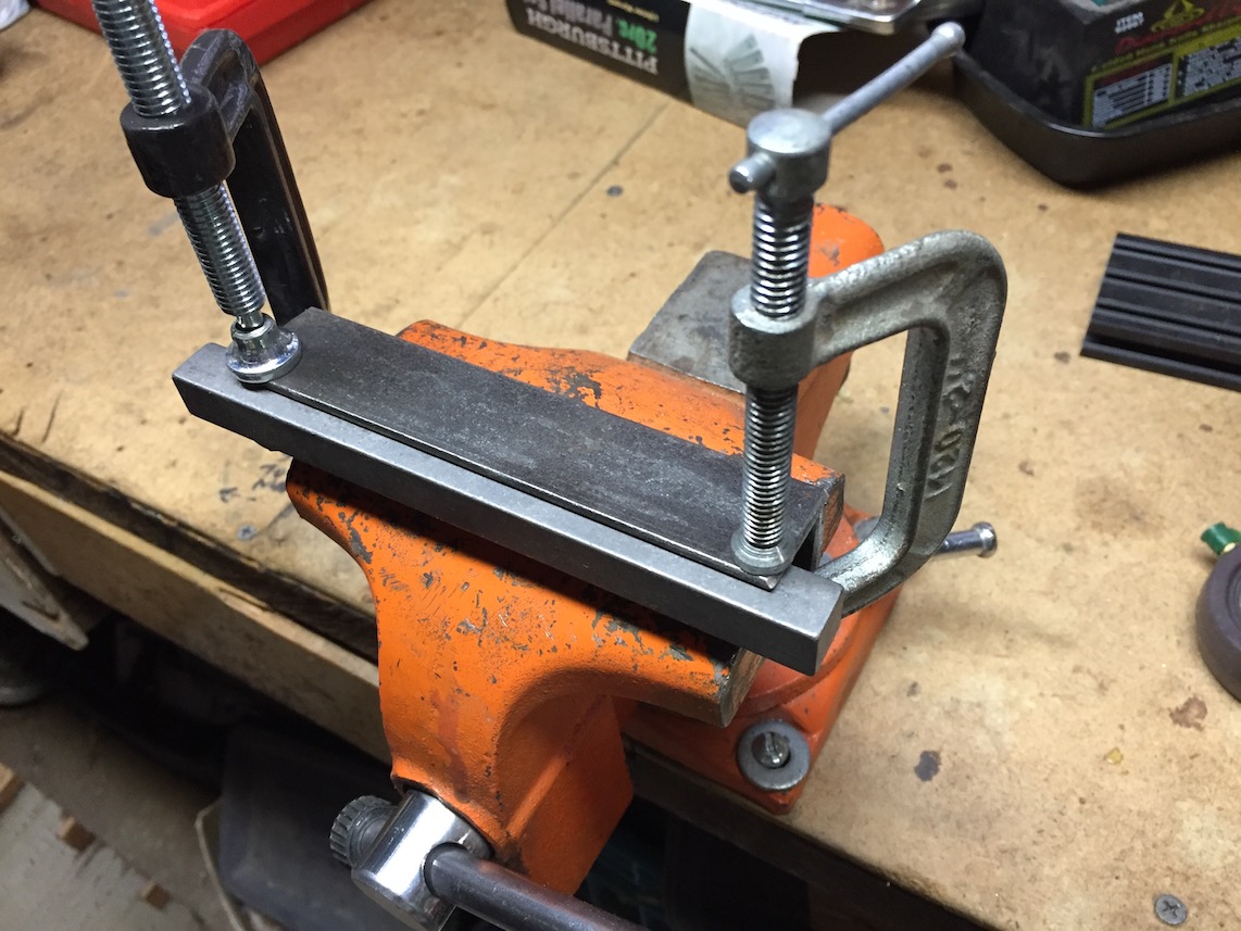

    I needed to thread the end of a 5/32" rod, and my vise just wouldn't hold it securely, so I made some V-blocks that attach to my vise with magnets.
    I started with a 6" piece of 5/8" key stock, and cut a groove with a hacksaw along the long axis on two sides. I used a short piece of angle iron, and clamped the key stock onto the angle. Then I filed out the grooves with a square file, about 1/16h " deep on one side, and about 1/8" on the other.
    Then I drilled some 5/16" holes on the other two sides to fit some rare earth magnets I had on hand, and bedded them with some epoxy.
    Finally cut the stock in half to create two jaws. (I forgot to take pictures before doing this)

    Thanks! This was more of a 'necessity is the mother of invention' kind of deal. If I were to do these again, though I'd make them with 1/4" magnets, as the 5/16" really didn't work so well, the holes on the adjacent sides broke through, but JB Weld covers a multitude of sins I have to make all sorts of jigs like that first picture because I couldn't hacksaw a straight line if my life depended on it...
