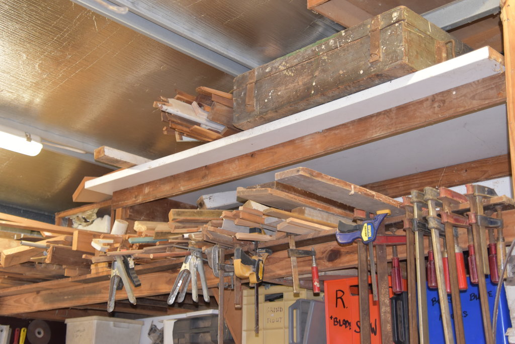

    I'm in the process of culling and packing so please excuse the current mess of my shed; but you can get the idea from the pics. Upside down shelves are also excellent above a bench. I have used such for many years as can be seen above my sharpening and mitre saw bench. You cane note my use of old book shelves hung upside down on the wall and another shelf joining the two allowing storage for large lightish items in that pidgeon hole.

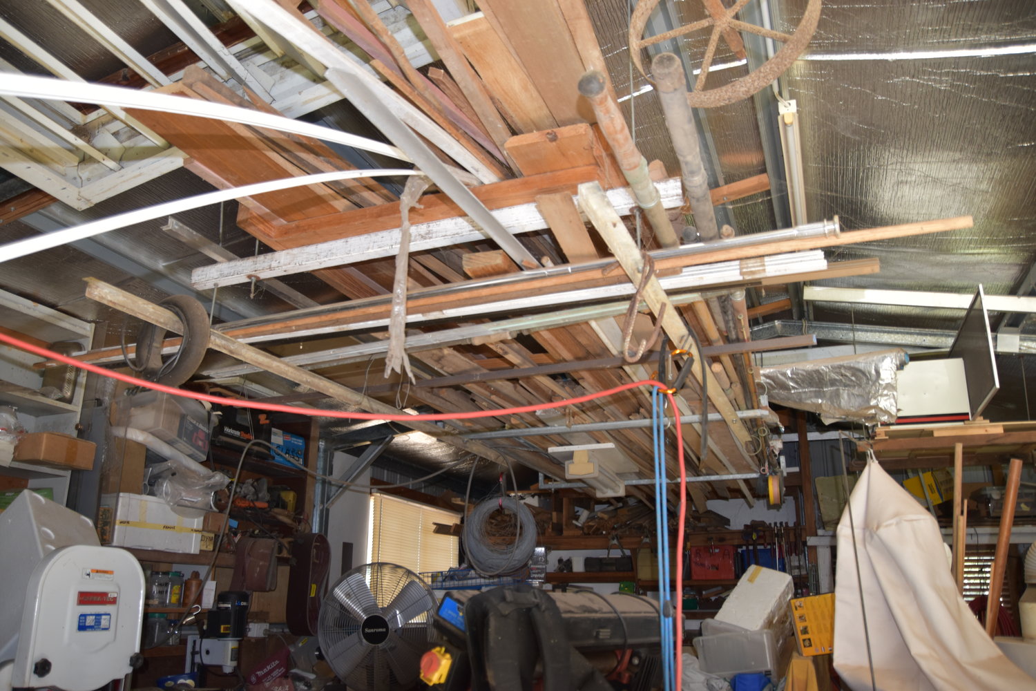

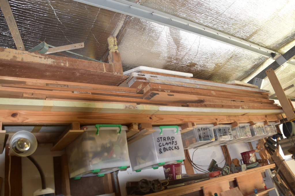

    I also like to incorporate hanging boxes for parts too big for the usual screw/parts containers and not too heavy requiring more solid storage but still at easy reach.
    The ones shown here are above a hinged bench and above a french cleat shelf that can be removed as necessary.

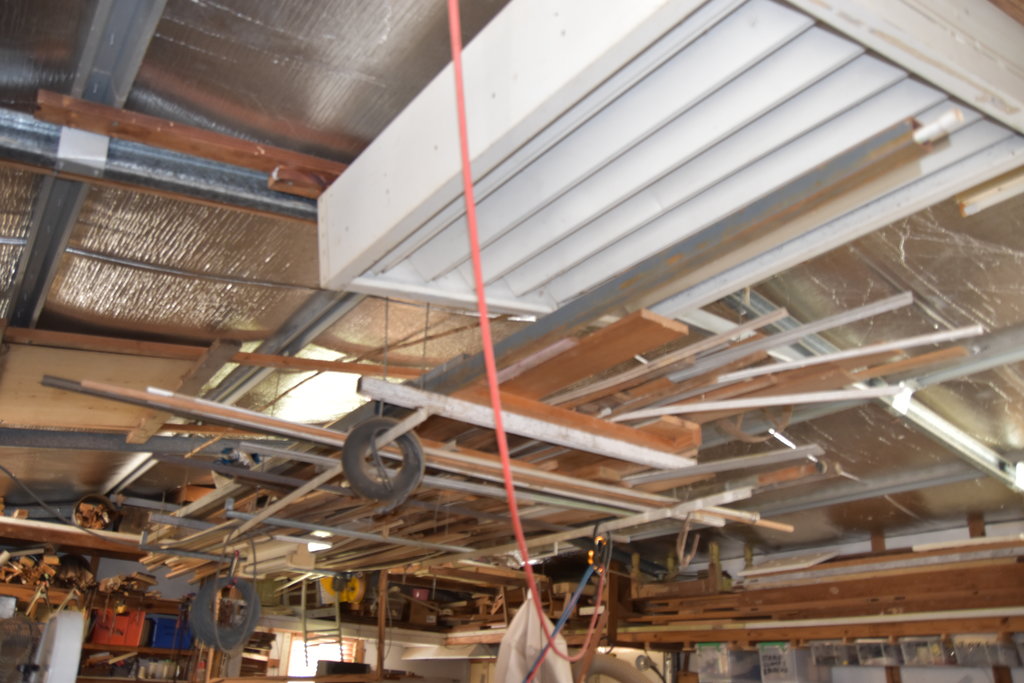

    I also like to get long steel ( up to 7 metres) and long timbers, fishing rods, conduit etc away from my feet so hanging/storing them above head height. this rack I built like a wall frame from framing timbers but with more cross members: then hung from the roofing structure (I have also done this from the floor joists in previous houses). The main frame which is lengthwise along the shed and opposite a door (in this case a roller door) is a prerequisite for loading and retrieval of such items. This is on one side of the shed to allow lighting along the middle. You need to be aware of the engineered loading allowable on sheds like my metal framed one. I used mudguard washers to spread the load and two nuts to lock the height once level. Previously I had a Canadian canoe hanging on the other side on upside down board rack type hangers =simple wood or steel pipe hanging on cyclone rods. Continuous rod & nuts allow levelling.

    For more storage of rod, timbers, etc up to 5 feet or so, I added another hanger below the large one, this time at right angles to the the upper one, allowing easy access from both sides.
    Old interior hollow doors are light and make good shelving as can be seen above the plastic hanging boxes and in the gable with my grandfather's on site tool box.
