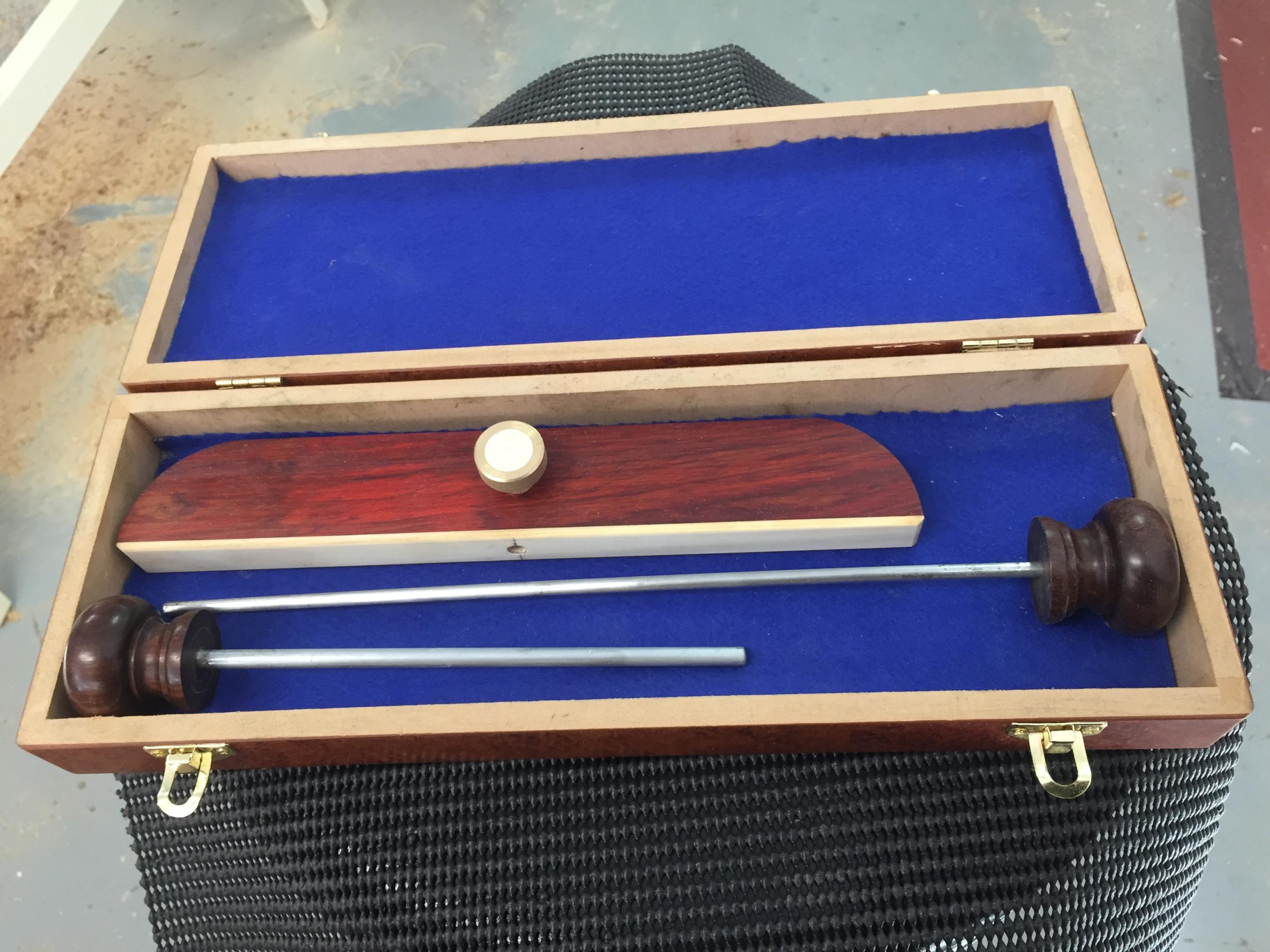

I love making something useful from offcuts and left-overs in the shop. Consequently, I never throw anything away. I keep odd brackets, offcuts of wood and metal, spare knobs, bolts, nuts etcetera etcetera.

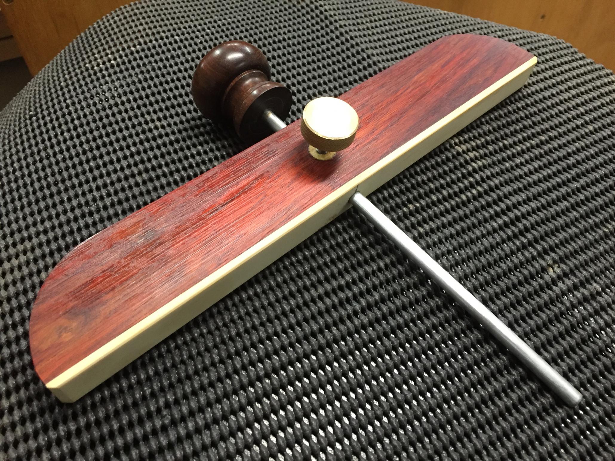

Last weekend I came upon a lovely little piece of Padauk in my offcut box while looking for something else. “Aha!” I thought. “What to do with this!” I figured something to go with my newly acquired wood lathe would be useful. The result was this:Attachment 8247Attachment 8248.
A bowl depth gauge. The piece of Padauk is 11″ long which is very close to the swing capacity of my lathe and the depth rod shown will dive 5.5″ into a bowl.
This is sufficient for most of what I intend doing with the lathe but if I need to measure deeper I simply insert a longer rod. I had an empty wooden box that something came in years ago (Yes I keep boxes as well!). What originally came in the box I cannot recall but it serves very well to house my handy, new bowl depth gauge set. I lined the box with blue felt left over from the recent chess set project.
The gauge body is, as I have said, made from Padauk with the wear plate made from an offcut of artificial ivory (Elforyn). A wear plate is not really necessary on this tool but I felt that it would give the tool a more finished look.
I made the brass knob and insert from offcuts of brass rod. The two wooden knobs on the ends of the rods are Gidgee I think. They have been knocking around the workshop for years so I didn’t have to turn them. Total shop time involved in this little project was about three hours, a good part of which was spent rooting around in drawers and presses for the bits and bobs used in the making.
