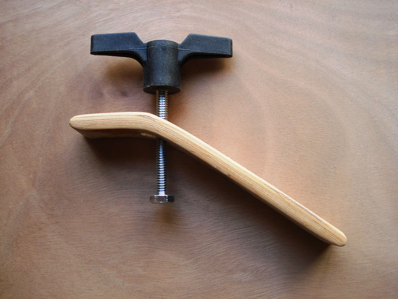

    Thanks for comment, Ed Weldon. Indeed, by laminating several layers of solid wood you can obtain a block of the desired dimensions. In addition, it is one of the techniques for bending wood, like this hold down clamp:
    MALE/FEMALE THREADED KNOBS-dsc02457.jpg
