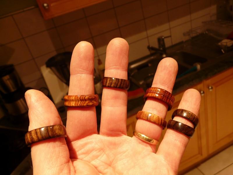

And with this kind of tool, you can make this :
http://www.labellenote.fr/photo/gal_...es_fev2014.jpg
