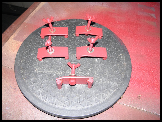

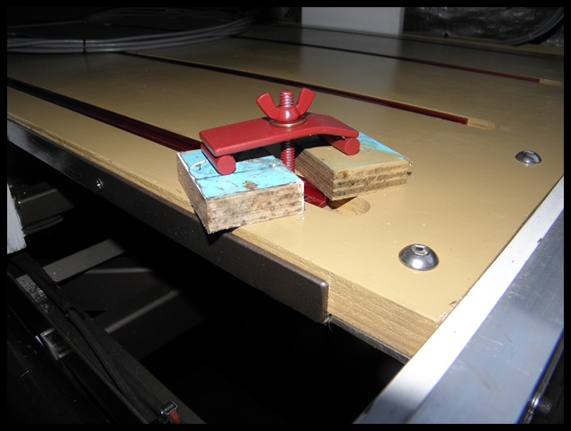

Material hold downs. Made from 1"x1/8" bar stock,3/8"round stock and 1/4 " bolt with wing nutAttachment 15263Attachment 15264
Nice work Capt. They look nice and strong
