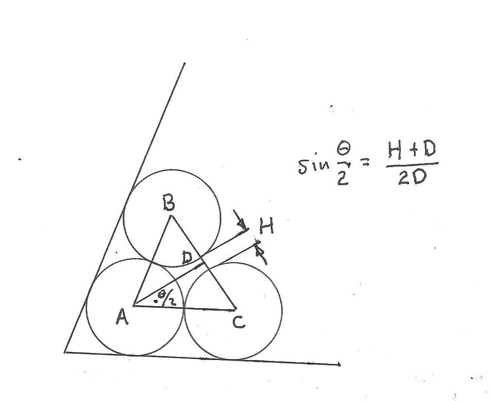

Measuring acute angles accurately
In a previous post...
http://www.homemadetools.net/forum/b...959#post100924
I mentioned a method for using three, equal diameter, rods or disks to measure an obtuse angle accurately.
The same method can be applied to acute angles, although the mathematical relation is slightly different than that for the obtuse case.
The attached diagram should make the procedure clear. 'D' is the diameter of the rod/disk. Theta is the angle to be measured.
Attachment 20128
