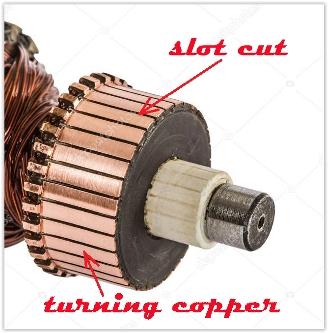

This lathe was used for the manufacture of electric motors.

Interesting lathe use, as years ago as a wrench (specialty carb/electric shop) I used to use a lathe for doing bus/car/truck starter motor and old generator rebuilds for the same thing...turn/cleanup and scrape the buildup out of the slots on the commutators. Also to clean up the bearing surface with fine emery. Too Cool!
