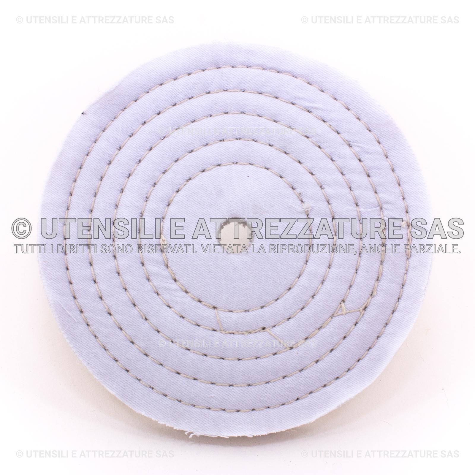

I'm finishing my belt sander, with an attachment for polishing.
I'm wondering what I have to buy, I need to make a very shiny and good surface on aluminum, brass and steel.
I found:
Disc:
- cotton soft
- cotton lined
- cotton\sisal

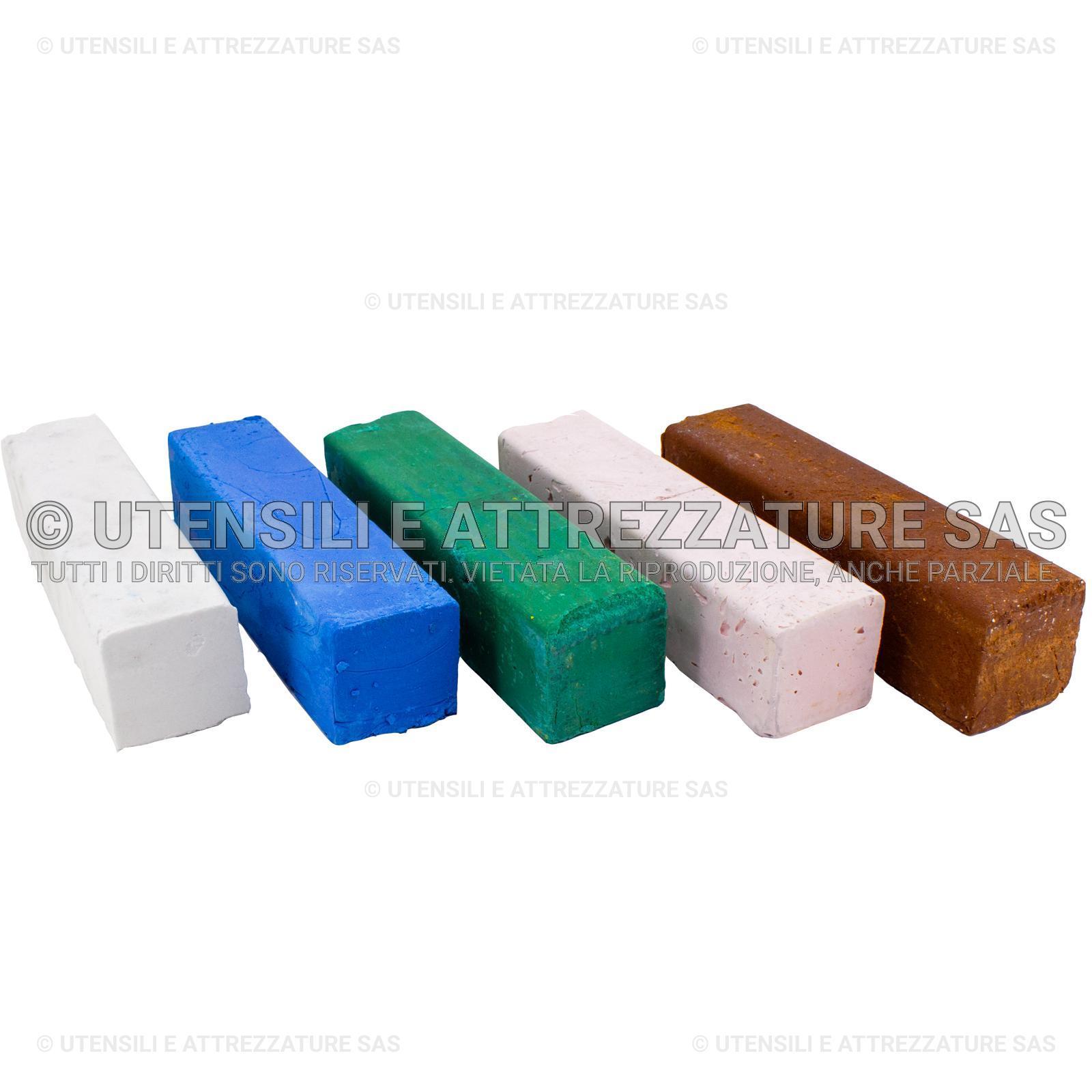

Paste:
- White roughing ( i have already )
- Blue buffing , 2nd passage
- Pink polishing alu and brass
- Green (only for stainless?)
- Brown scratch removing gold silver
My question is: which paste should I buy? I think all 4, maybe the green is not useful?
Second big question, it's necessary one cotton disc for each paste or it's possible to mix the pastes on one disc?

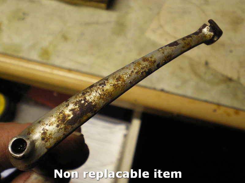

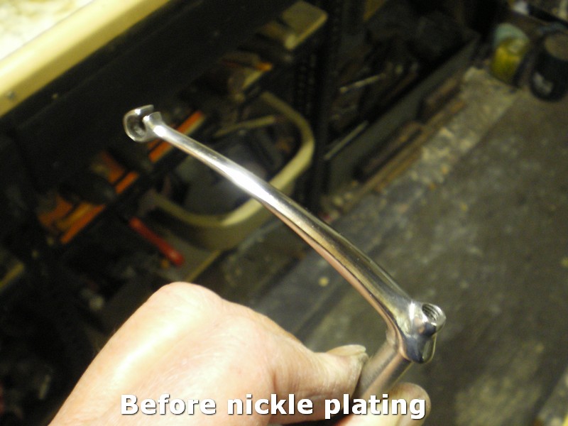

Best advice is to download from Plating Kits Electroplating Kits Aluminum Anodizing Kits Gas Tank Sealer Metal Polishing And Buffing Supplies - Caswell Inc a free PDF guide to all metal finishing.
If you are serious about it I would beware of cheap products as they have not worked well for me in the past.
Golden rules are one wheel for one abrasive (never mix), and keep in bags when stored, I do a lot of restoration work and have learned the hard way. Good luck with it, a couple of examples of what can be done.Attachment 19531Attachment 19532

This site is really useful and well equipped of item. I noticed some differences between colour of paste, a black and brown before the white.
This ebay seller should be fine for products (i hope), I tend to avoid shipping from US because of costs and custom, it's 30% more or less. It's the best quality found yet (in italian sites). In hardware store, here, it's a big shot find something for polishing, they have only small brush kit for drill and 2 tiny pastes,nothing professional.

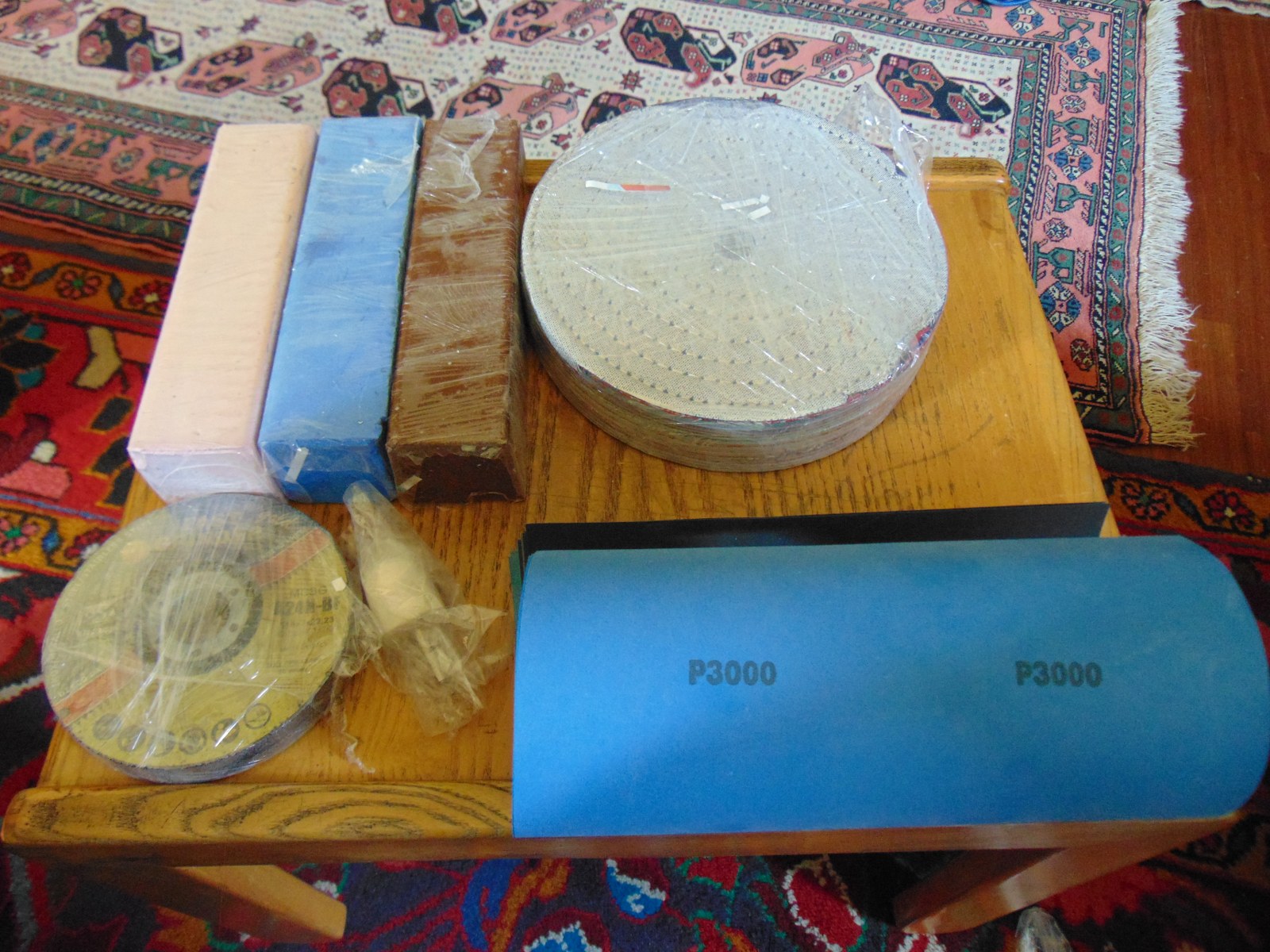

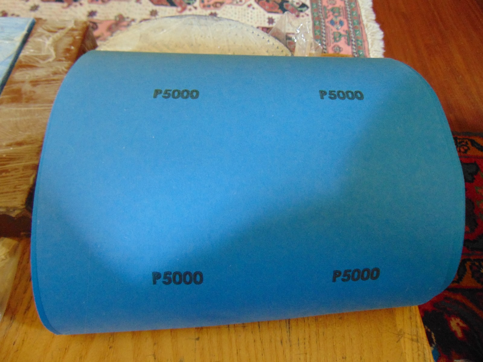

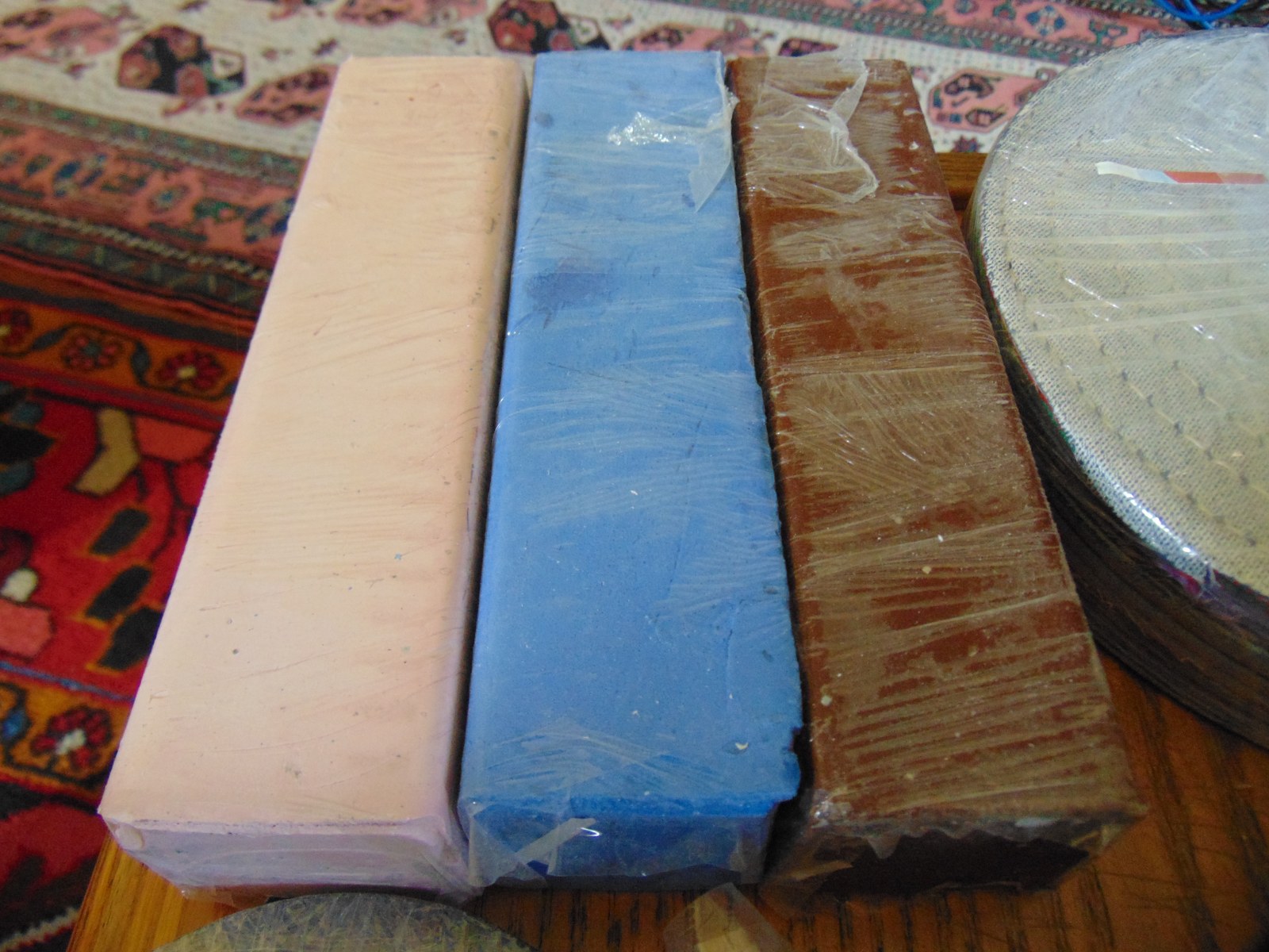

Just arrived!
Since I have the White (first passage) paste I bought the pastes for cutting and polishing, with 3 cotton wheel 200mm, complete set of sand paper from 40 to 5000 grit
I hope I will test soon!
Attachment 20297 Attachment 20298 Attachment 20299

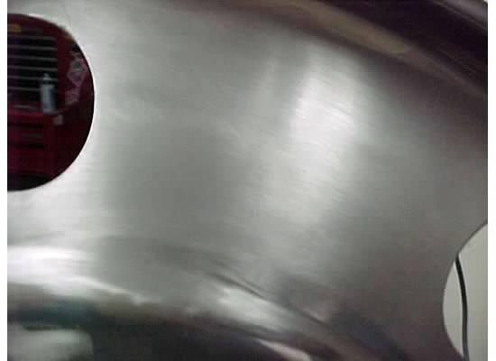

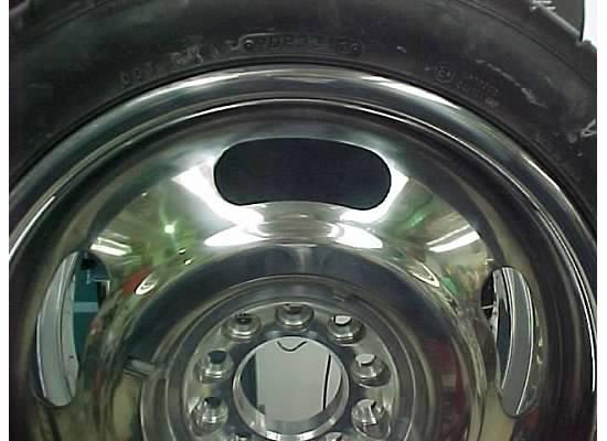

What are you polishing? I do a lot of aluminum polishing and use wet/dry sandpaper from 400 to 2000 grits. Anything above 2000 and you are mostly wasting your time. Here are some wheels I polished a couple of years ago. These were brand new and looked terrible out of the box.
I posted this on another site so I am going to copy and post those posts here. This is a pretty good tutorial so look thru the posts and ask any questions you may have.
Follow along in the next couple of posts. :)

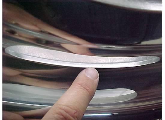

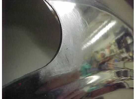

A little disappointed on the quality of the polishing job. The other three rims are okay, just this one is a sad job.

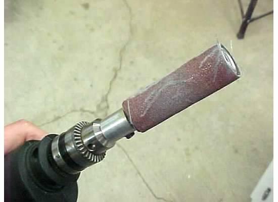

I broke out a sanding drum on a drill motor with 180 grit emery paper to start cleaning up the file cuts on the new openings.
http://im1.shutterfly.com/media/47a4...D550/ry%3D400/
after a few minutes of work this is how they turned out.
I ran the drum on the openings going from the 180 to 400 then 600, 1000 and finished up with 1200. Smoothed the edges good enough that some heavy polishing will bring the shine back.

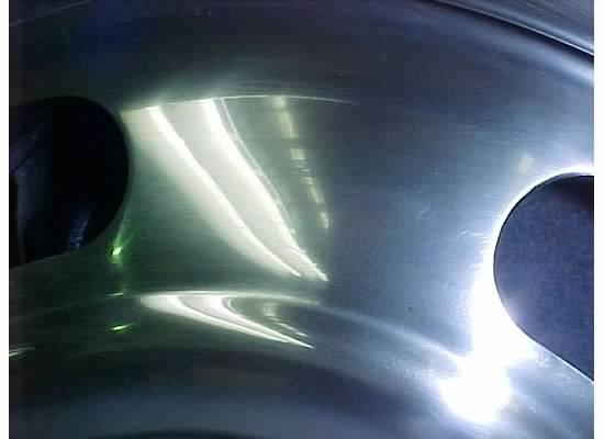

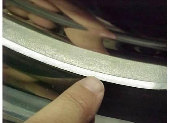

Once I had that done I got busy taking out the scratches and gouges. I started with 400 grit on a rubber Dura-Block and started feathering them out.
Once I started sanding I ended up going over the whole face of the wheel. There were so many heavy cut lines and deep grooves from the half-assed factory polishing this was the only way to get a smooth surface... You can see the waves in the pic to the right of where I started sanding.
here is another pic after I had most of the scratches and gouge worked out. This also shows the waves better.

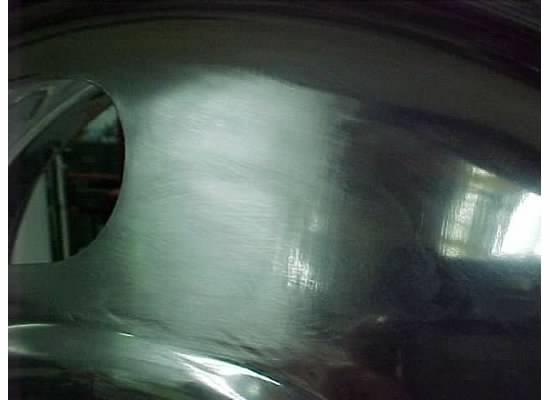

I used WD40 as a lube to "wet sand" all of the waviness out. I spent about an hour and a half doing this. Cleaning and re-sanding until all of the low spots were gone.
The hard part was getting the surface flat again. Once that was done it only took a couple of hours to step up through the grits. Going to 600, 1000, 1200 and then 1500. You can see the shine is already starting to develop at 1500.

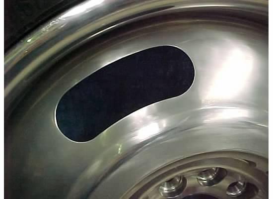

I ordered a nice polishing kit from Eastwood so I'll get all of the rims sanded out to 3000 grit before I use that.
The wheel looks a ton better with all of the openings repaired!

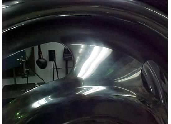

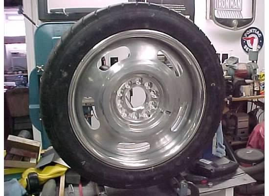

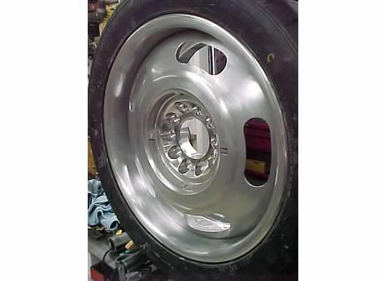

I worked on the rim today. Finished the sanding process. I took the whole wheel out to 2000 grit.

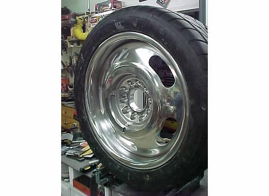

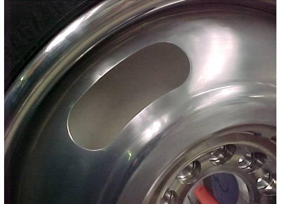

Once that was done I cleaned it up with mineral spirits and fired up the electric drill with a buffing cone in it. Loaded the cone with red rouge and gave the whole wheel a once over.
This is starting to look pretty tasty...

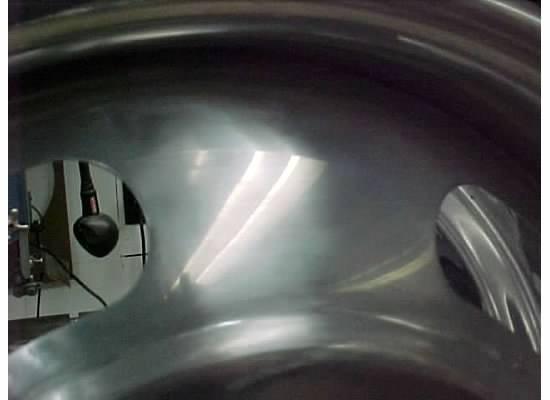

I again cleaned the wheel with mineral spirits and changed over to an unsewn buffing pad with the same red rouge to get down into the space between the rim and the center. This is quite deep... I also used the unsewn buff to really clean up the wheel bead.

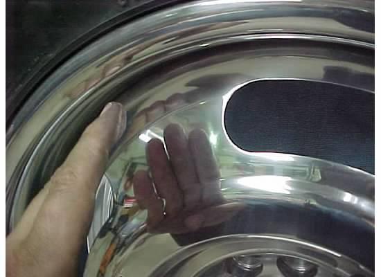

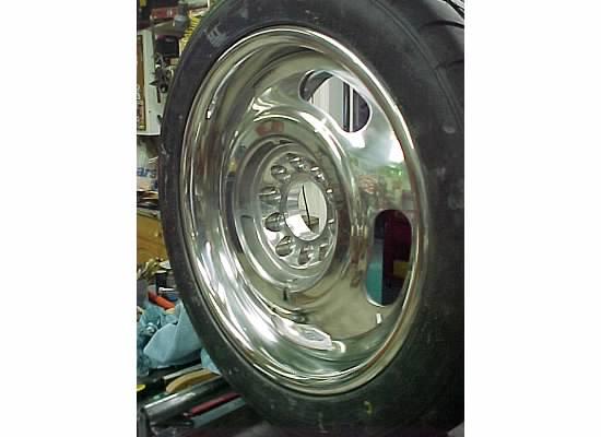

Once that was done I re-cleaned the wheel and swapped to a new unsewn buff and white rouge. After about 15 minutes this is what I have.
This is almost there.
It is still a bit swirly looking but that is where a couple of deep hand polishing's will finish it off.
I'll use Mother's Billet Polish first and finish up with White Diamond.
