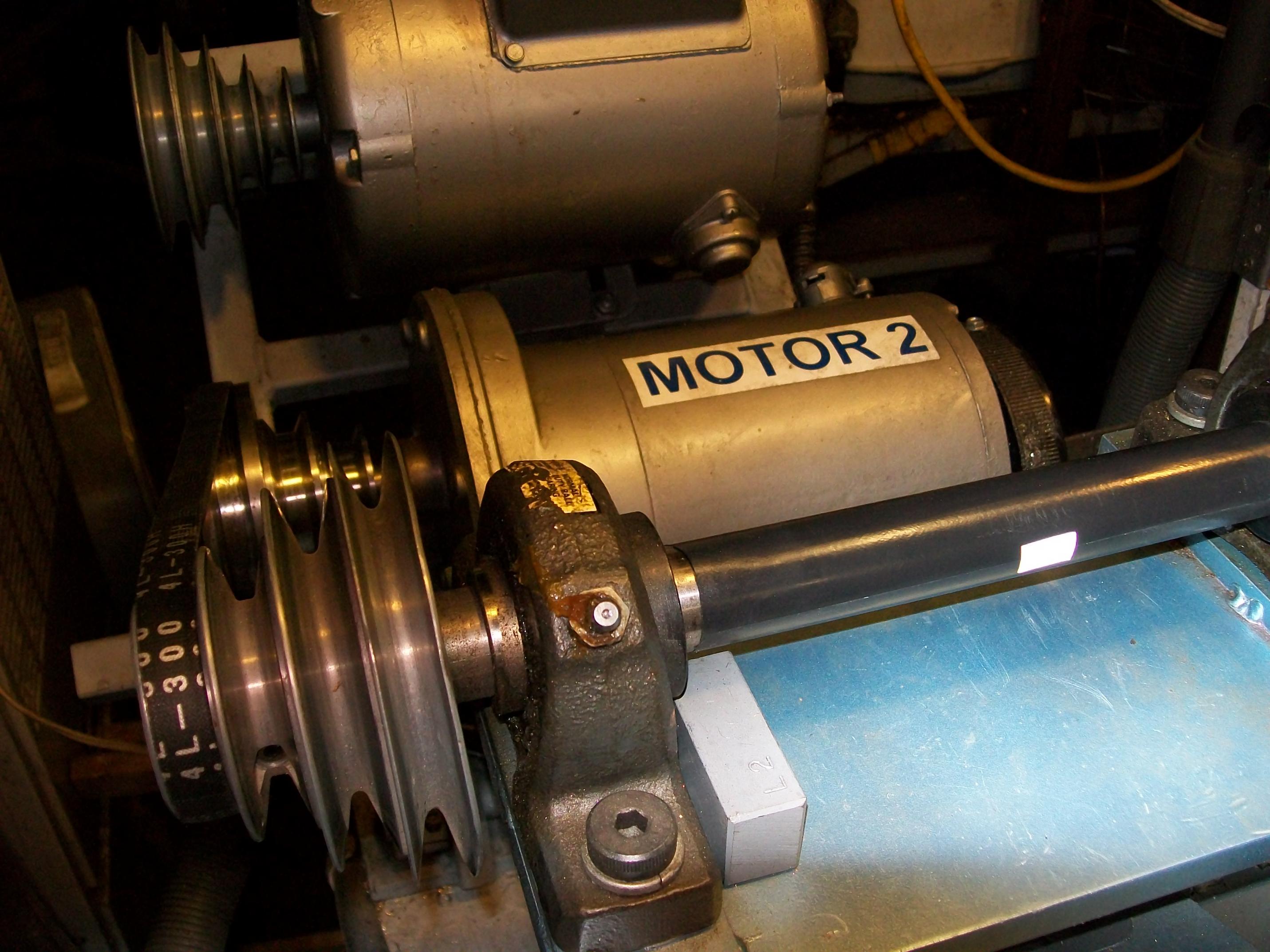

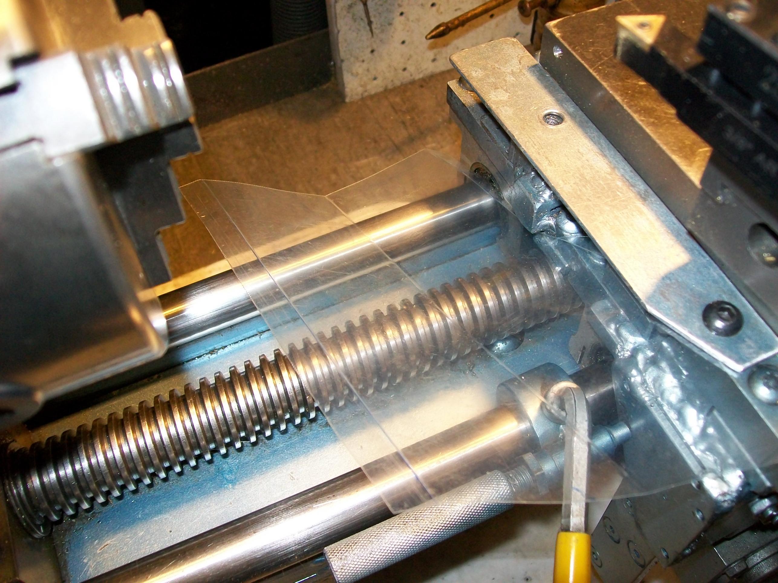

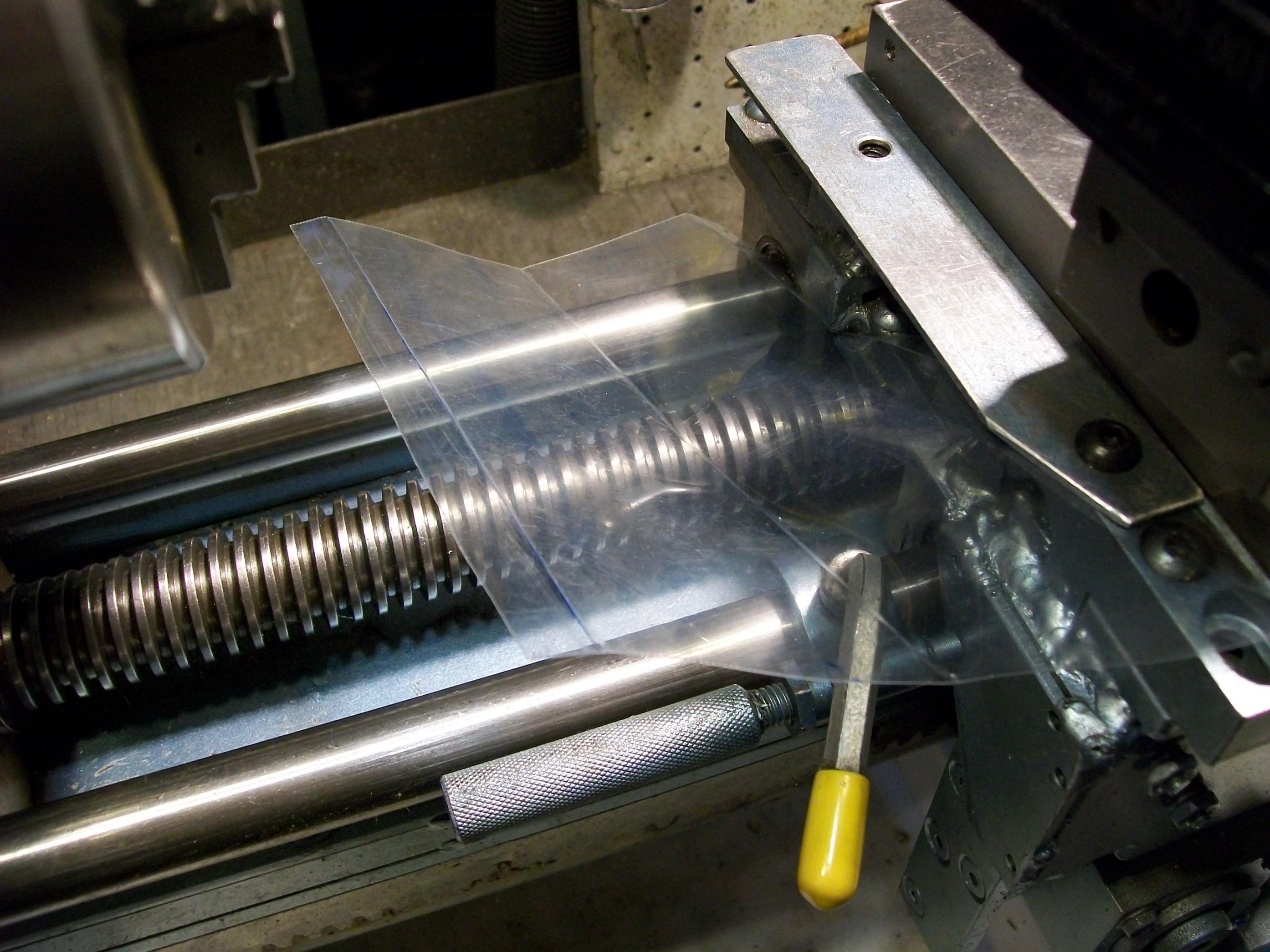

I notice some of the things, like what is the second motor for? the feed screw will fill up quick in it's location without protection. Also dod you get your tailstock and lathe chuck from a HF lathe?
Thanks all for your interest. This is actually the second lathe I have built. The first attempt worked, but had several shortcomings, that I corrected in my second build. I will go into a more detailed summary of this project soon. To answer some questions... The second motor was my answer to the problem of low RPM turning. I could not afford a VFD to run the main motor at low RPM's, and still retain the torque needed. I decided that a good gear motor should be able to do the job. I used a reversible, low RPM with plenty of torque, and accomplished what I needed. I need only to switch belts between motors, to switch from high to low RPM's. This lathe has no power feed, although I did consider it during the build. I opted not to add it at the time, But, I did leave the option open for the future. I've become accustomed to hand feeding, and have become quite good at it. Reverse is used primarily for threading. I use taps, and dies, along with a home made die holder. More details coming soon... Thanks again, keep checking in...

Hello all. I wanted to update my post, and add a few photos, before I continue with more project detail... For those of you that noticed the location of the lead screw, and thought it would be problematic, I considered that early on in the project. Because I wanted the action of lateral feeding to be as smooth, and friction free as possible, I decided to keep the lead screw centered between the bearings on the cross slide saddle. All I had to do was to come up with a way to keep screw clean, at least clean enough to prevent having to stop, and clean it during a project. The photos show what I use... Just a simple plastic deflector/ guard to redirect the chips/swarf. It's kind of difficult to see in the pix, but it works great. I can say in all honesty, that I have not had to stop mid project/operation, to clean the lead screw, EVER. By the way... the manual feed is ultra smooth, with no discernible resistance at all. I am very happy with my decision for the lead screw location.

Motor 1
3/4 H.P. 1725 RPM
115V 10.4A
Continuous duty Spindle speeds: 875 1350 2250 3450
Motor 2
1/4 H.P. 30 RPM
115V 4.6A Cont. duty
Ratio: - 58:1
Torque 400 IN. LB. Spindle speeds 24 36 58
