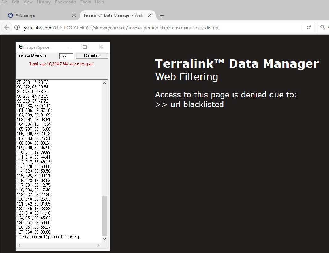

    SuperSpacer and Youtube
    Screenshot of SuperSpacer program and a reason why I am not watching any video clips at youtube.
    Regards
    LMMasterMariner

    The ROTARY program, free from my site, will do the same thing and won't be blacklisted.
