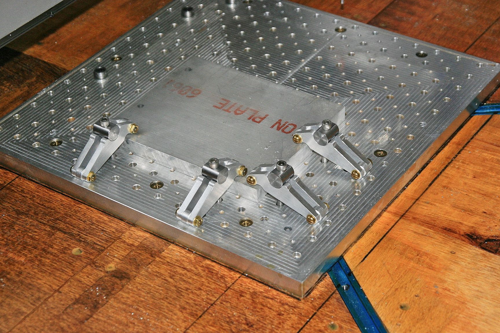

MILLING TABLE or FIXTURE PLATE CLAMPS
I have made a number of these neat little clamps for my various projects over the years. I cannot take credit for the design as I copied it from an internet source but I no longer have a link for the original. Apart from the side profiles which are CNC cut on my milling machine all other parts are produced on manual machines. Making a few sets in a relaxing afternoon in the workshop! Review the pics and maybe view my short youtube video on cnc'ing the sides.
Gerald
https://www.youtube.com/watch?v=a8UWA2LWW4Q
