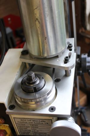

1 Attachment(s)
Thought you might like to see my simple belt drive conversion for the mini mill
Attachment 18553
The conversion is quite simple: Mini Mill Belt Drive – glue-it.com
Thanks for the info on the belt conversion, I have that also. It turned out it was the controller board that was the cause and I had to get a new one. I am going to try and see if I can get some one close to home to repair the old one. Thanks
