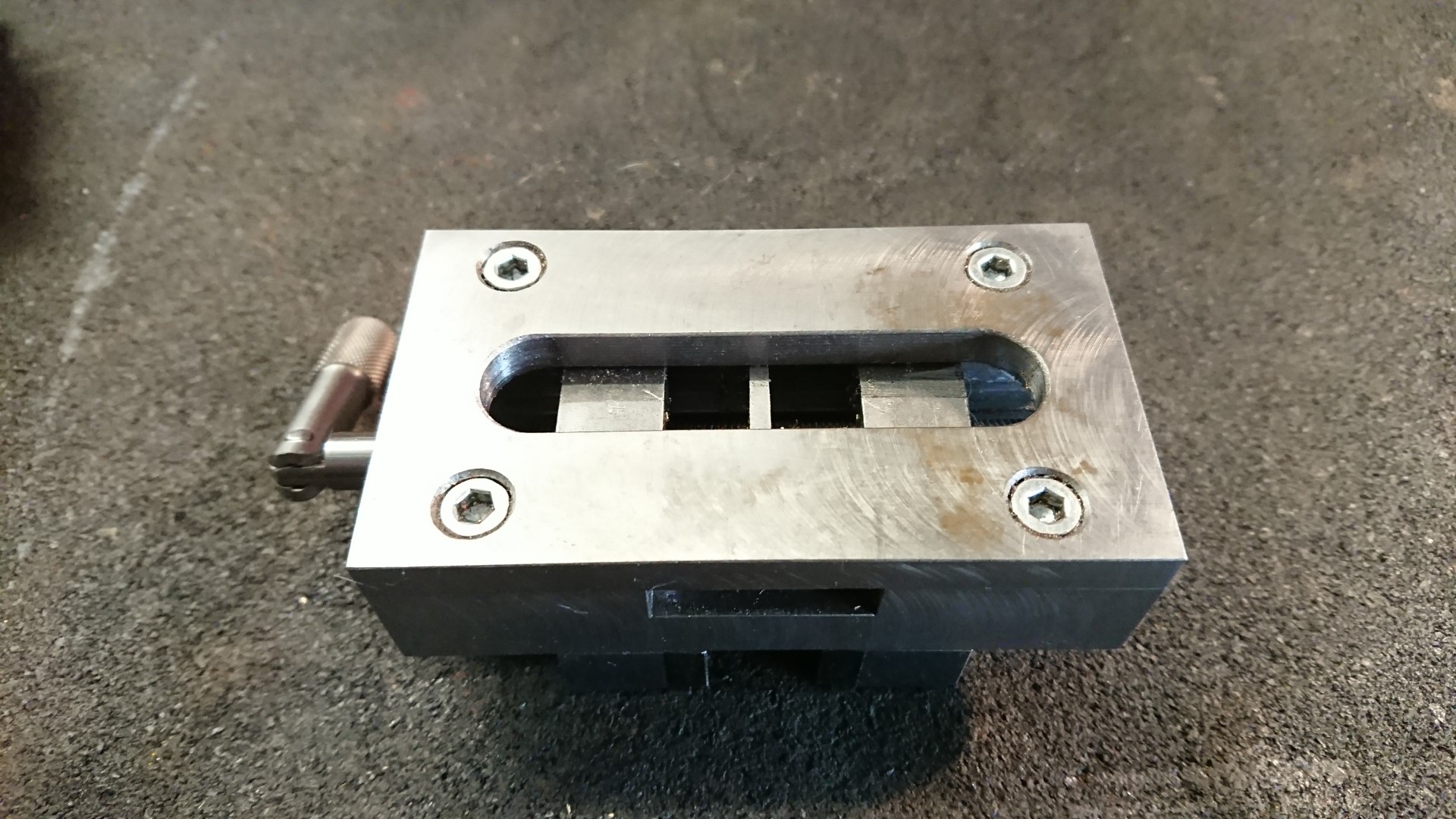

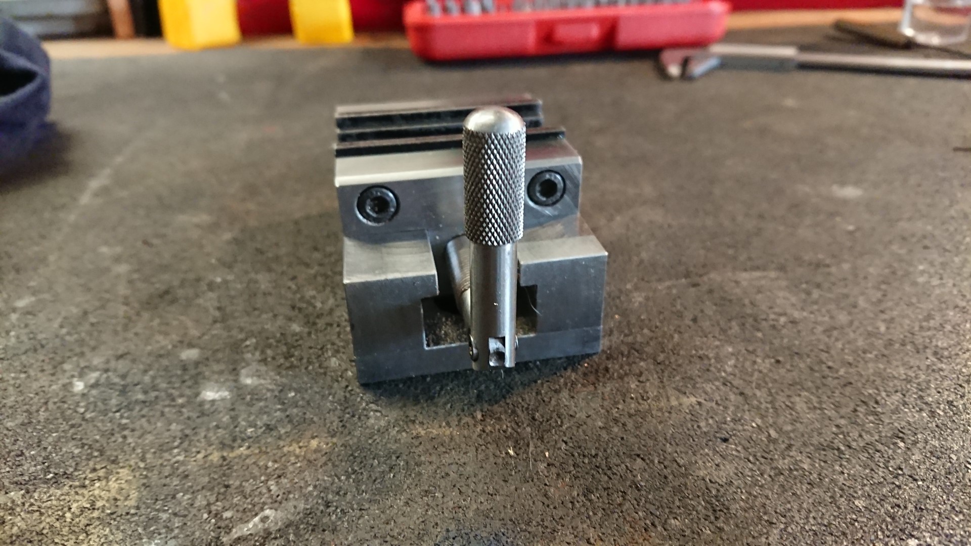

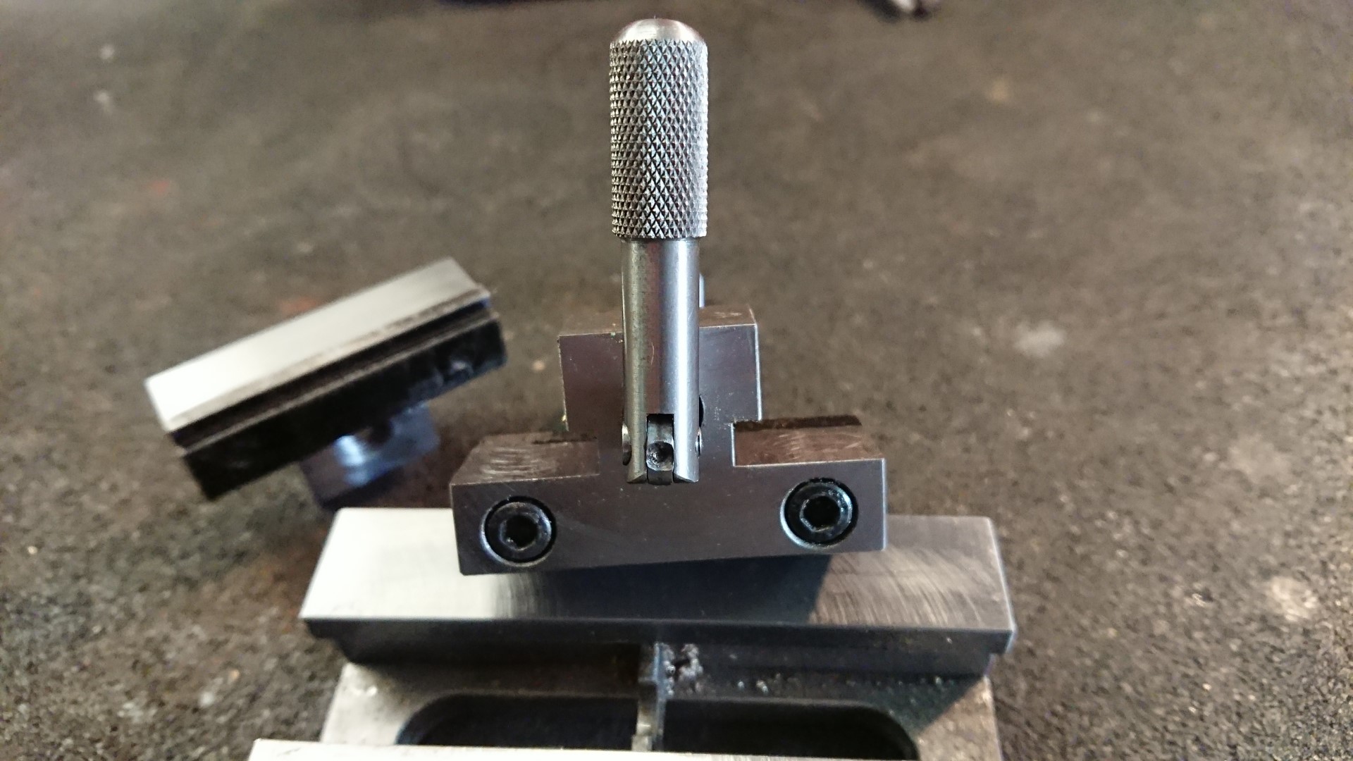

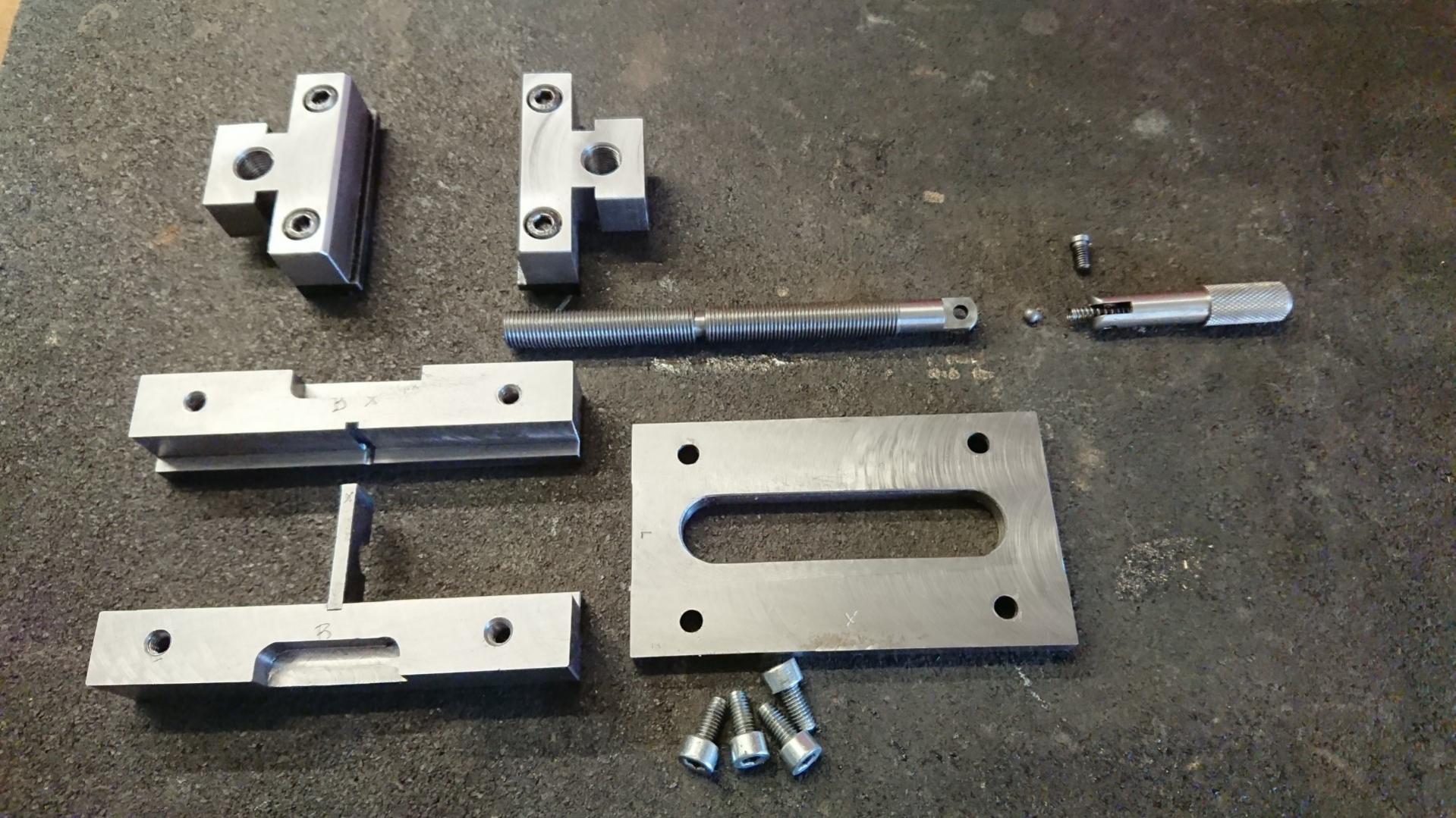

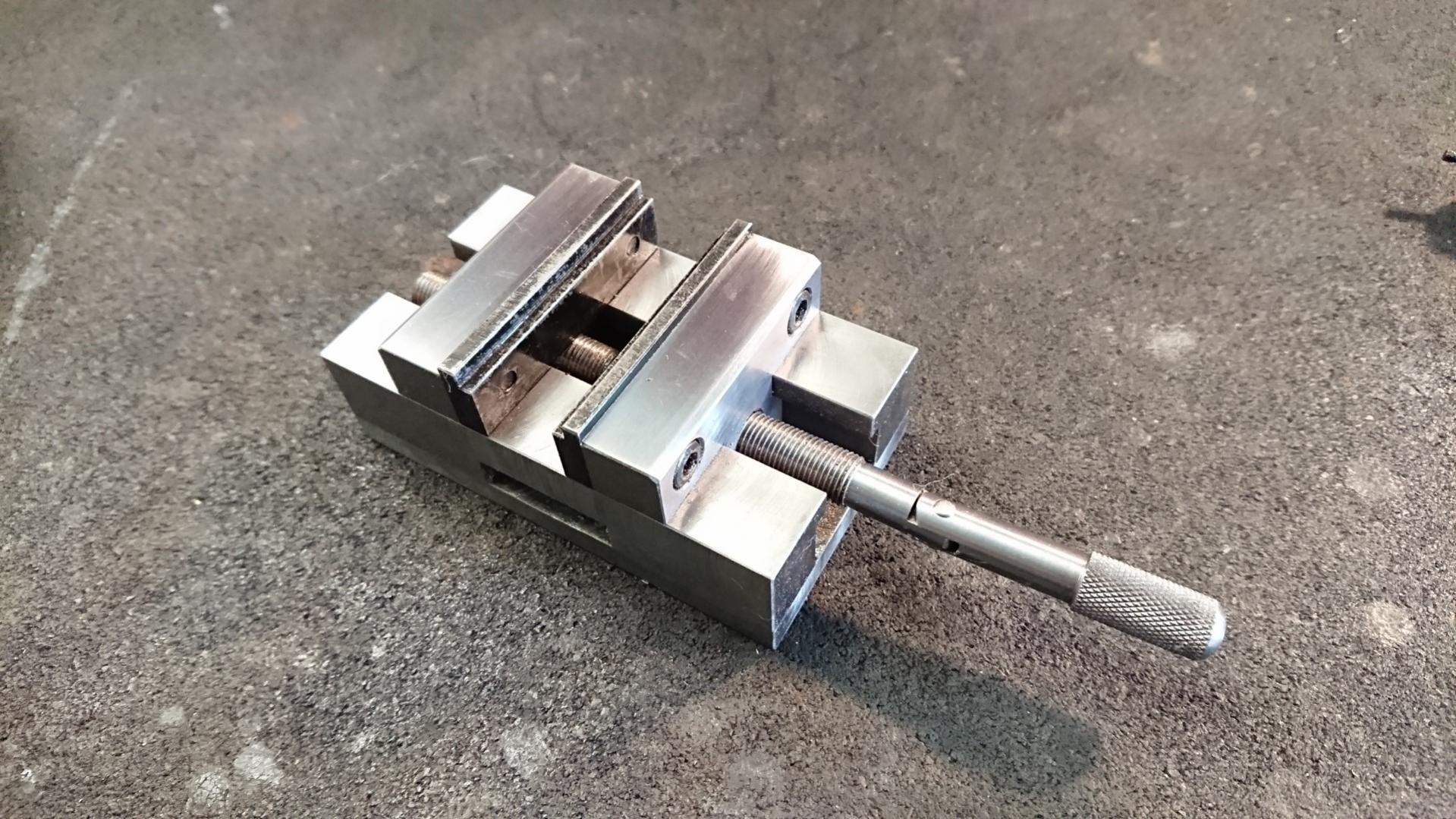

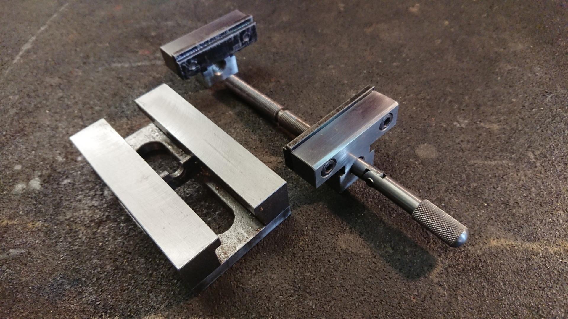

hey fellow creators,
Thought I'd share one of my favorite tools. this little baby is used often, it locks like superglue and the step in the jaws saves scrounging for
levels, easy to square on the mill.
overall length:97mm
width:55mm
height:43mm
thread 10mm left and right of course
base:8mm mild
side channels:16mm mild
jaws:1/4" O1 tool steel heat treated to 55 Rockwell
Attachment 24446
Attachment 24447
Attachment 24448
Attachment 24449
Attachment 24450
The handle has a spring with a ball bearing inside to hold handle in upright or level position, note dimple in small part of handle.
The base I opted to attach with screws rather than gouge out to be able to adjust the clearance.
