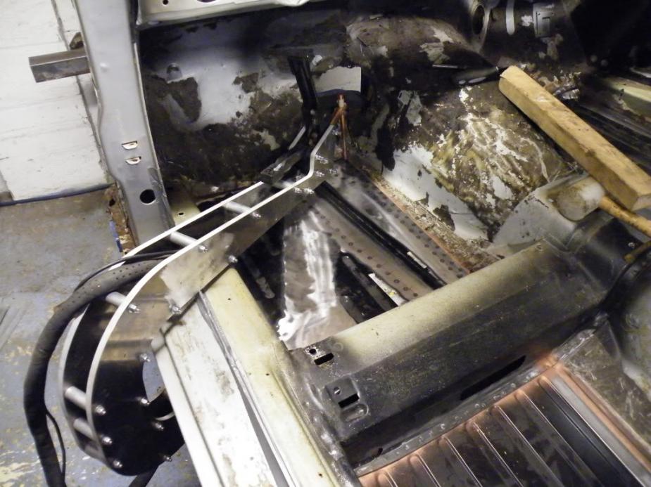

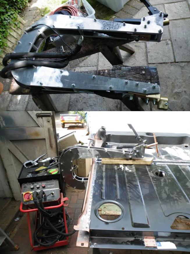

A lot of those homemade spot welders on the web ,using microwave transformers seem a bit small to me and probably only have a short duty cycle. attached are some pics of spot welder extention a mate in England made some years ago. perfect for restoring mercedes floors to the factory appearance and lot easier than endless hours of mig plug welding .
Attachment 583Attachment 584
