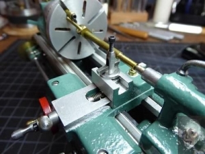

    Ok, this is a bit of a joke but it took as long to make as if it were a practical size. It's a functional lantern tool post complete with rocker and bit ground with the proper angles to cut threads.
    It was made to fit on my working dollhouse scale (1/12) metal lathe, made from a casting set obtained from PM Research. This picture shows it in place on the cross slide.

    Really nice miniature machining work on the tools. What is the thread size of the clamping screw on the lantern tool post? Looks extremely small. Thanks for posting,

    The screw is a 0-80 SHCS - not easy to find those, or the wrenches to fit them.
    I can remember when I started building miniatures that a 2-56 thread looked impossibly small; I'd never be able to tap that without breaking the tap. But, the longer you work in miniatures, the bigger this stuff seems to become. With the proper (homemade) tooling, 1-72 and 0-80 are perfectly doable. To date, the smallest I've done is 00-90. I have a tap for 000-120 but, thankfully, a situation requiring that has never arisen.
