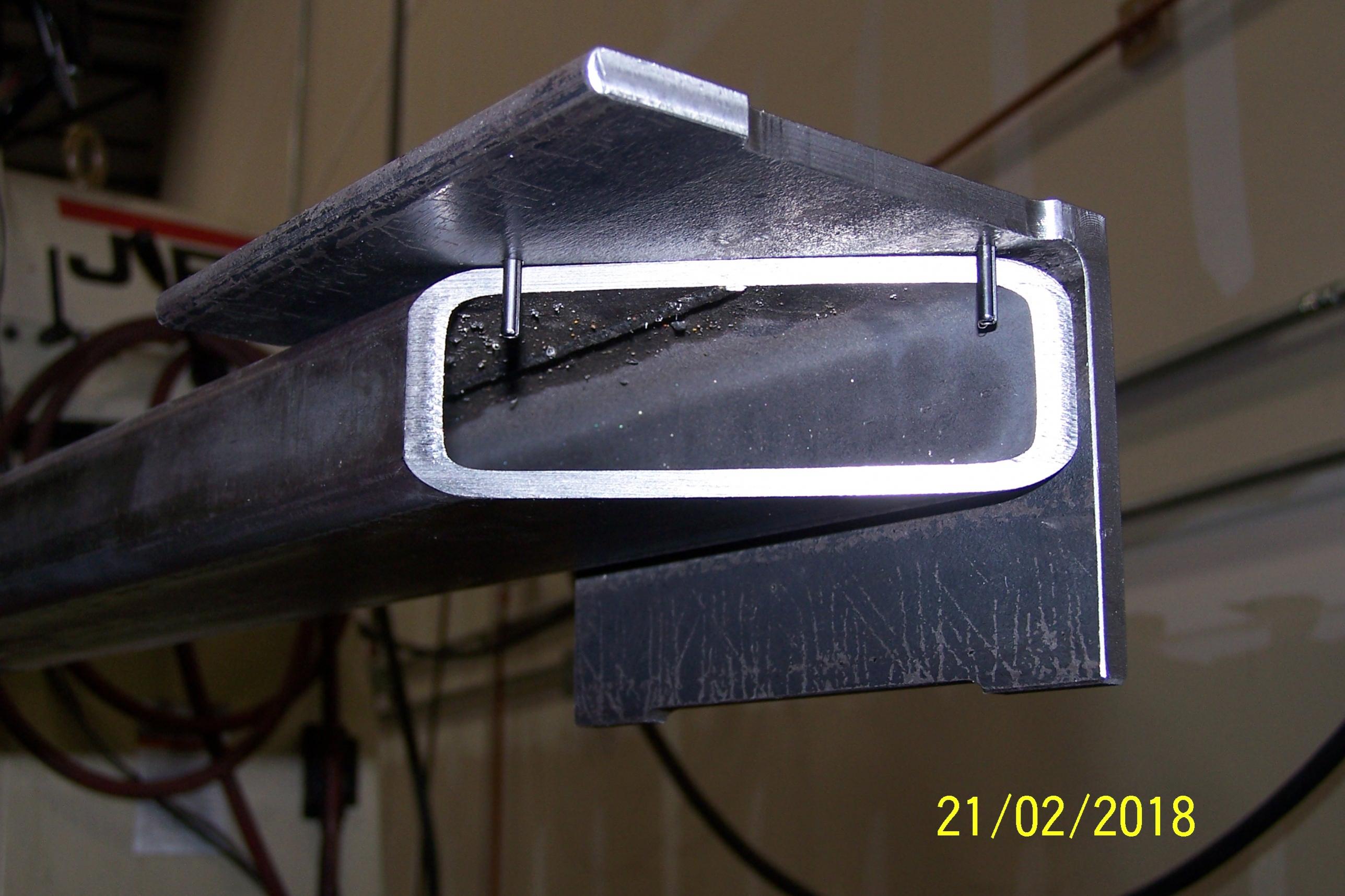

Before Attachment 22363 After Attachment 22364

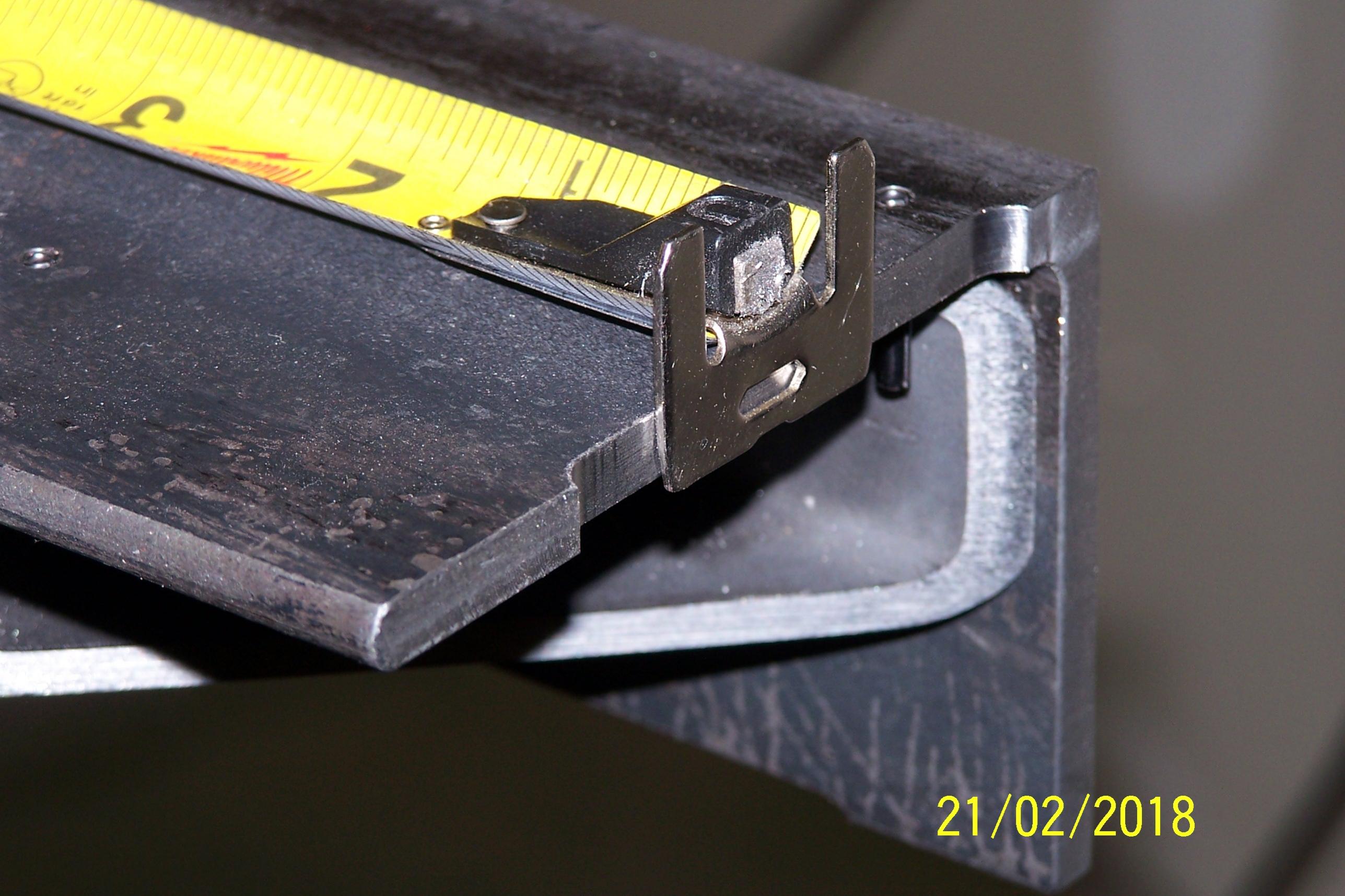

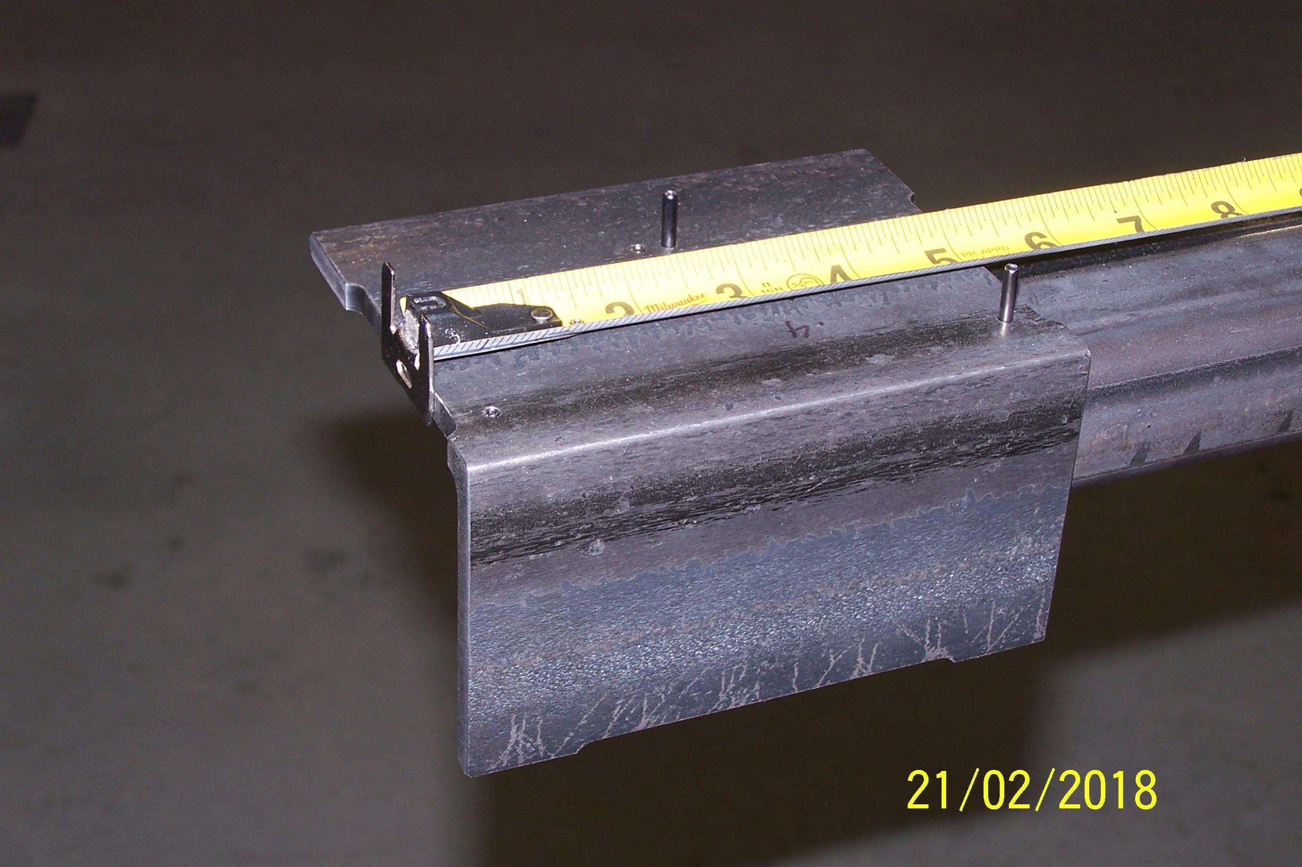

2 sets [right and left] of roll pins are positioned tangent to angle at cut edge of tube, 1 touches on narrower stock. Few holes go all the way through, so that justifies right or left configuration. Just push one set of pins down into place. Sawcuts need to be checked for burrs. Attachment 22365

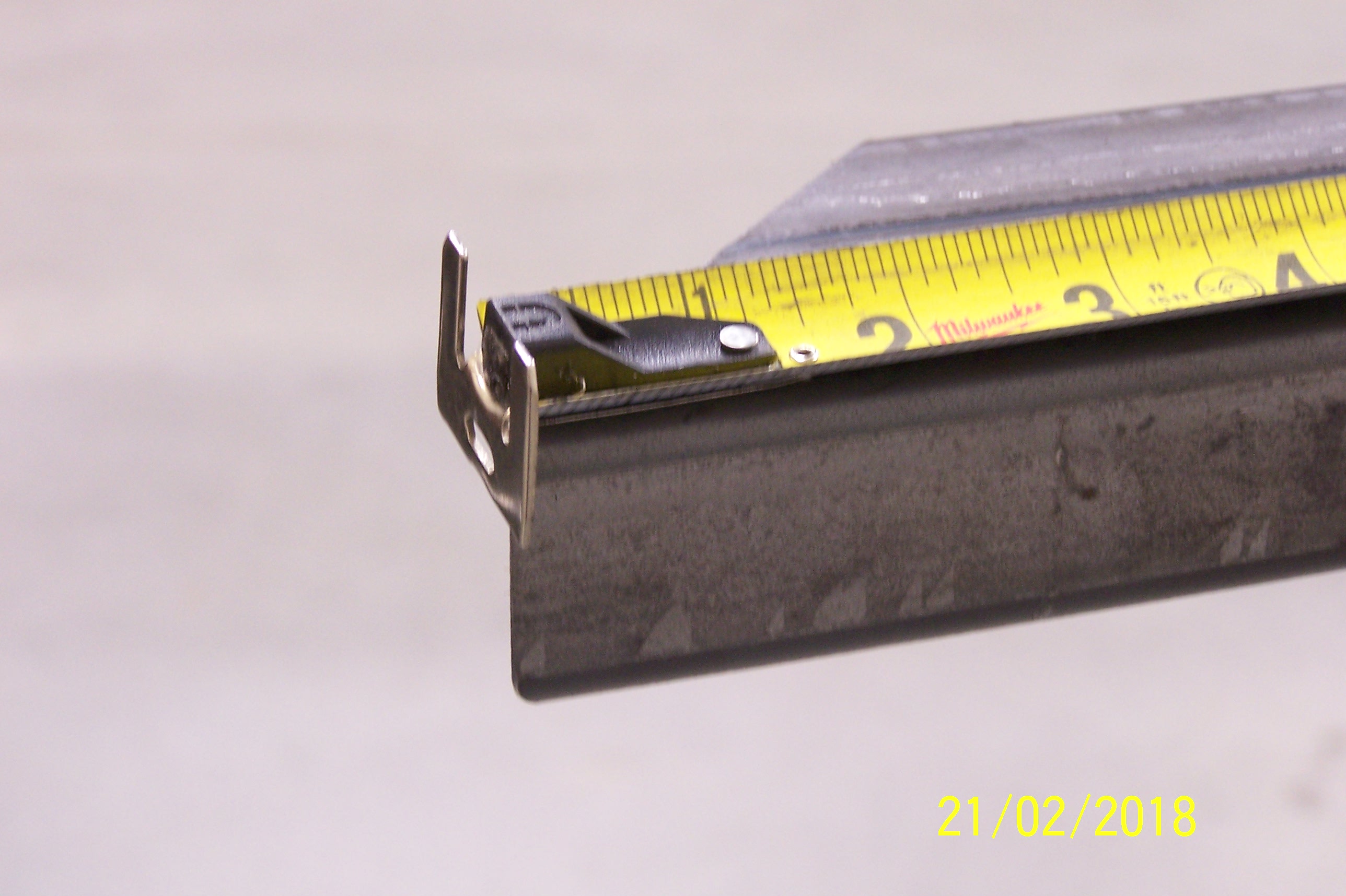

The cutaway precisely represents end of miter point, to correctly locate tape hook in same plane. Attachment 22366
What look like feet on lower edge of angle stock, are. Took some prep work to get hot-rolled material into acceptable conditions of flat and square in 3 axis, yet preserve hard scale on raw stock.
I laid out pin locations originally to the milled outside edge, before drilling decided otherwise.
In use, a small bar clamp holds it in place. Thought about magnets, but swarf isn't a decent reference surface yet.
