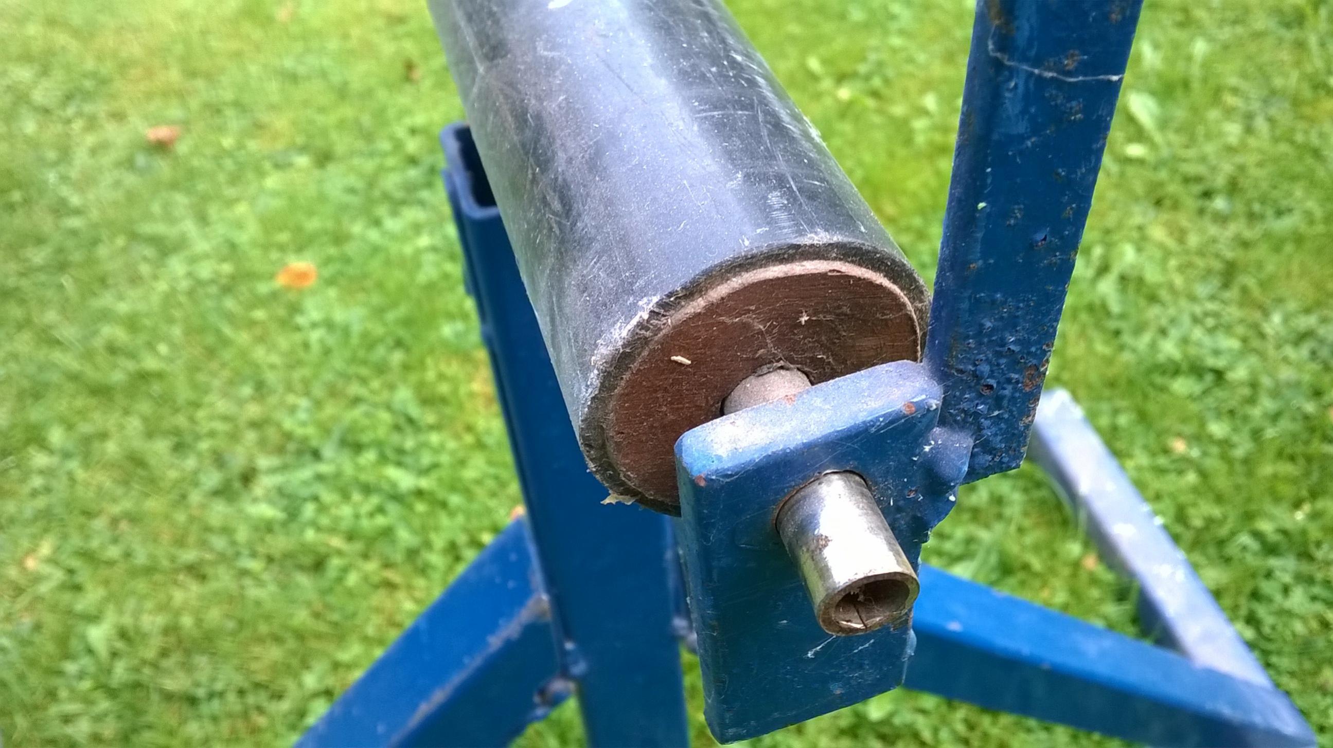

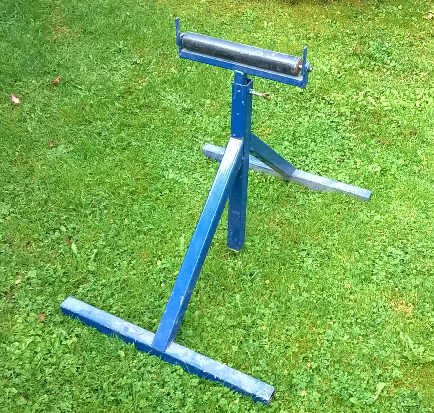

I put this mitre (miter) saw stand together from some scraps lying about. 1 1/2 inch box section was used for the legs and vertical parts, T hinges for pivoting and a piece of waste pipe for the roller. I used some pieces of old teak windows cut out with a hole saw to hold the axle. The axle itself was a rod from an old shoe stand.
Attachment 4132
Attachment 4133
