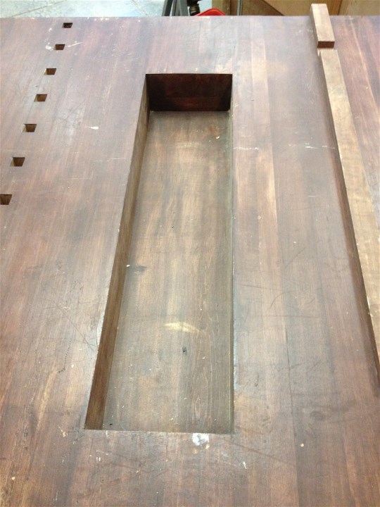

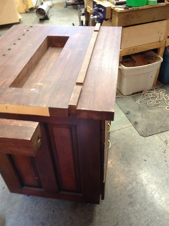

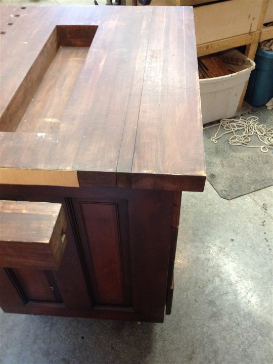

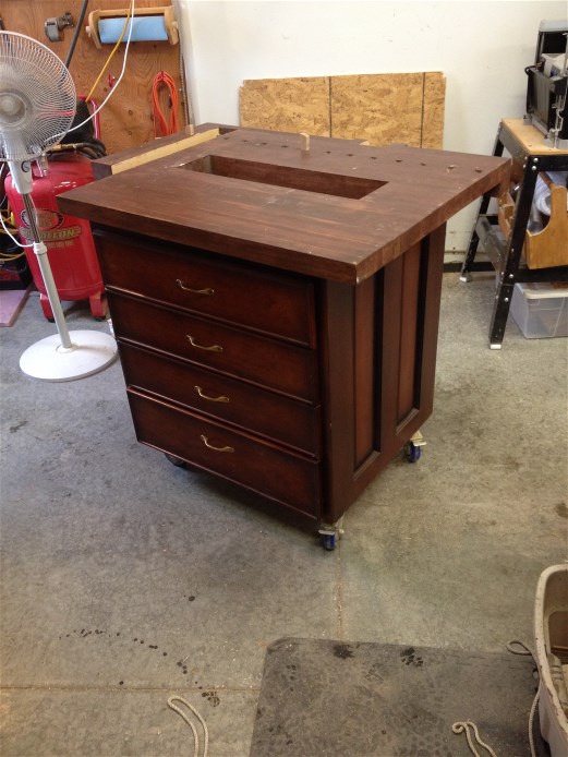

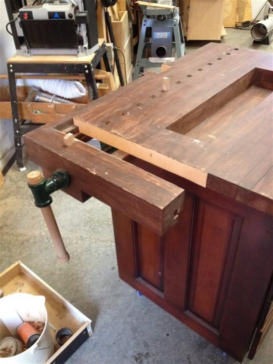

I made this last year after I found I needed work space for assembly and for holding pieces.
The bench has a 2" thick solid laminated maple top with 1 line of square dawg holes, a 4" deep tool well and a removable / reversible butt stop. I added a double vise with a large opening at the end and a smaller one (advanced by the same screw) on the side.
The cabinet portion has 4 large full extension drawers and I keep most of my finer tools / router and planes in each drawer.

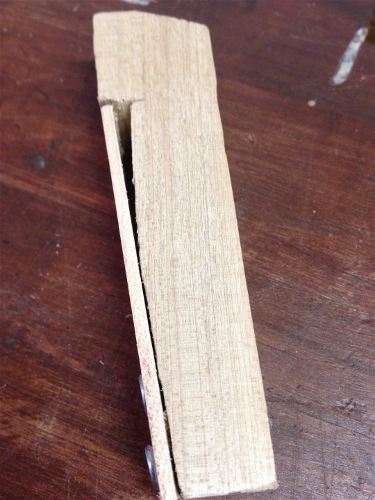

I custom made a number of square dawgs.
This is one of my most treasured pieces in my small shop. By the way if anyone has noticed a trend, it too is the height of the bench, tablesaw and other tool stands so it can be wheeled over in position to serve as an accessory table surface.
Attachment 2637Attachment 2638Attachment 2639Attachment 2640Attachment 2641Attachment 2642
