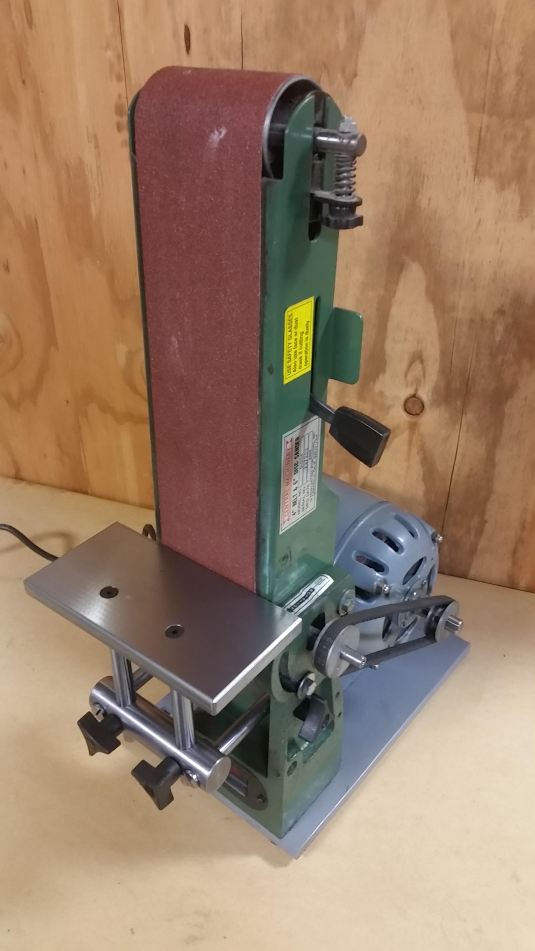

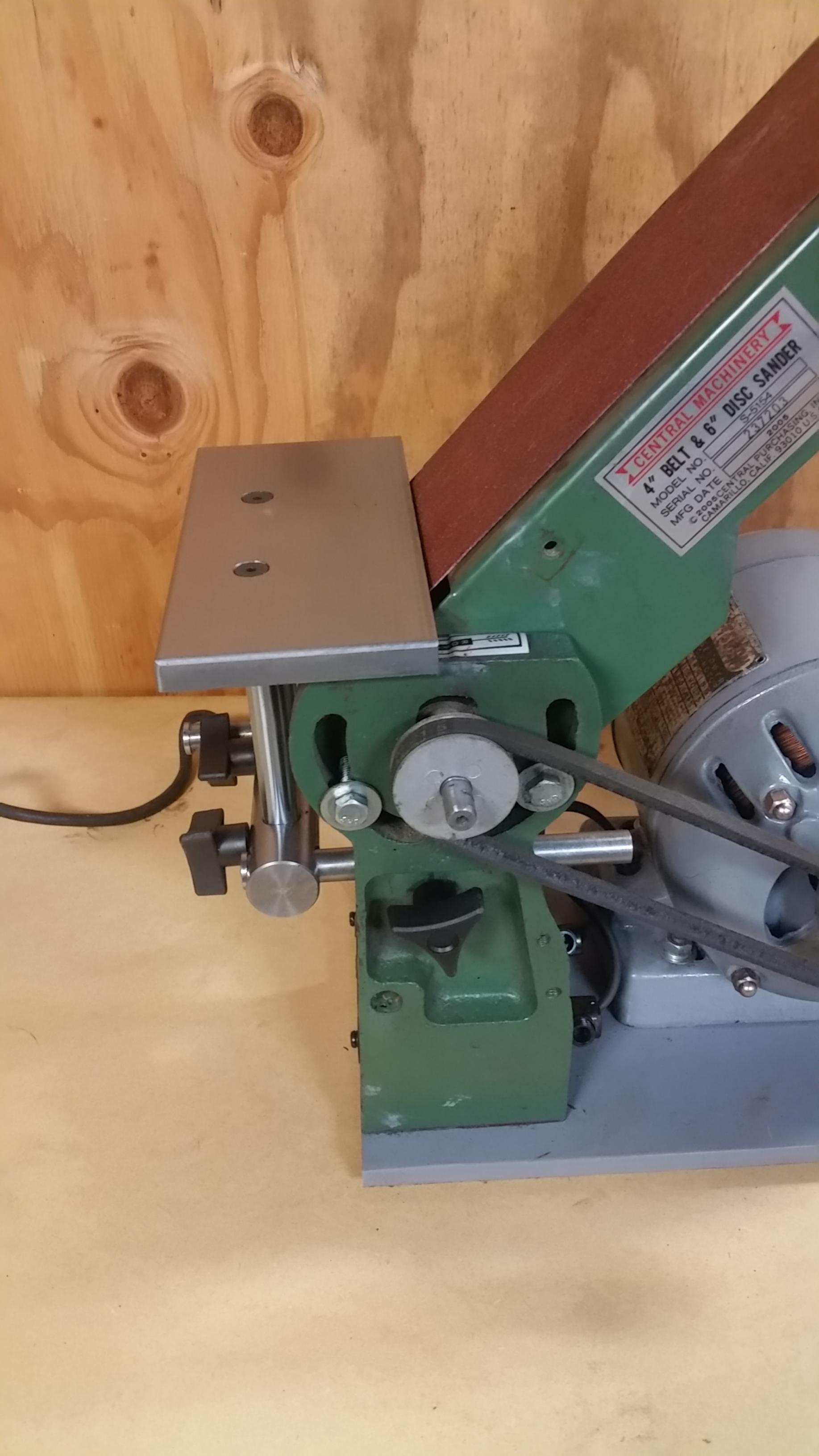

    I've owned this cheap Harbor Freight belt sander for 10 years, and it has always been under powered and slow. So, I replaced the 1/2 h.p. 1725 rpm motor with a 3/4 h.p. Craftsman 3450 rpm unit, and while I was working on it, decided to make a better fence (or table?)
    Simple, adjustable and easy to make from stock laying around my shop. Mod to cheap 4"x36" belt sander-20161129_164948.jpgMod to cheap 4"x36" belt sander-20161129_165107.jpgMod to cheap 4"x36" belt sander-20161129_165149.jpg This thing now has plenty of power and is quick to remove material.

    I made exactly those same mods to my identical sander. Larger motor and better fence.
    My attitude to much of the stuff from the orient is to regard it as a kit of parts only assembled with chewing gum screws to keep it together for transport. Dismantling, sometimes remachining, cleaning and reassembly with real fasteners should all be regarded as part of the buying experience. Bought with that viewpoint there is often little to complain about.

    I purchased the HFT 6"Disc/4"belt sander similar to this sander. You are 100% correct in that it is underpowered and the table on this machine is horrible. Changing the belt sander belt takes a solid 45 minutes and everything on the disc sander has to be re-squared. It was so frustrating to use the disc sander, I recently purchased a larger 12" Disc Sander and have relegated the HFT sander to my "rarely used" tools. Seeing this modification, I may get it back out and modify it. I have a spare 3450 1hp motor so if the speed isn't too bad, I may make at least this change. Thank you for the idea.

    You are most welcome, and thanks for the kind words. I've used this upgraded sander now for over a year and it is much improved. More power & speed, and the ability to be more stable and accurate is also a plus. Also, it doesn't try to wander around on the bench since I added that 1/2" thick steel plate under it.

    1/2" plate lol. At 20 pounds per square foot, that'll hold most anything down.....even when they aren't well balanced.
