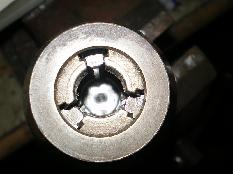

    You say it is a keyless chuck, does it look like this inside at the bottom, if it does you are seeing the end of the arbor which you may be able to press or drift out.
    A picture of your chuck type would help.

    As I understand it you have a chuck with a male taper protruding from the top end. It has been removed from the drill press and the taper appears to be bent. Look inside the chuck as in Olderdans picture and you might also see a screw head. Remove that screw and you should be able to tap the chuck off, or punch it out as advised by Olderdan. Before you manufacture anything new I would suggest that you inspect and clean, remove burrs etc, from both of the tapers and also the female taper in the drill press. Sometimes they can be poorly assembled and appear bent but when cleaned up they run true again. You should also check the jaws of the chuck for burrs or scoring caused by slippage and remove any defects.

    The picture I posted was of a precision keyless chuck in my case an ALBRECHT but other brands will be the same fitting.
    If you do see a screw at the bottom the chuck will likely be from a reversing power tool, the screw will be a left hand thread and is there to prevent the chuck from UNSCREWING from the arbor, the head of this screw will almost certainly need drilling off, my tip is to use a piece of tube in the chuck to protect the jaws and the drill bit while doing so. I have never seen a chuck of this type fitted to a No 3 Morse taper arbor but with second hand machinery anything is possible. On that note I have seen arbors that have been bent as they are case hardened only.
