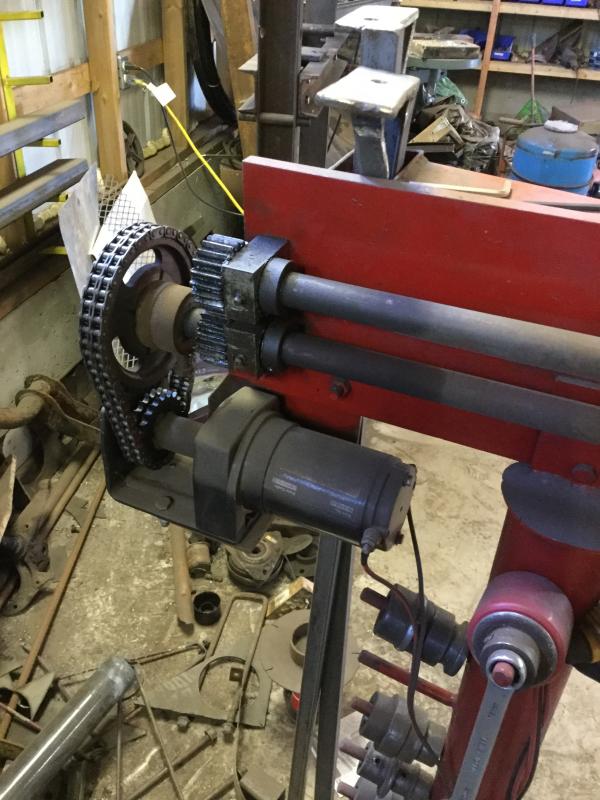

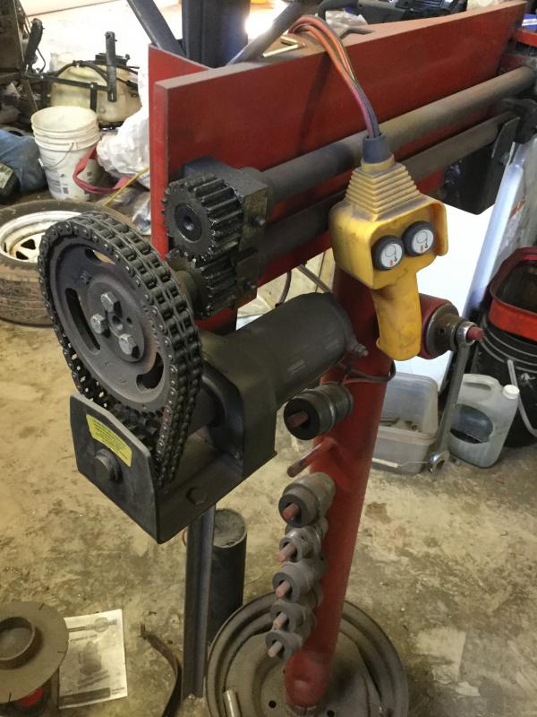

Originally Posted by
wizard69
I don't have a bead roller yet but you are left with two alternatives build a speed reduction transmission (retrofit) or buy one new. Buying new of course is a challenge $$$$ wise. As for DIY you want a sizable speed reduction to get the required torque, otherwise you need a huge motor. The speed reduction can come from a gear box or a cobbled together belt reduction. At some point a more positive chain drive is probably cheaper and more reliable in the lower speed stages.
Variable speed and instant reversing are very useful too. This is more about motor control though.
