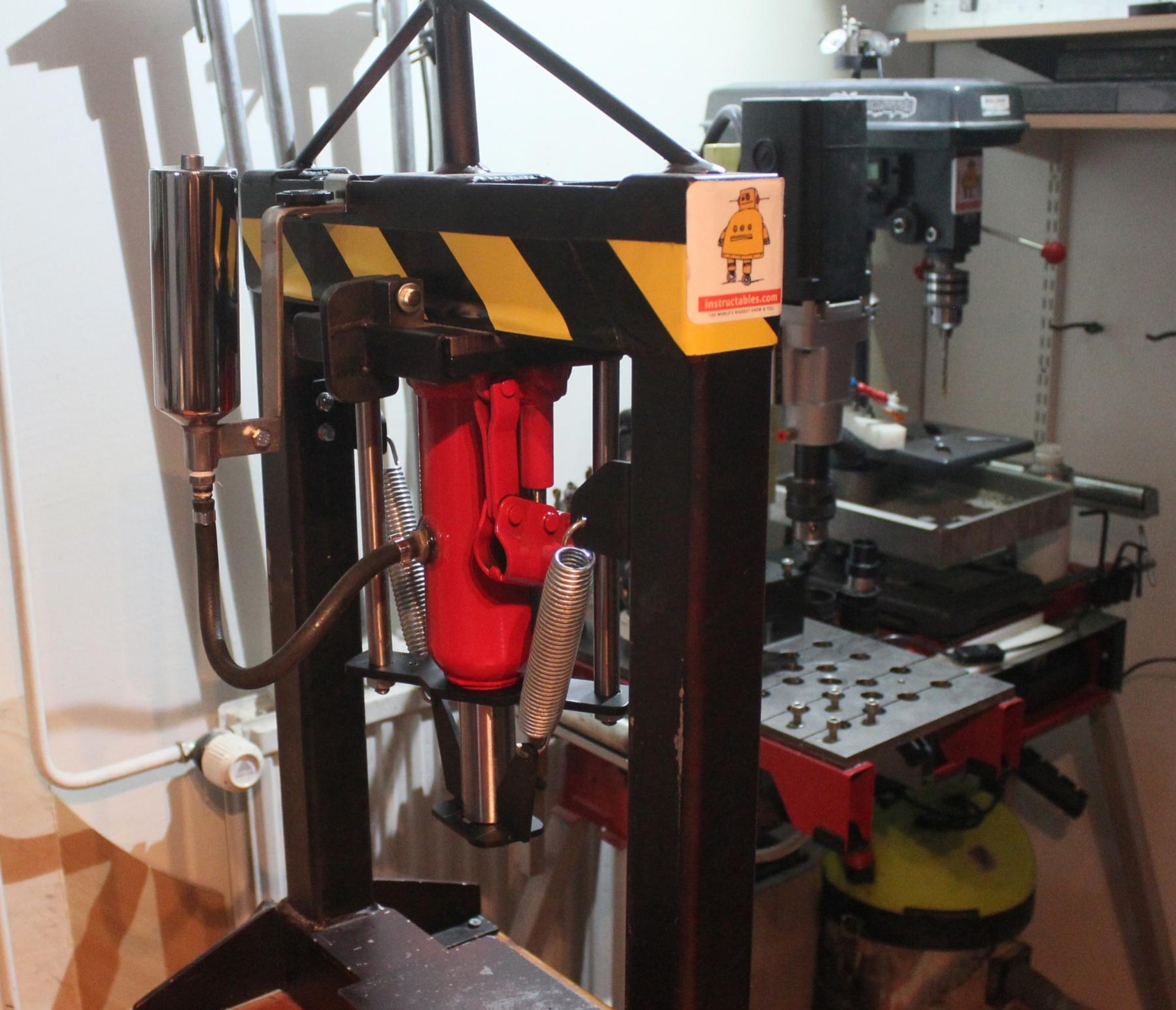

    Wanted to add bigger jack to my press.
    To get most of the pressure to the small area, i decided to turn the jack upside down.
    This way i can mount hole punching and stamping dies directly to the cylinder of the jack.
    In use:
    Attachment 23111
    Stored:
    Attachment 23110
    Takes about 10 seconds to assemble / disassemble.
    Springs are surplus from trampoline. Bigger holes drilled with a variable wood cutter, with diy hss blade.
    Used cheap 8 ton jack that was sealed with welds.
    Actually this should work with "any" jack, without need to open it.

    Picture shows how springs goes between the rods that hold the jack

    I can use same dies with both jacks.. when i need to bend thicker materials i use bigger jack..
    With thinner ( <5mm ) i use smaller one, wich is more accurate and faster to use.

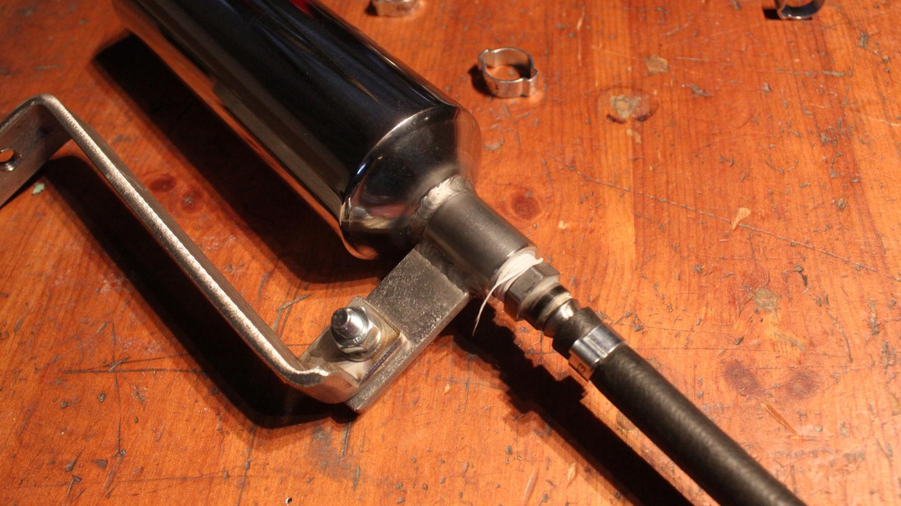

    Edit:
    New container:

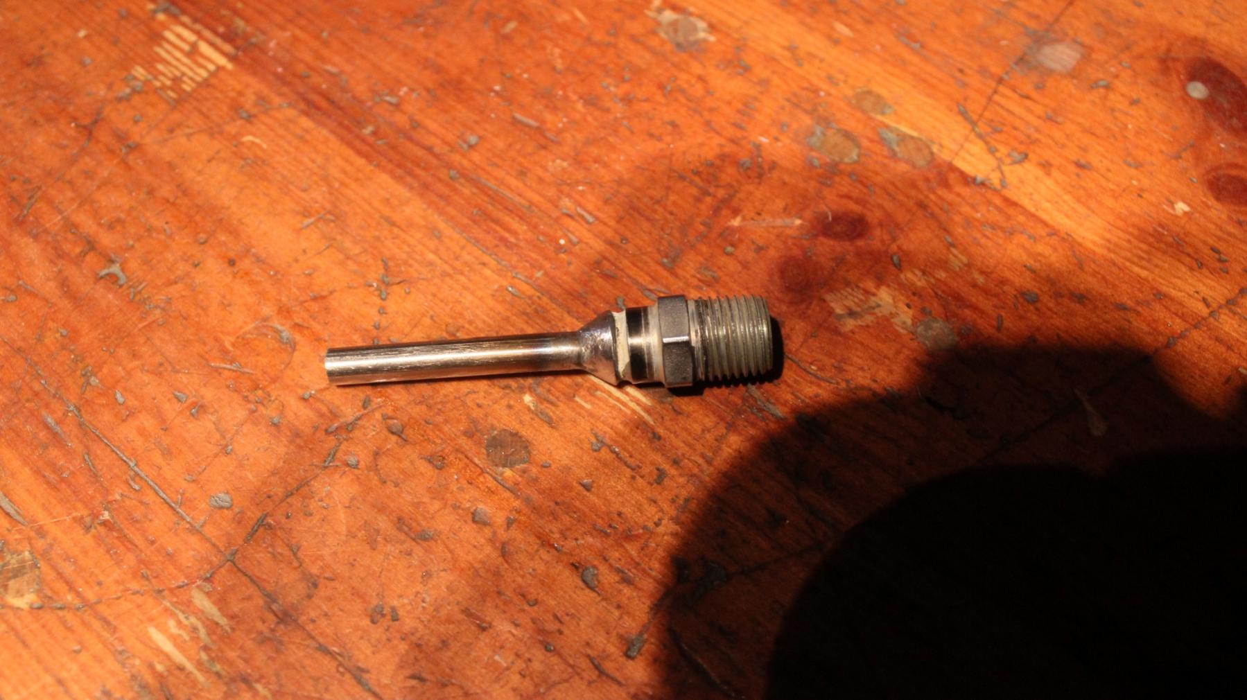

    Fitting. Didn't find suitable, so i made it from bigger one, cut the end out and welded piece of 6mm ( hose is with 6mm inner dia ) thick pipe to it.
    Connections..
    Cap is made from a bolt. I filed groove to it, it allows container to breathe.
    Open..
    Closed.. When stored, so it doesn't leak if it falls.
    Easy to fill..
    Ready.
    I used this hose in that first version. Now i changed it to appropriate one...
    But at that time, i had any hose and stores we're closed. So, i improvised.
    I peeled it from electric cable. It worked nicely that time i used it, but i decided to change it before it breaks.

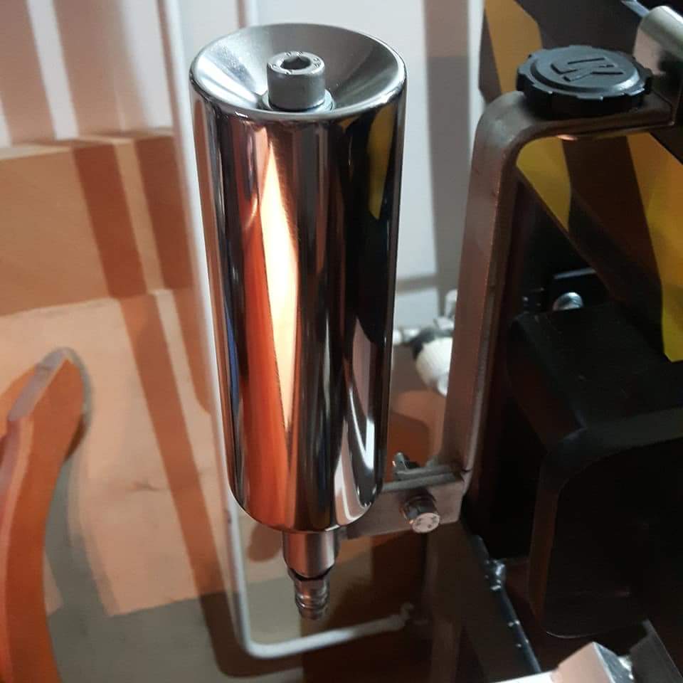

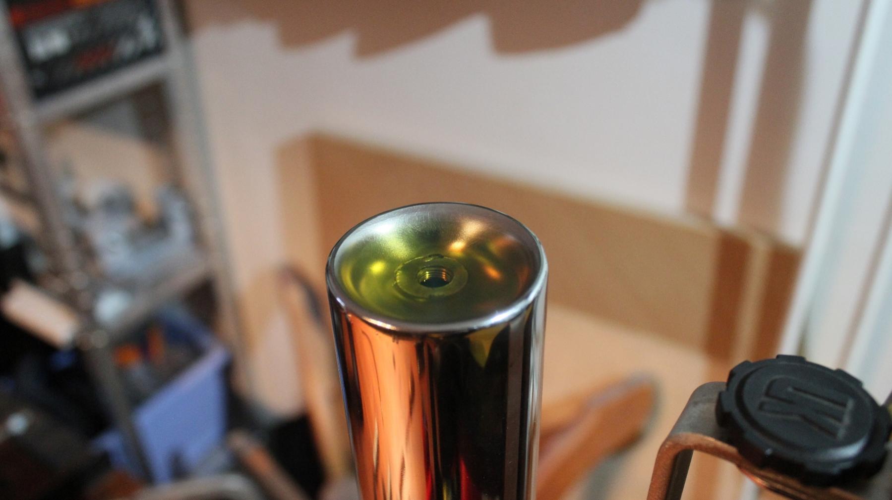

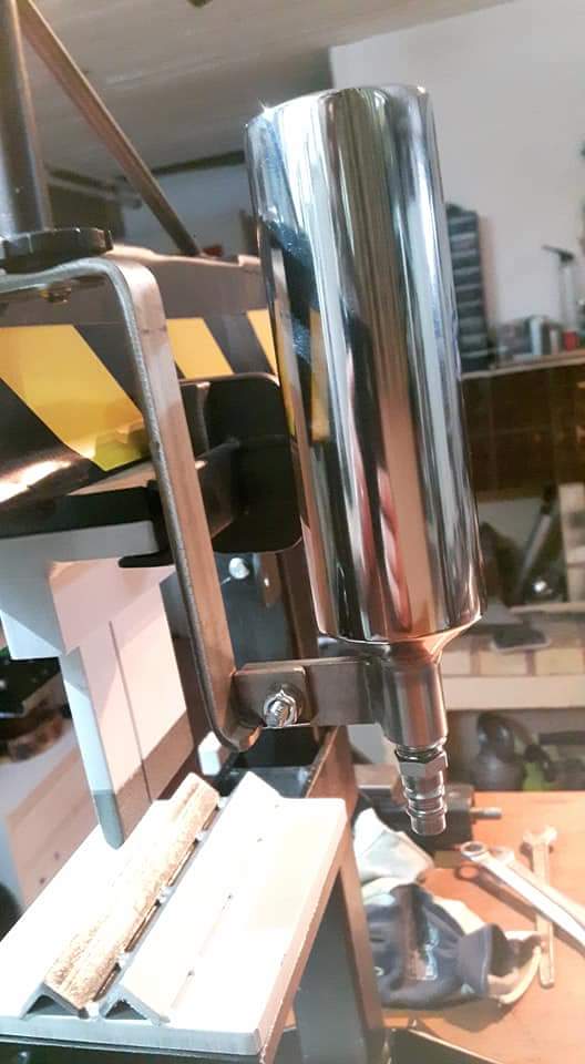

    New oil container. Made from stainless steel.
    Mount for the hydraulic jack.. Turning it upside down.-fb_img_1523889446431.jpg
    Mount for the hydraulic jack.. Turning it upside down.-fb_img_1523889455593.jpg

    Couple more pictures

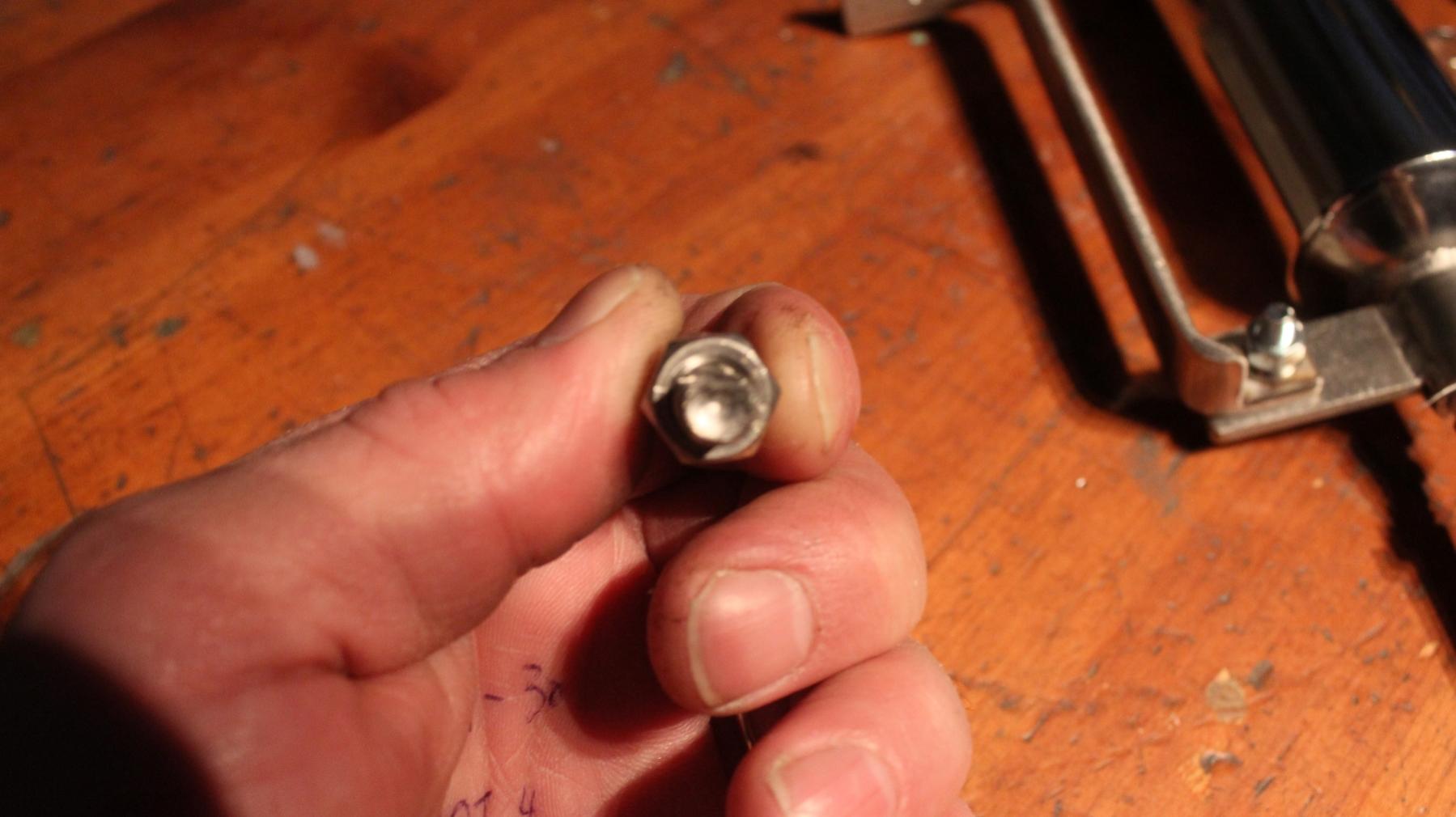

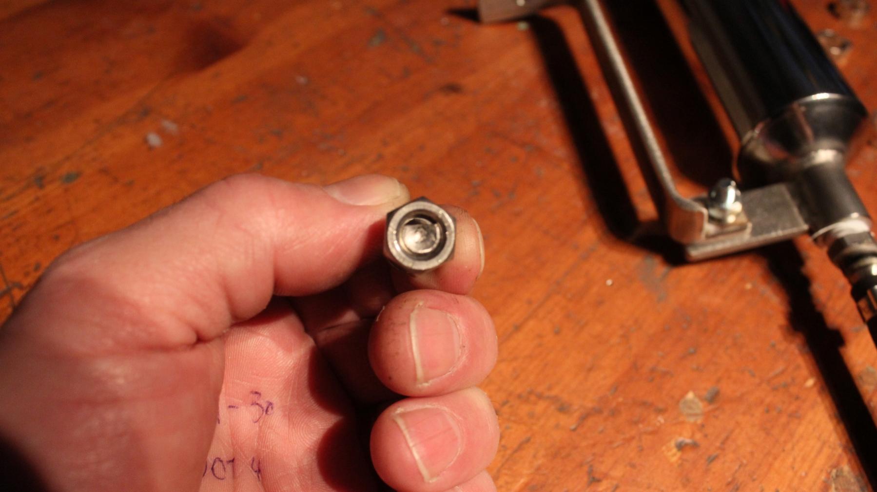

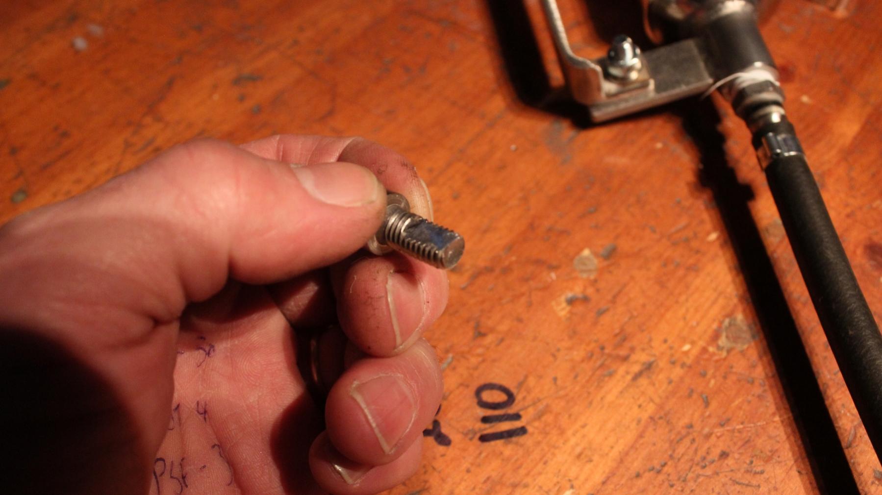

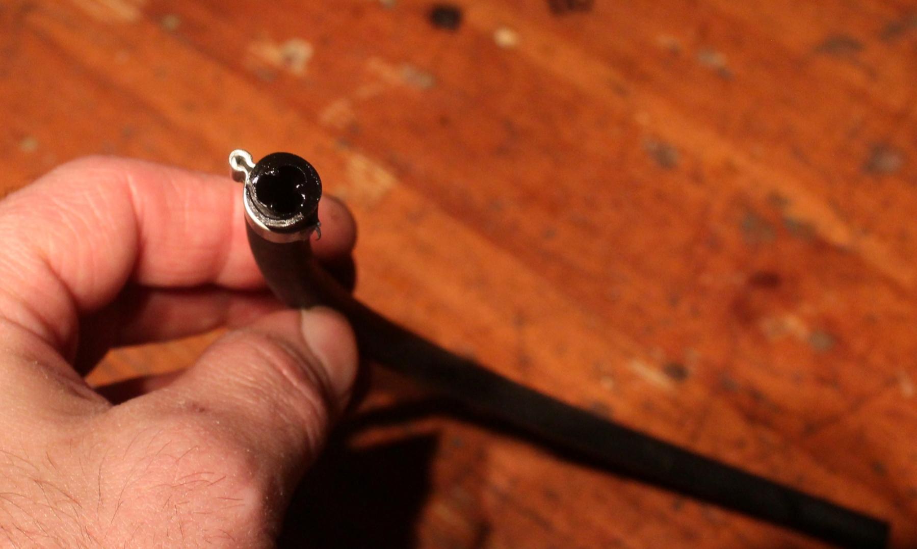

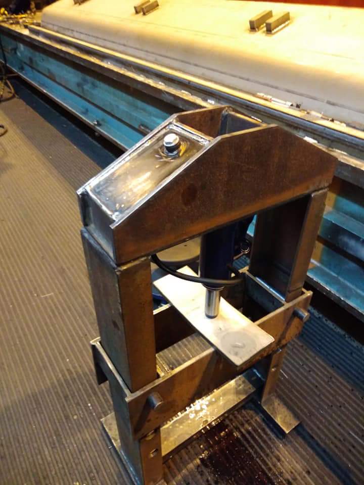

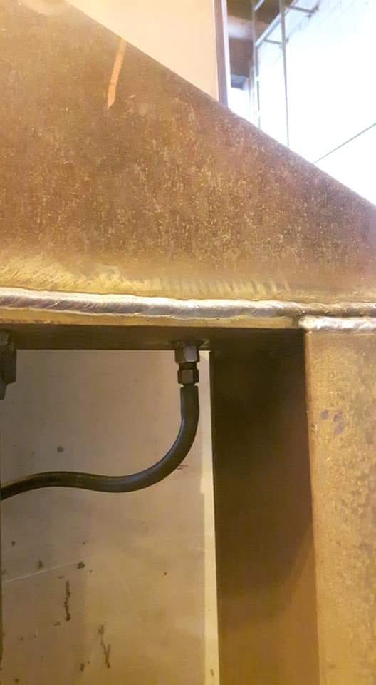

    20 ton press. Jack is inverted same way as shown on the video above.
    This time oil tank is integrated to press frame.
    Mount for the hydraulic jack.. Turning it upside down.-fb_img_1532402677283.jpg
    Mount for the hydraulic jack.. Turning it upside down.-fb_img_1532402689676.jpg
    12mm plate and 160 x 60mm u-channel with 12mm wall.
    Should handle bigger jacks too.
