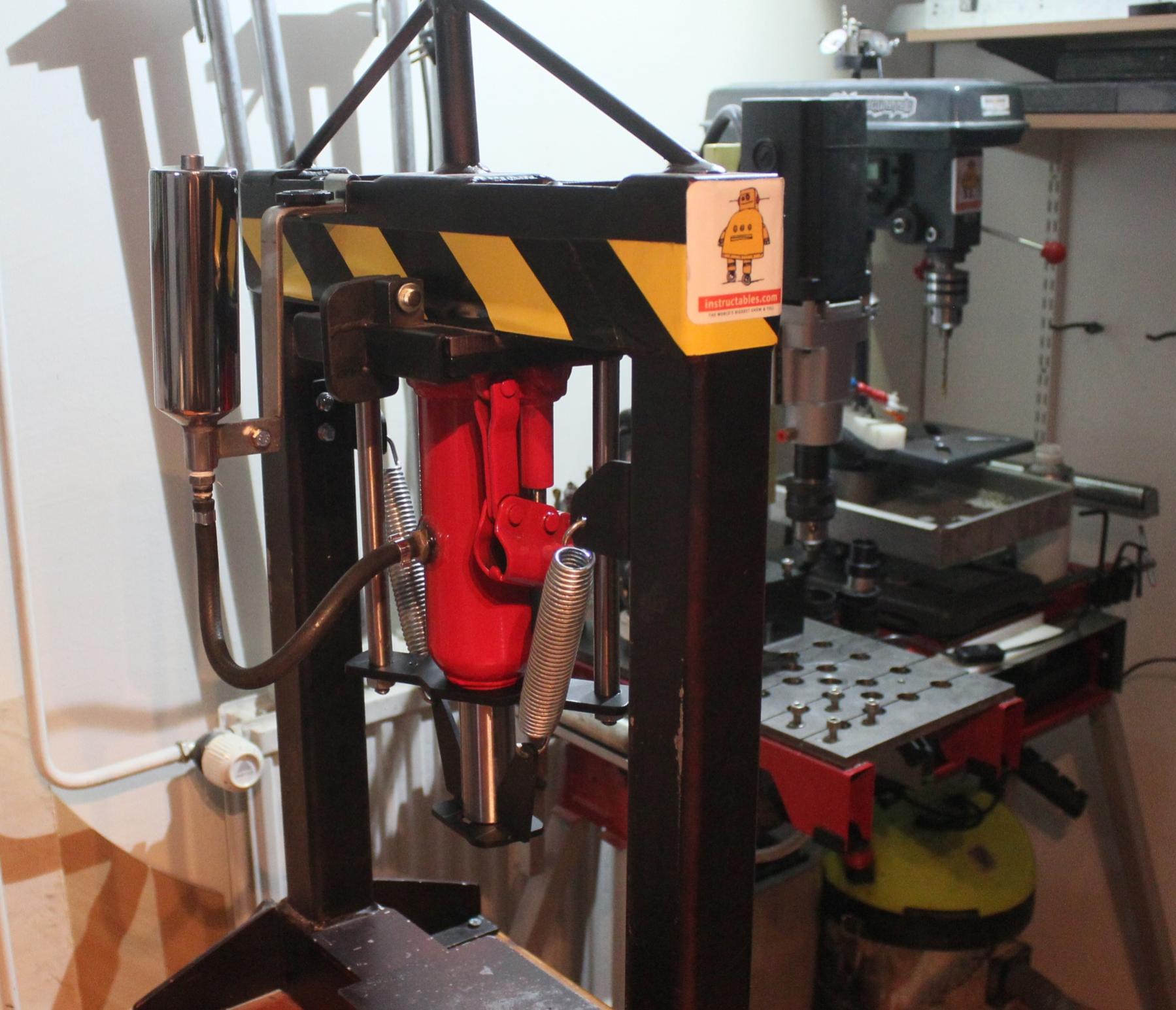

Mount for the hydraulic jack.. Turning it upside down.
Wanted to add bigger jack to my press.
To get most of the pressure to the small area, i decided to turn the jack upside down.
This way i can mount hole punching and stamping dies directly to the cylinder of the jack.
In use:
Attachment 23111
Stored:
Attachment 23110
Takes about 10 seconds to assemble / disassemble.
Springs are surplus from trampoline. Bigger holes drilled with a variable wood cutter, with diy hss blade.
Used cheap 8 ton jack that was sealed with welds.
Actually this should work with "any" jack, without need to open it.

Picture shows how springs goes between the rods that hold the jack
Attachment 23112

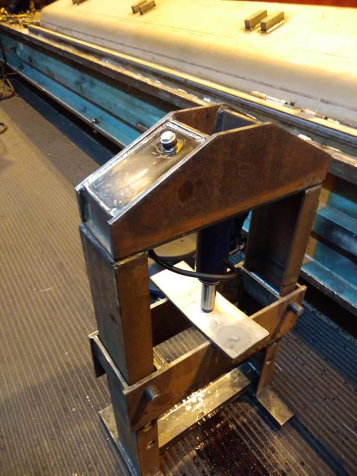

This is the reason why i welded similar plates to the bottom and upper bars of the frame..
Attachment 23116
I can use same dies with both jacks.. when i need to bend thicker materials i use bigger jack..
With thinner ( <5mm ) i use smaller one, wich is more accurate and faster to use.

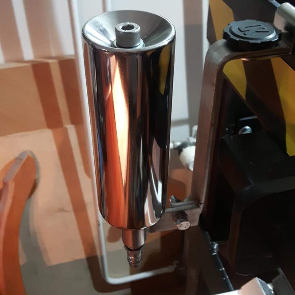

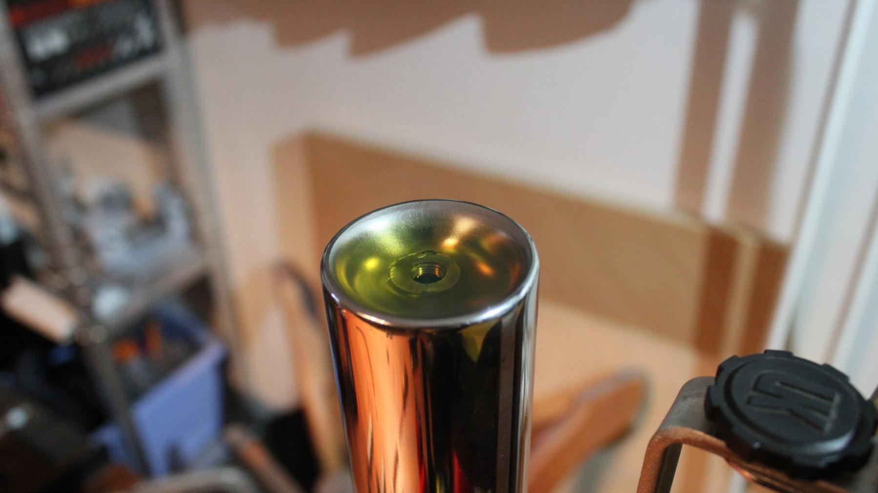

I used surplus cutting fluid container as a oil container,
for mounting it to the press, i used clamp that's originally intented to connect flashlight to the welding mask.
Attachment 23118

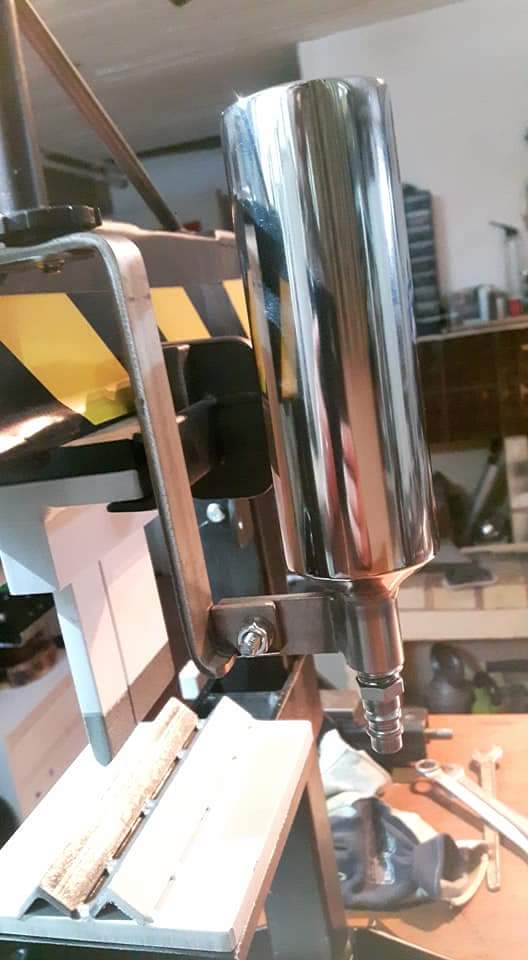

Edit:

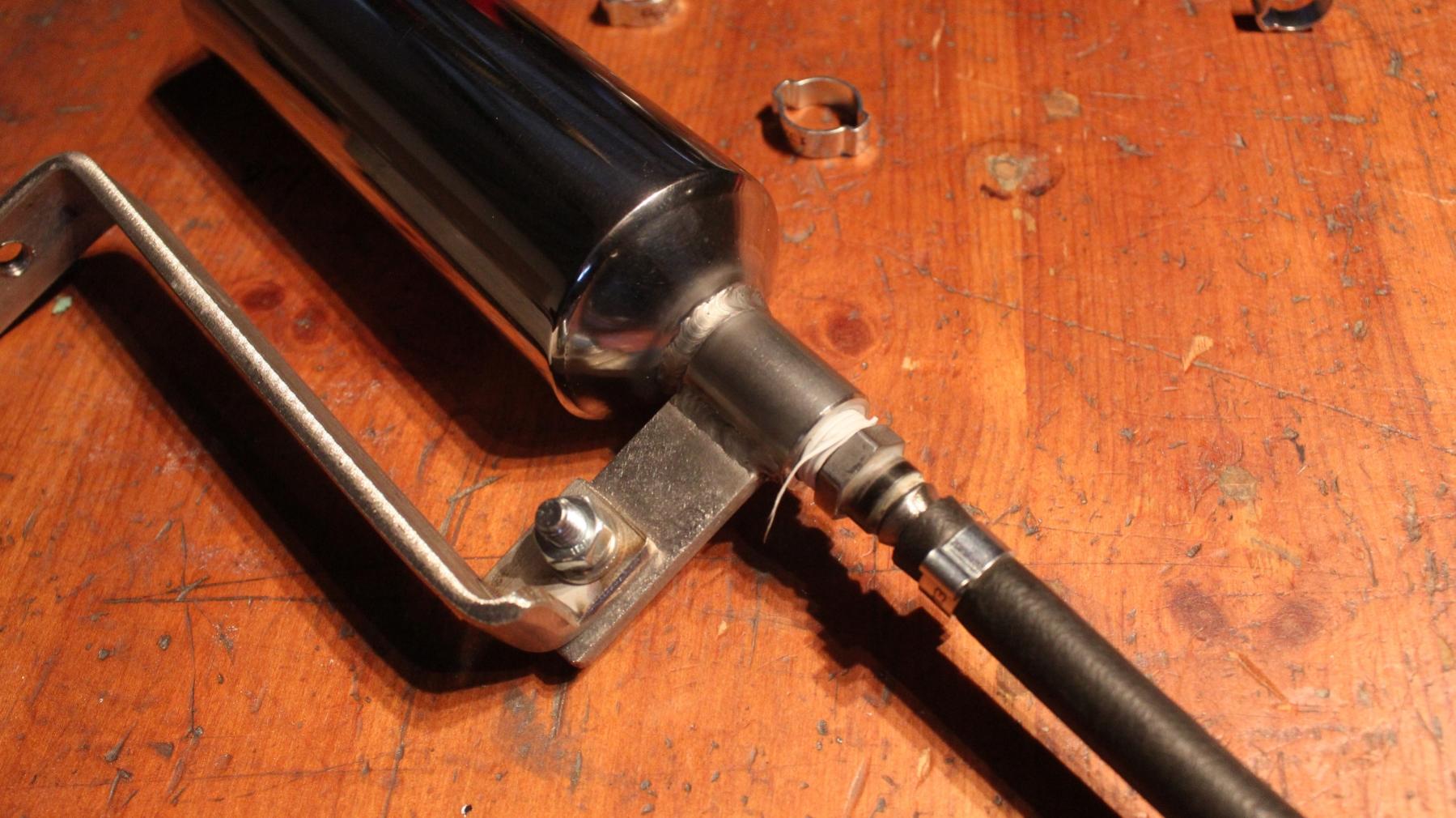

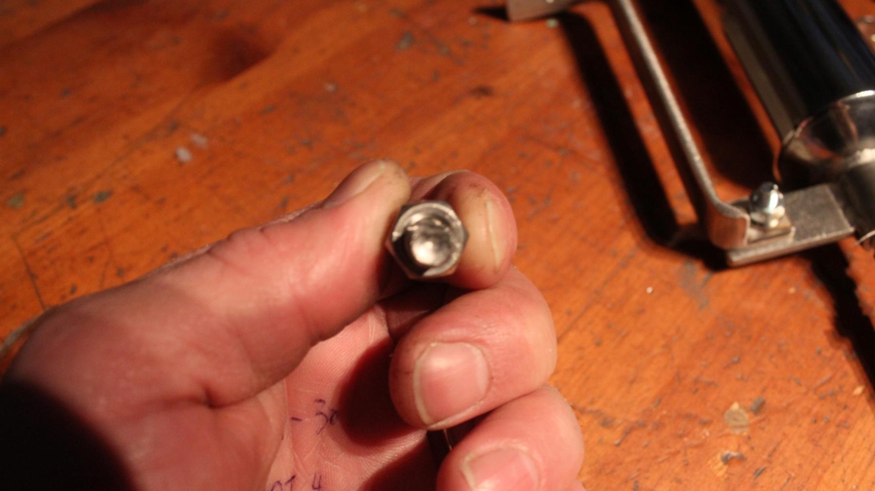

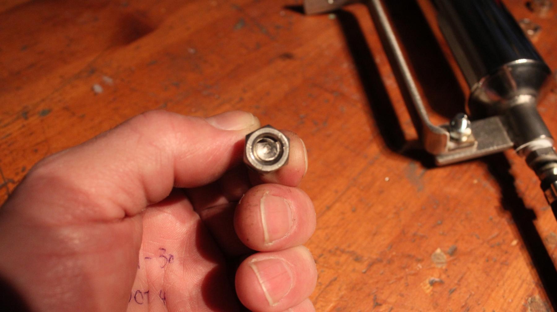

New container:

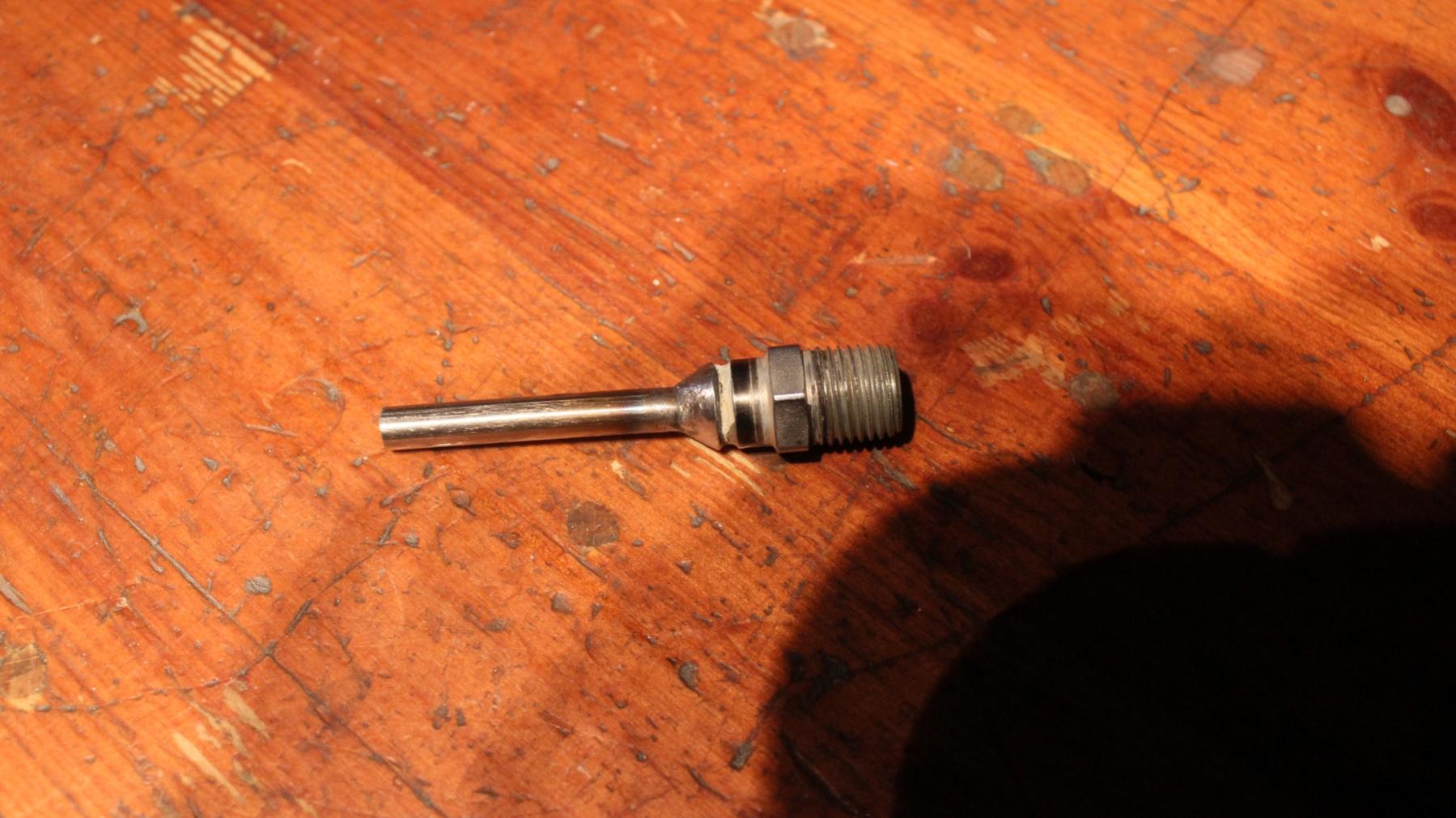

Fitting. Didn't find suitable, so i made it from bigger one, cut the end out and welded piece of 6mm ( hose is with 6mm inner dia ) thick pipe to it.
Attachment 23344

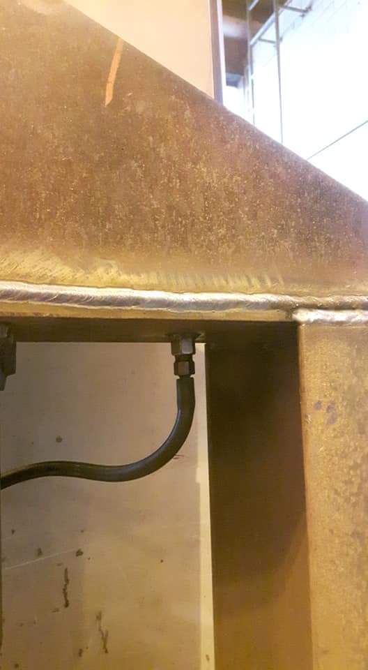

Connections..
Attachment 23345

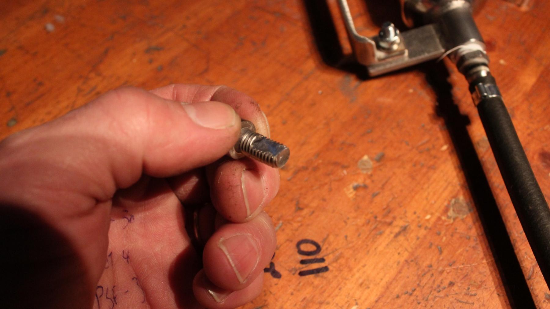

Cap is made from a bolt. I filed groove to it, it allows container to breathe.
Attachment 23346
Open..
Attachment 23347
Closed.. When stored, so it doesn't leak if it falls.
Attachment 23348
Easy to fill..
Attachment 23349
Ready.
Attachment 23350

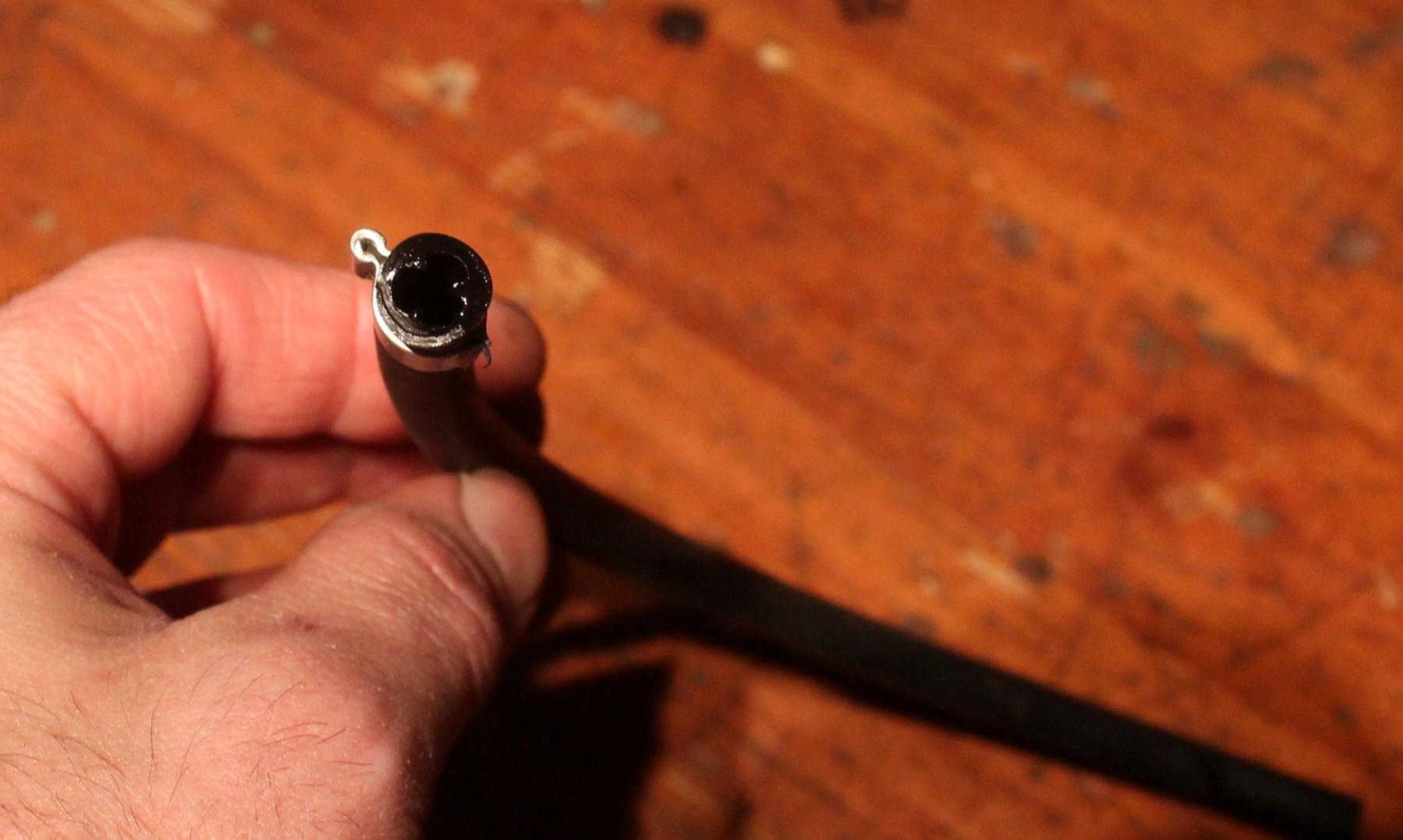

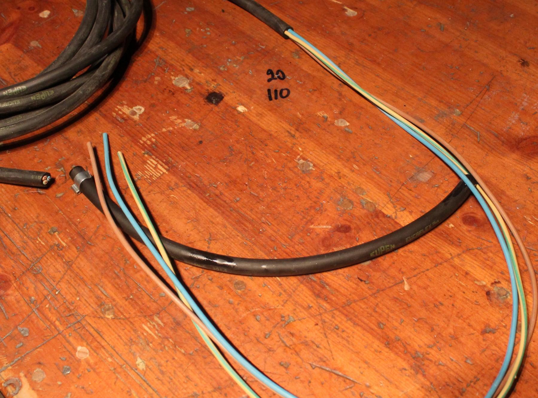

I used this hose in that first version. Now i changed it to appropriate one...
Attachment 23351
But at that time, i had any hose and stores we're closed. So, i improvised.
I peeled it from electric cable. It worked nicely that time i used it, but i decided to change it before it breaks.
