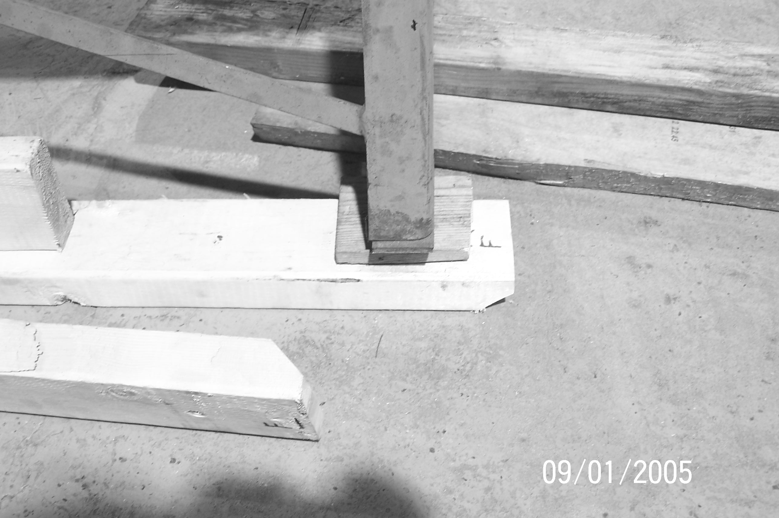

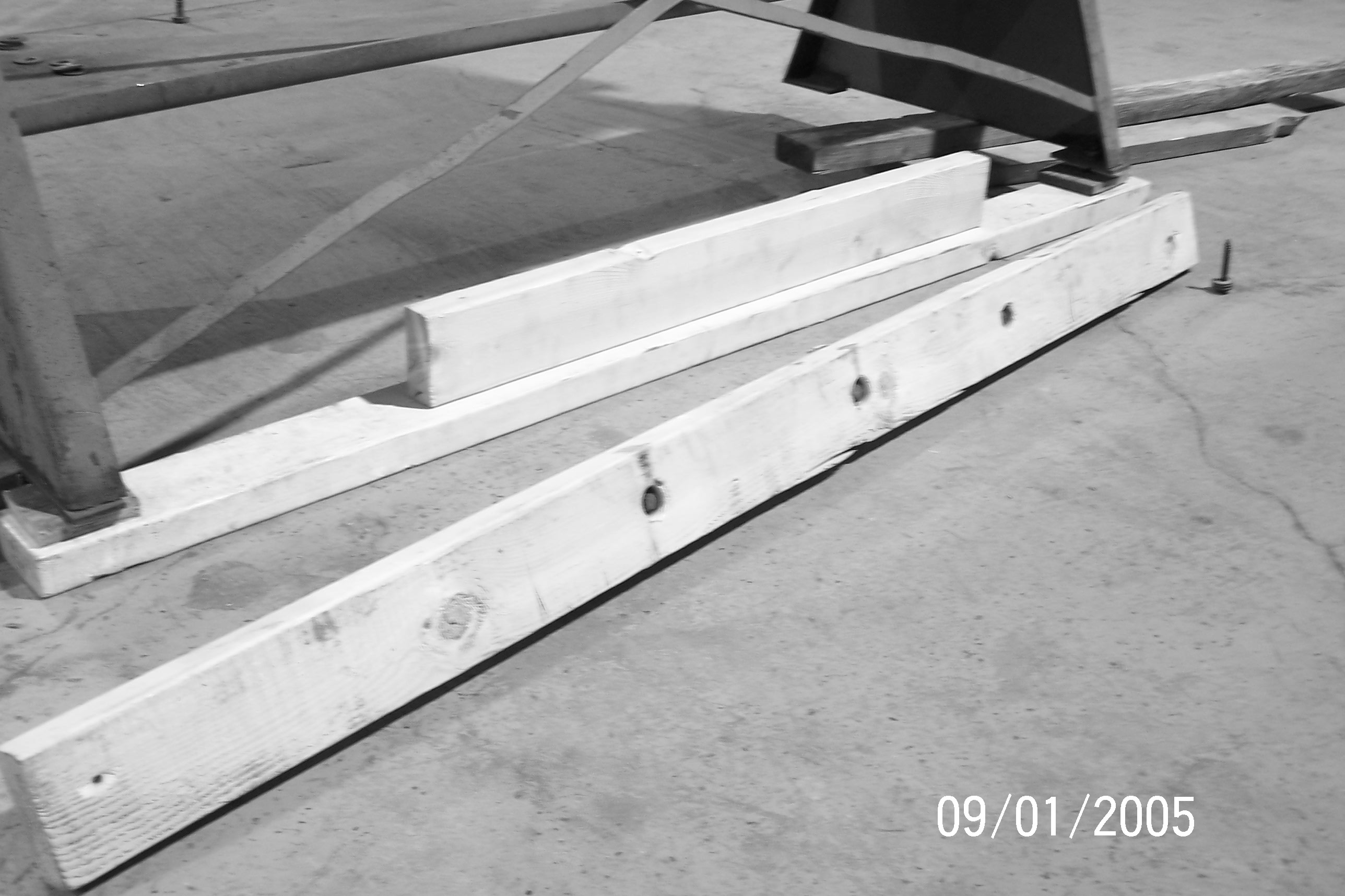

1] Built two skidding rails, connecting right and left side feet. Lag screwed remainder of 2 x 4 vertically to stiffen them. Great job for cordless tools; if you remember bits and drive sockets. As it turned out, preferred 2x6, there was some bending, yet rib stopped any breakage.
Attachment 25736

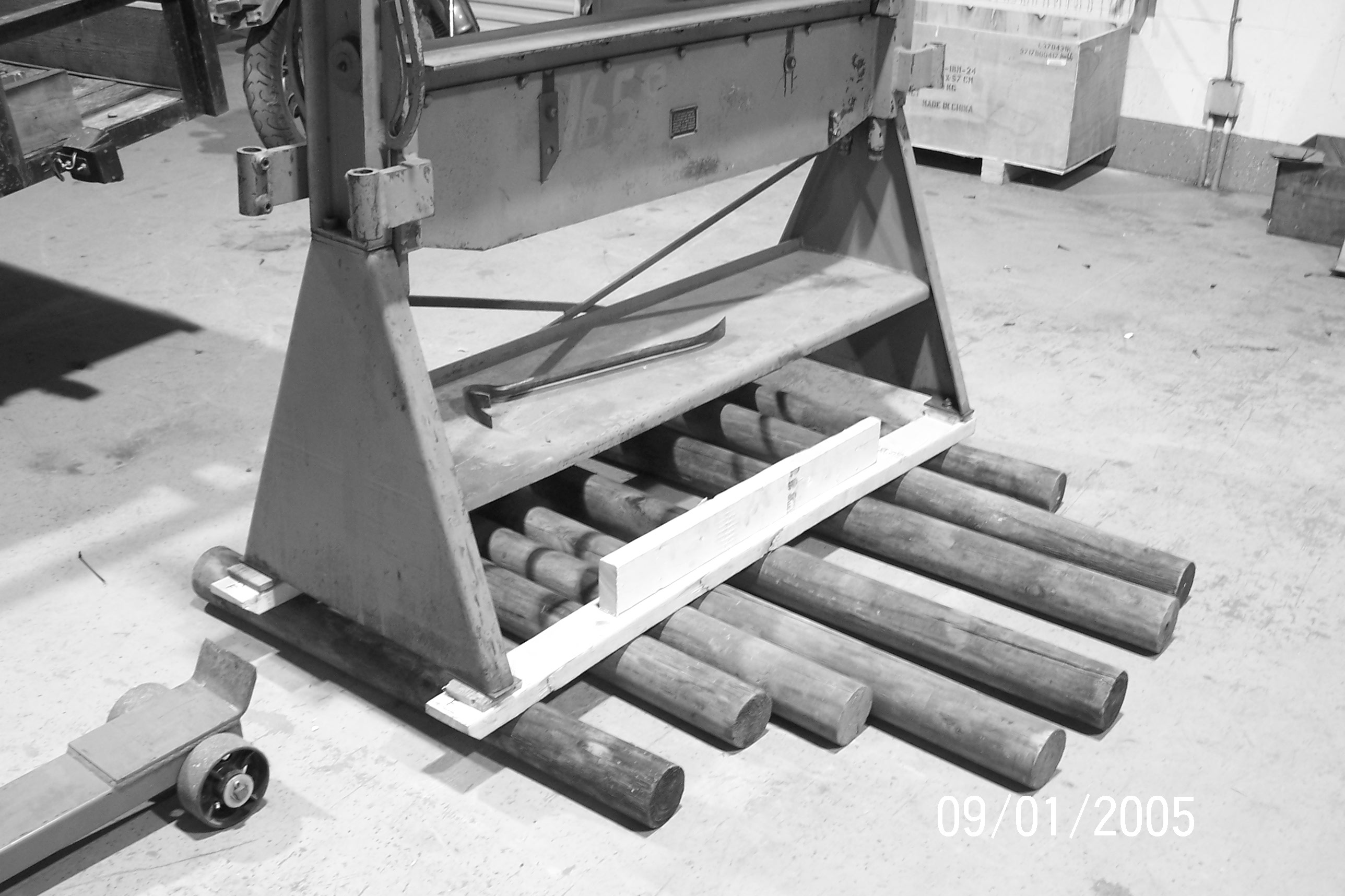

2] Raise and block each end, place rails under feet, marking anchor holes inside leg with felt tip pen. Removed and pilot drilled 4 places for lags and XX heavy USS washers, then installed. Don't want lags protruding from skid bottom.

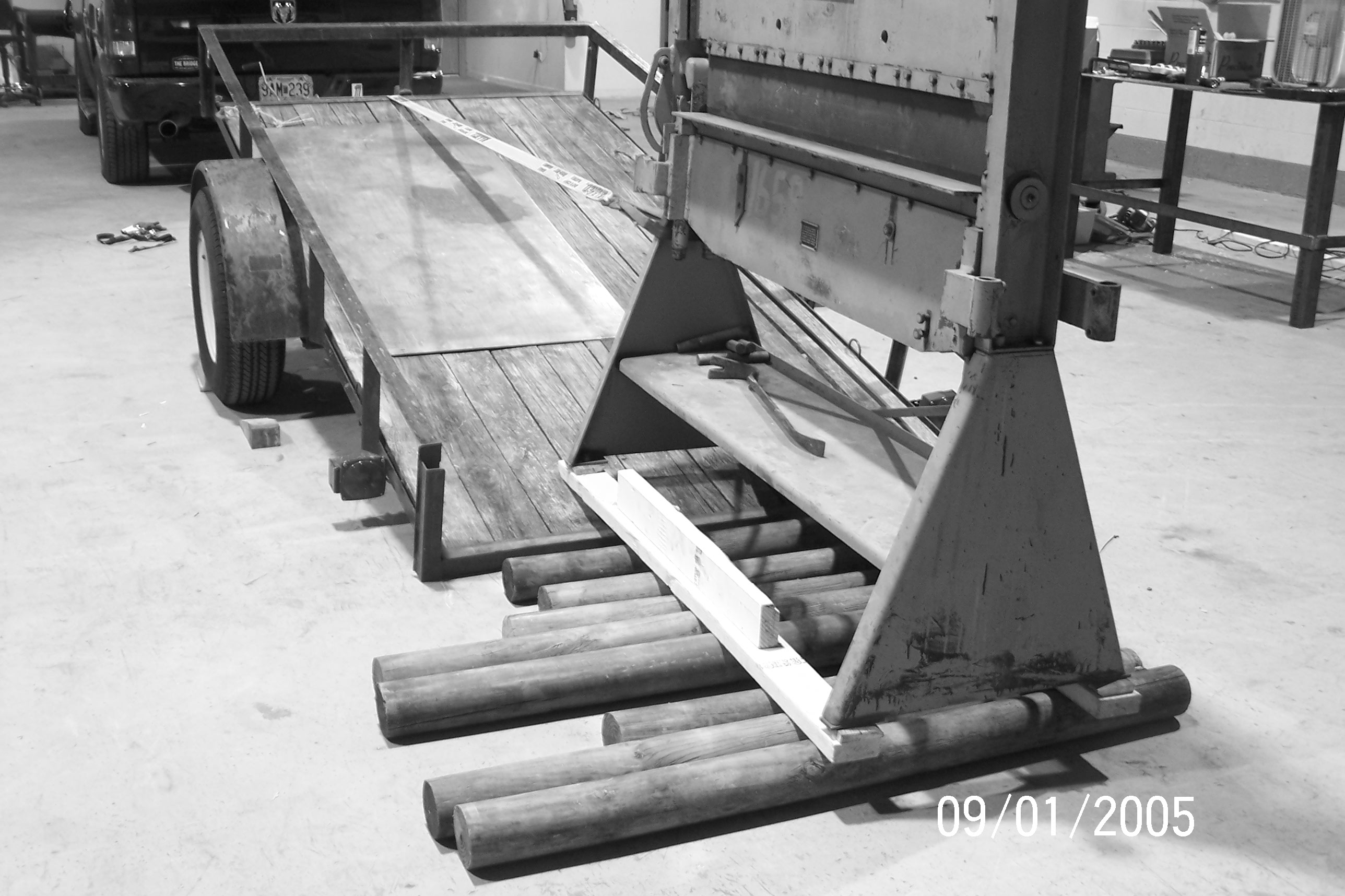

Attachment 25737
3] Positioned truck/ trailer centered to longitudinal axis of brake at far end of room. Got brake up on rolls, and other side of room, still aligned.
Attachment 25738

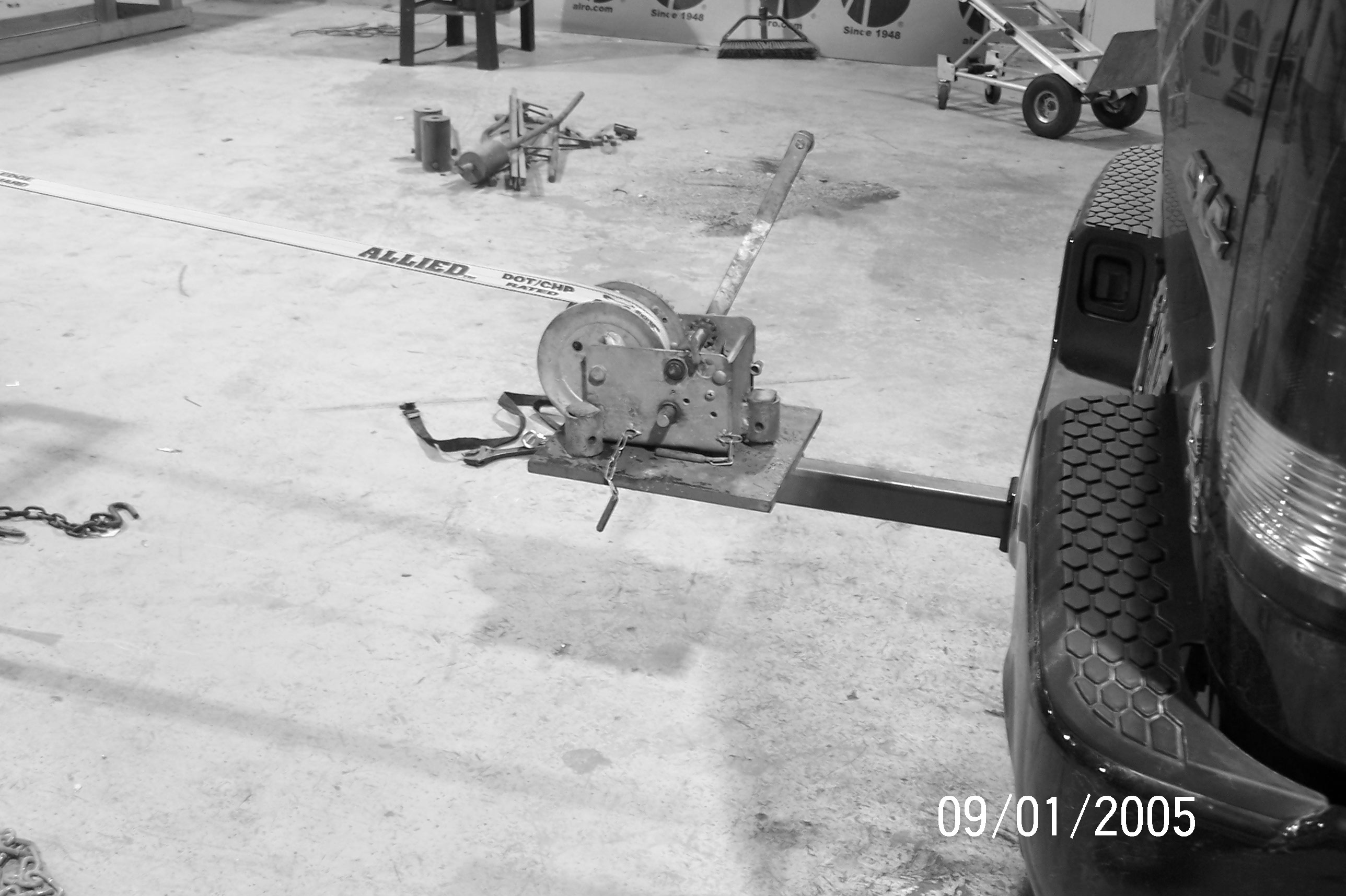

4] Backed tilt bed trailer within 10'of 1st roll. Blocked wheels fore and aft, disconnected hitch, raised trailer. I have a two speed manual boat winch on a second hitch mount, so paid out all 30' of webbing through trailer. Wrapped length of chain in dunnage around closest machine leg and created loop with grab hook. A slip hook is on other end, so chain can be used both ways.
Attachment 25739
5] Hooked winch strap to chain and began taking up slack enough for tension and test everything rolls. Truck anchors the winch, chocks anchor the trailer. Two hardwood wedges help rolls make transition floor to trailer bed.
Attachment 25740

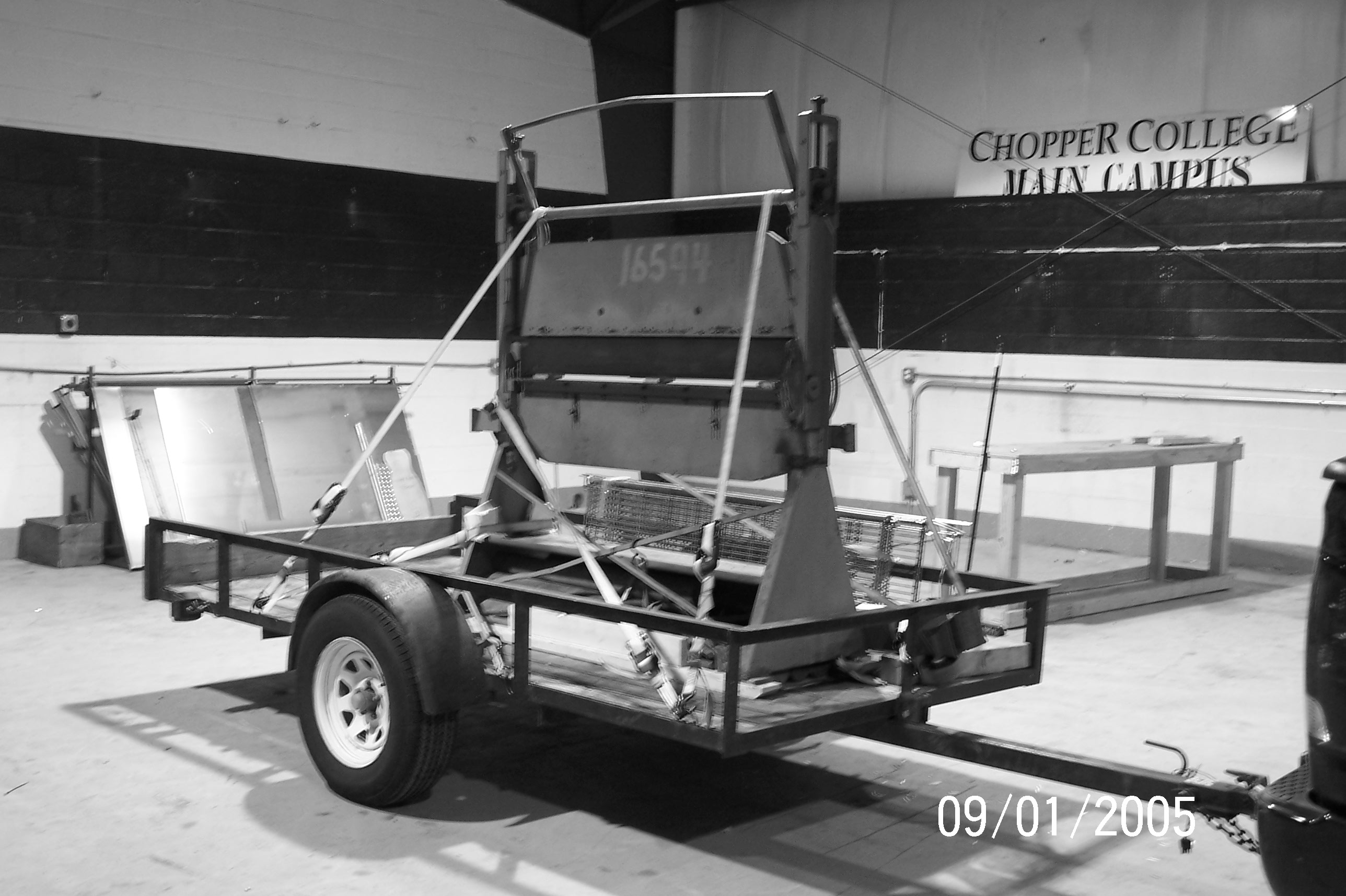

6] Winched onto bed, after two tries. Painted floor wouldn't allow chocks to 'bite'. Found carpet padding in empty office, did the trick. Once the trailer stayed in place, able to continue reeling onboard bed. I had measured overall length of brake and knew ahead of time when 50% of weight would be over axle. Then used that figure to position 60% forward when bed righted itself. calculation was barely an inch off..
Attachment 25741
7] Began tying load down. Care is needed, due high COG to arrest ANY tipping motion. Took one full turn of strap around upper shaft on a layer of print paper so they'd cinch up right to left of trailer. The machine paint made too much resistance. Longways still important, but had good rail to bed friction, so they were tied off lower and crossed front to back, each side. Pulled out of building at 630am.
8] Stopped at first 20, then every 80-90 miles to monitor strap tension. In 540 miles, only one adjustment occurred, at first 20. That's typical as a load settles in. At half way, loosening was no concern and proceeded until just prior last few miles through town. I did flick each strap when stopping for gas. Frank S labeled this a 'text book' move. Yep, bring a lot of tiedowns; and use them all!
