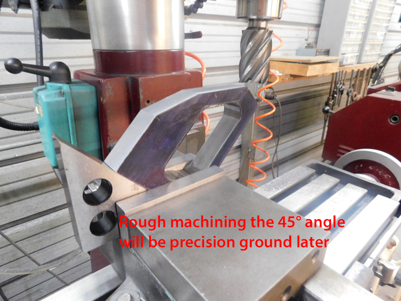

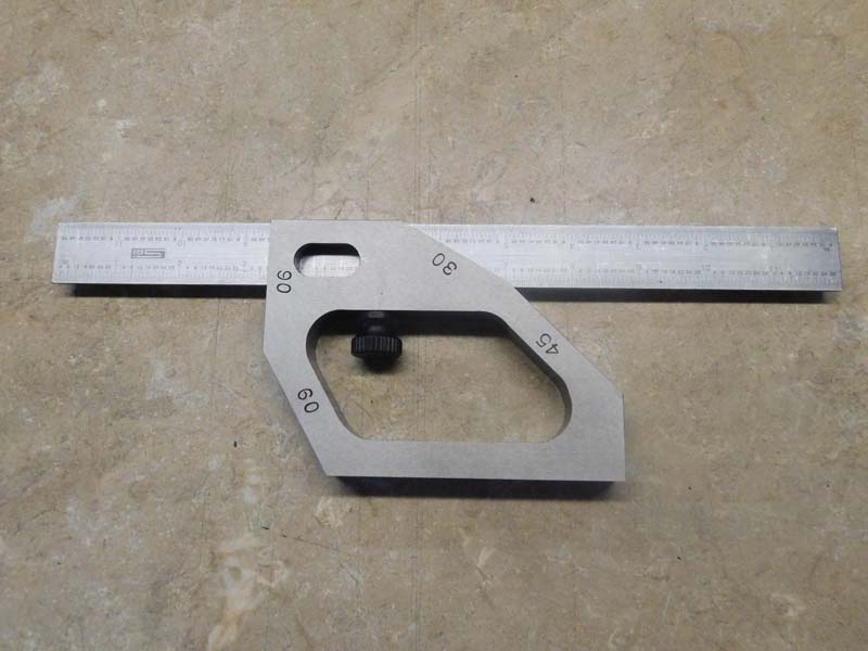

On several occasions during my adventuress life of being a Tool Maker I have thought about the combination square and wondered why doesn’t it have more angles built into it than just your normal 45°-90°? although I know those two angles are the most commonly used, though a 30° and a 60° is not too commonly used but it would be nice to have those two angles incorporated into the square head also, there have been on several occasions I thought of making a tool like that so I wouldn’t have to change the square head to the protractor head to get a 30° or 60° angle, although I’m almost certain someone has already built a tool similar to this one or there is one on the market somewhere, I did a little research and found a couple of speed squares that had multiple angles but nothing that used a blade like the combination square.

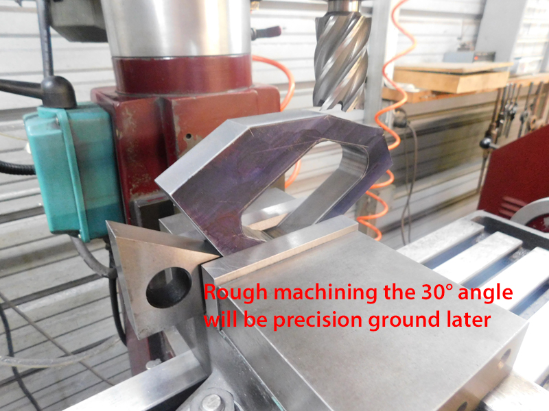

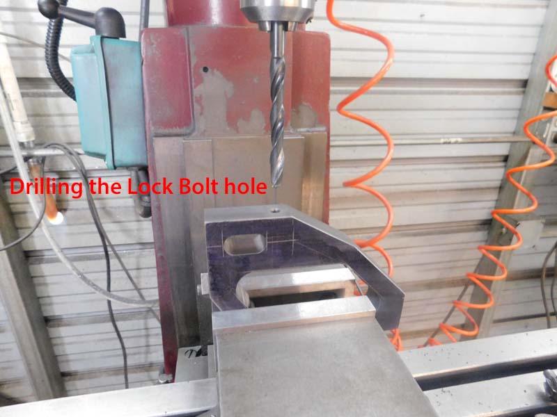

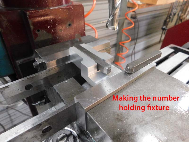

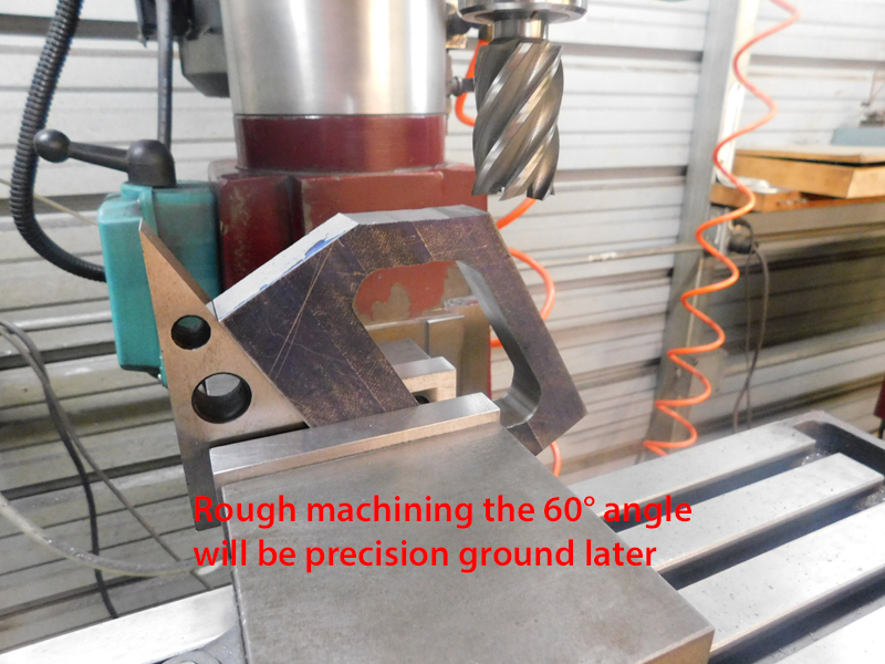

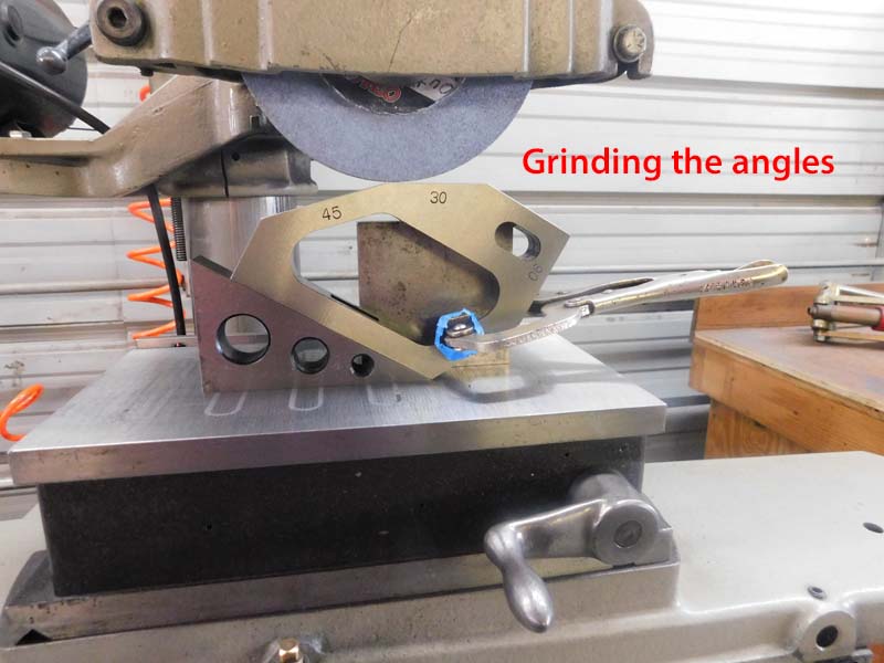

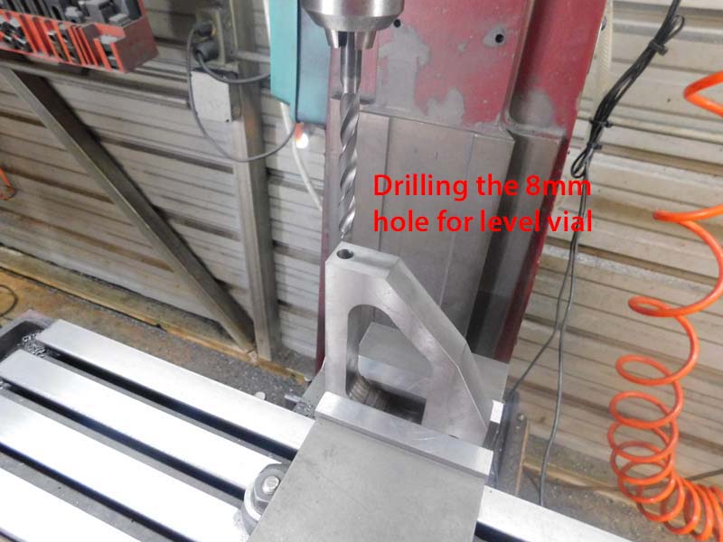

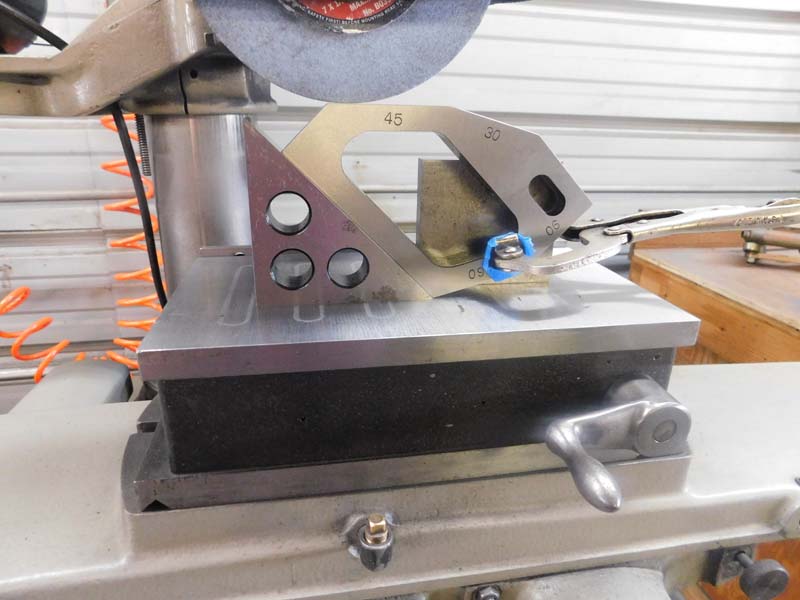

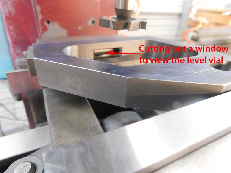

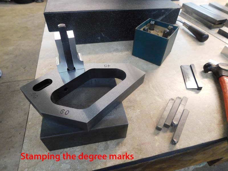

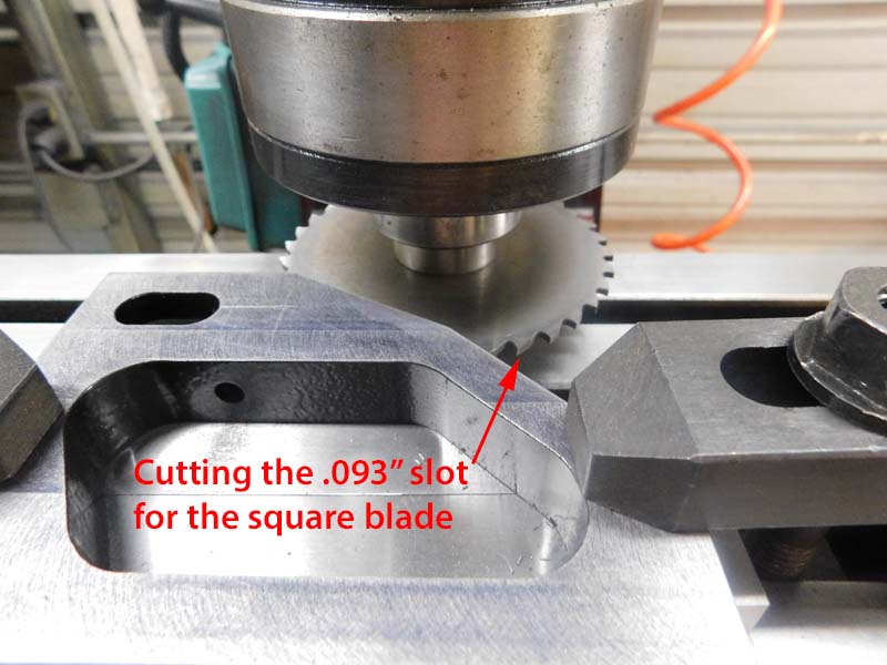

With all said that’s what got me started with this tool I call the Multi Angle Square, it has a 30°-45°-60° and a 90° angle built into the square head without having to orientate the blade any special way, the blade slides into a slot and locks down just like your ordinary combination square, the angles are orientated around the outer perimeter of the square head and clearly stamped identifying there angles, I also had to make the number stamp holder too,(always something) there is also a level incorporated into the base of the square head.

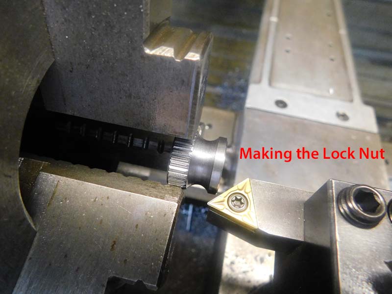

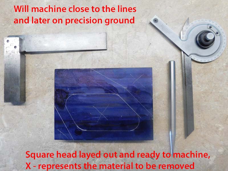

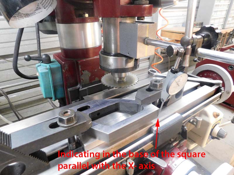

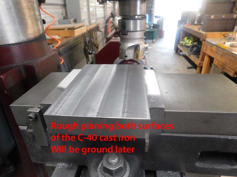

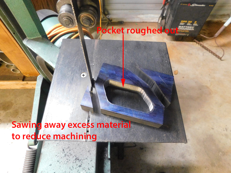

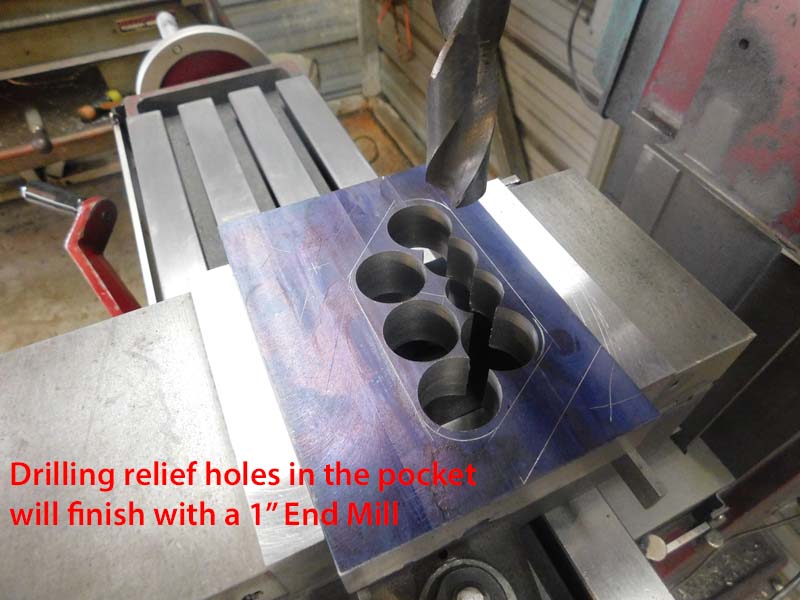

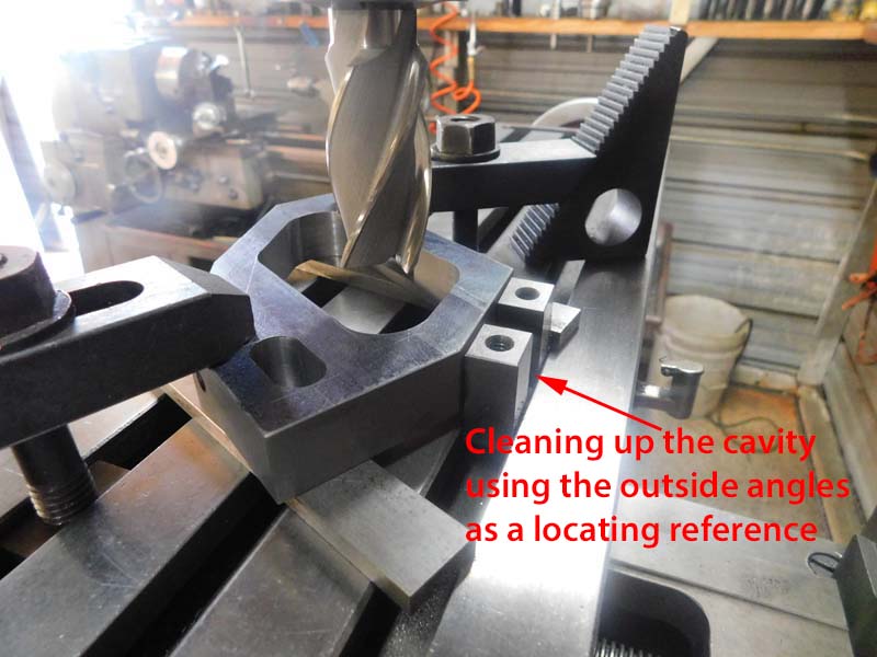

The Square Head is machined from a solid piece of C-40 Cast Iron, the locking bolt was made from a 1/4”-28 grade 5 bolt, the lock nut was machined from 1018 steel, the square utilizes a standard 12” or longer blade, all angles on the head were setup and located from the bottom of the blades slot and ground to their final angles using precision angle plates, I have included multiple photos of the machining and grinding processes along with a video demonstrating the use of the Square.
As Always Thanks for Looking and Happy Machining
Doug
Attachment 24212 Attachment 24213 Attachment 24214

Brilliant design and production.
When you go into production I want to buy one. Please. Pretty please, with swarf on top.
[QUOTE=rlm98253;113018]Brilliant design and production.
I concur, very slick idea.
You did a great job of detailing the making too.
Thanks!
Thats fantastic Ross!
Does the "window" on the sliding ruler section reference to anything? Or enable you to "read" a value?
What paint did you use on the inside of the "handle"
Phil
Very original and useful designed item. Thank you for sharing. (Surface grinder on my shopping list ;))
The home Engineer
Oh alright, soon as I get things setup I'll make you one, LOL
Thanks Rim
It also does 15º, the 30/45 vertex gives you that as well. Very nice tool, VERY nice.
Thank You very much
Moldyjim
Doug
Thank You 12bolts
The window you're refering to is just to reduce a little weight and cosmetic, other than that no functionality, the paint I used was Rustoleum Hammered Black
Thank You
Doug
Thank You thehomeengineer
Yes surface grinders are wonderful machines
