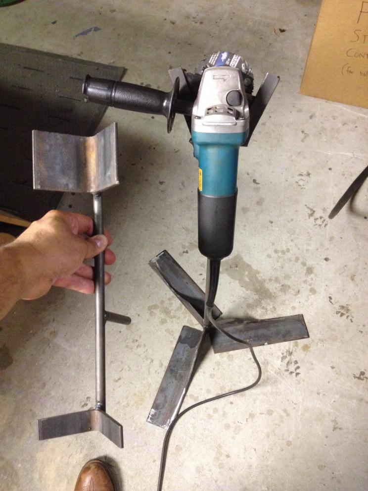

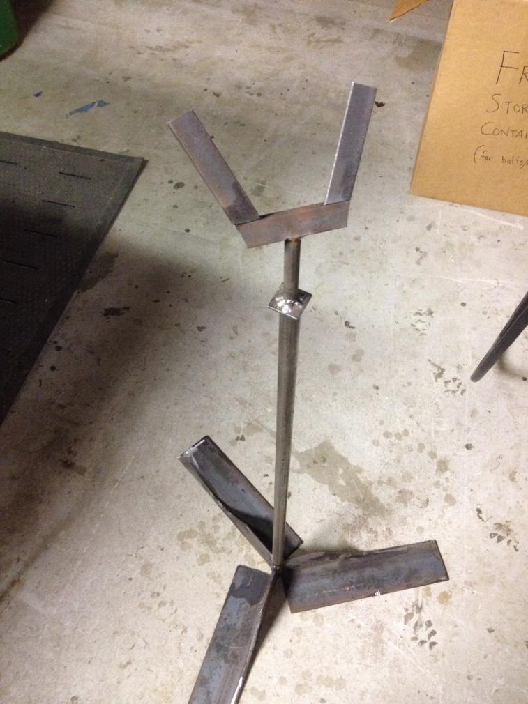

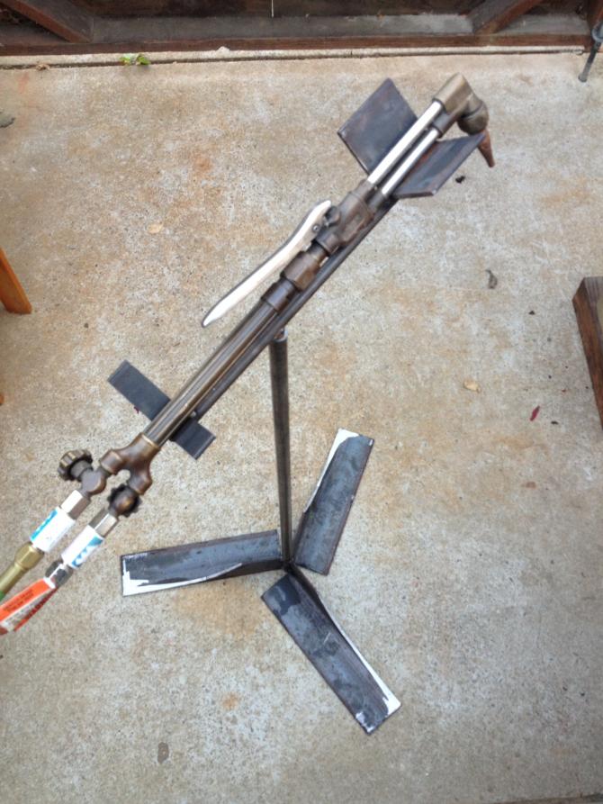

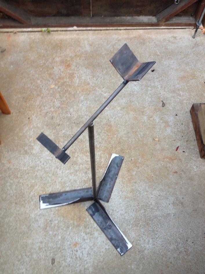

Here is a little tool stand I made with scraps and cutoffs around the shop. It is simple and pretty self explanatory...the torch attachment is made from a 1/2" rod with 2 1/2" angle cutoffs welded to it. It has another 1/2" rod that goes into the base pipe. The grinder holder is made from 1" angle and also has a 1/2" rod on it to fit the base. There are infinite possibilities as far as holders are concerned. I plan to add some "third hand" attachments as well in the future.

You Sir are a cleaver GENIOUS!
I can not count the times I looked for a spot to put that torch!DYNOMITE
