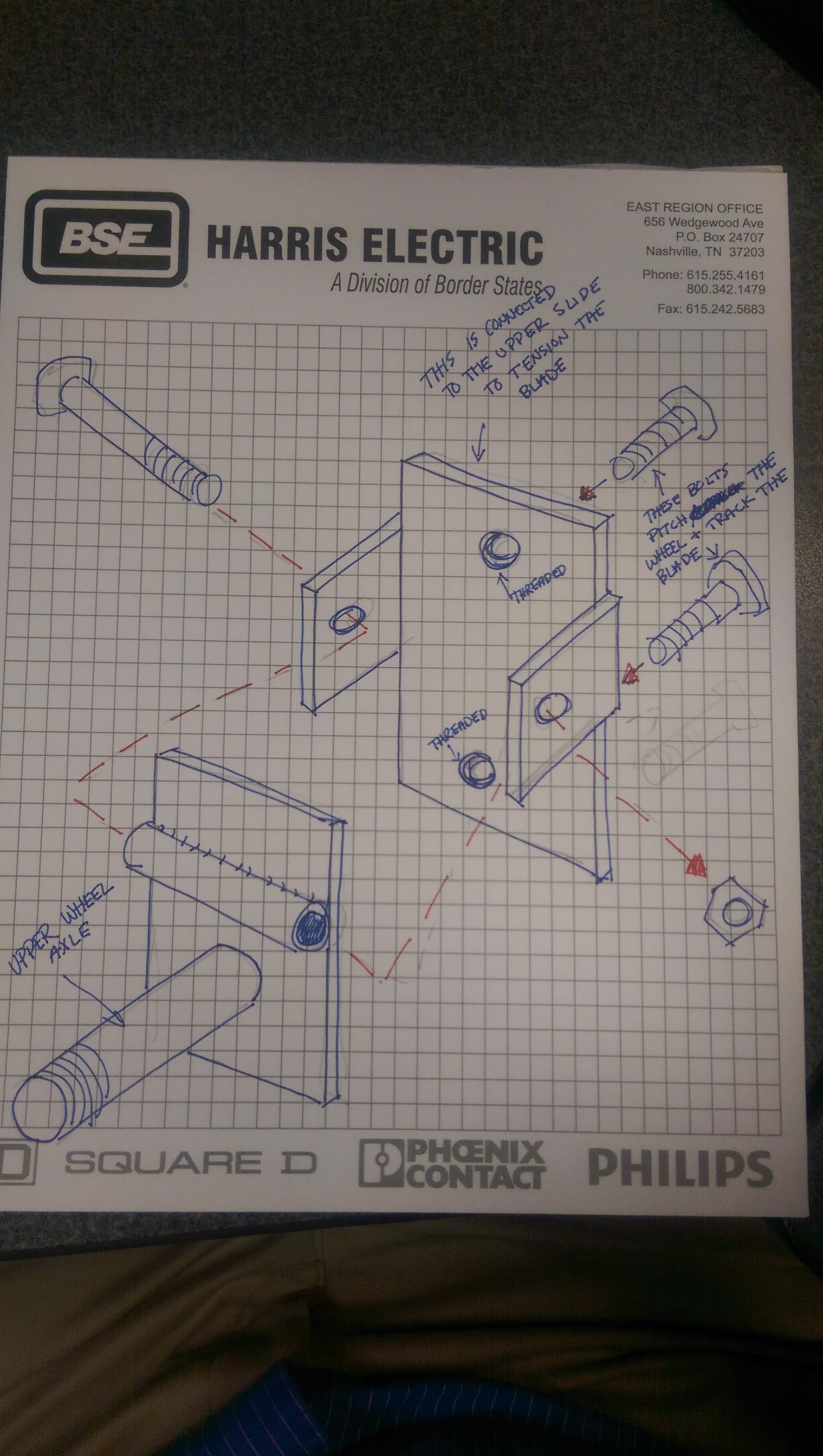

Thank you for your reply Matthew. My build is progressing slowly but just 2 points I am not sure about and that is the way you say that you hinged the top wheel bracket to enable the wheel to tilt, that has got me stumped and the top sliding blade guide.

1 Attachment(s)
Attachment 9645
I have not been back to the shop recently and I don't think I have good pictures of the tilting mechanism. See if this sketch helps. The wheel axle is on a plate that can pivot. There are 2 bolts that come through the back to adjust the amount wheel tilt. One bolt above the hinge pivot point and one below. If I want to pitch the bottom of the wheel out, I loosen the top bolt and tighten the bottom. All this moves up and down on the slide assembly that tensions the blade.

Thanks for the sketch, it explains everything perfectly. I thought that it would be something along those lines but now it's full steam ahead.
