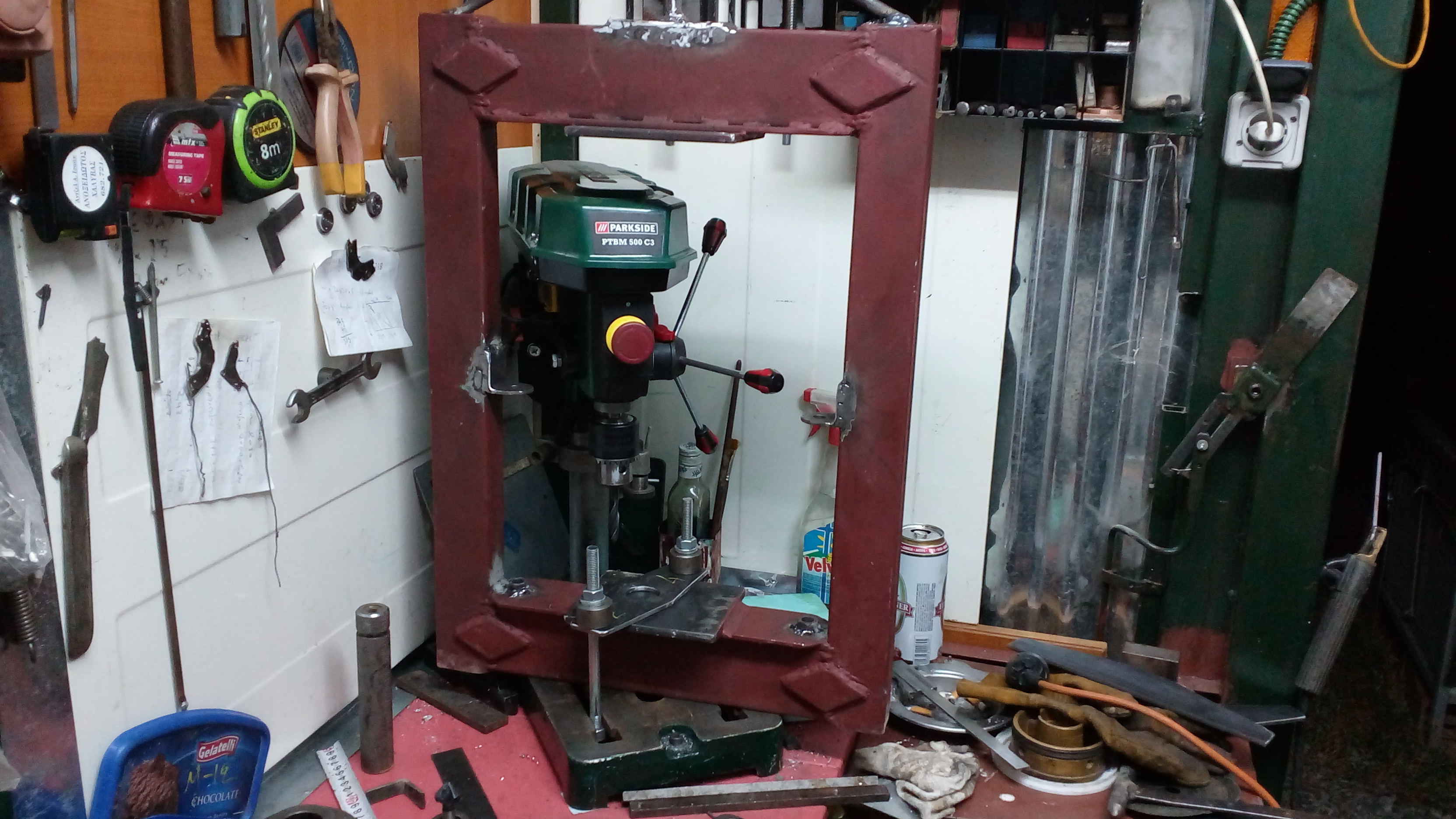

I have always thought of making a small press, but I put it all for later.
Until the time came and I made it.
Twenty-five years I was the owner of a company whose main equipment was the presses (hydraulic and eccentric from 12 to 300 ton) for the processing of stainless steel and the production of stainless steel utensils for home and professional use.
And I did not had a press for my hobby
Also I want to Thanks Tuomas for his footings design, that I have use.
Attachment 26863

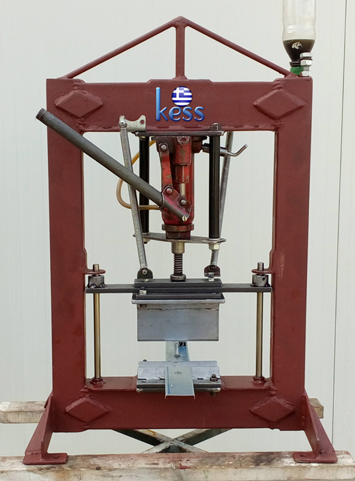

Part1: include the build of main frame, the footings, the upper side truss, the jack's base and the modification to work at upside down position.
https://youtu.be/hSZcYwU6aLw
Part2:include: the build of movable support bed
https://youtu.be/H8zjokS8Be4
Part3: include the build of dies/molds and first tests.
https://youtu.be/EMSgtslI9a4
