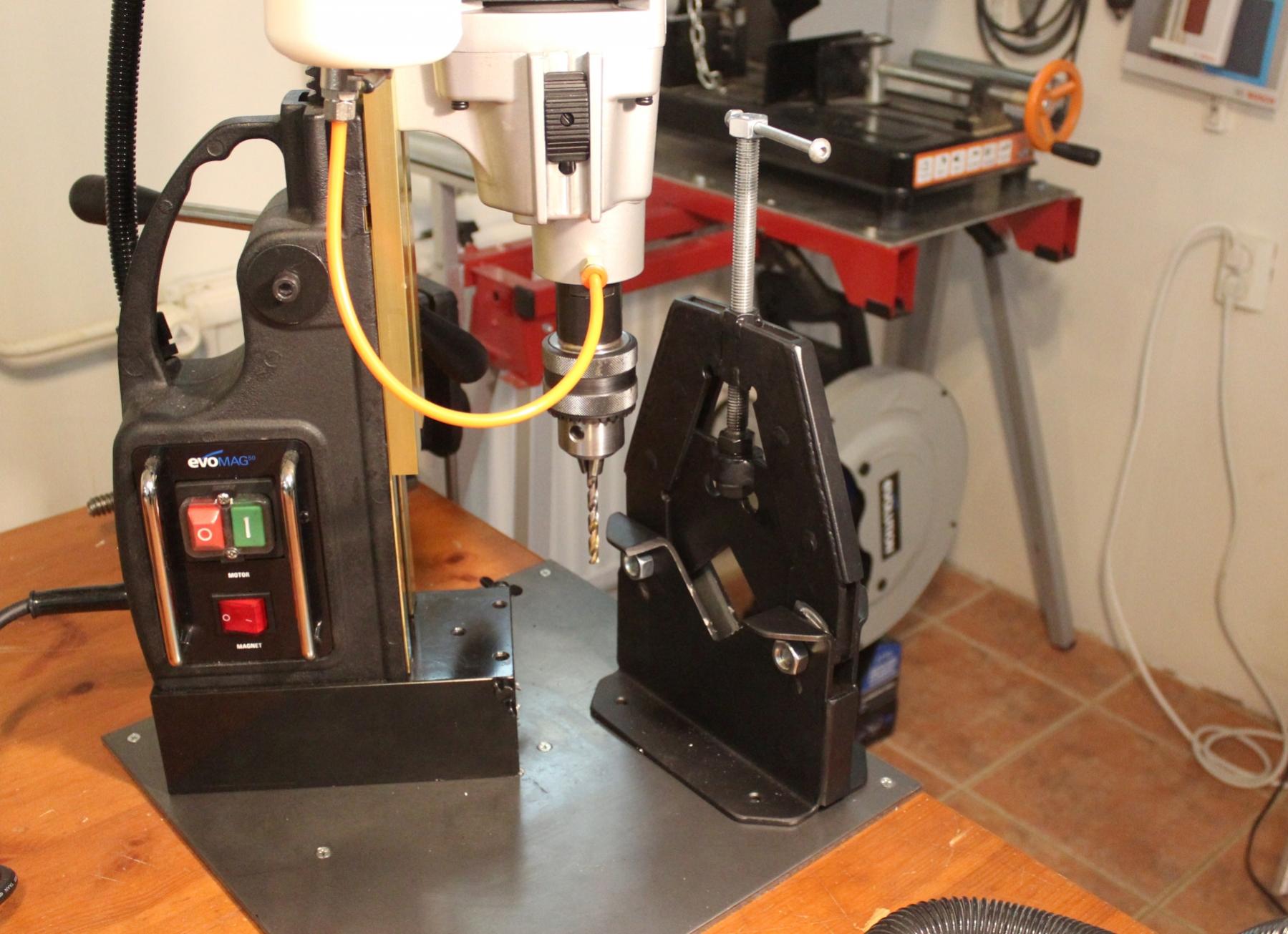

My pipe, rod & tubing vise
Made a simple vise for clamping round and square objects.
Attachment 19242
Attachment 19243
Attachment 19244
https://www.youtube.com/watch?v=0Bby...ature=youtu.be

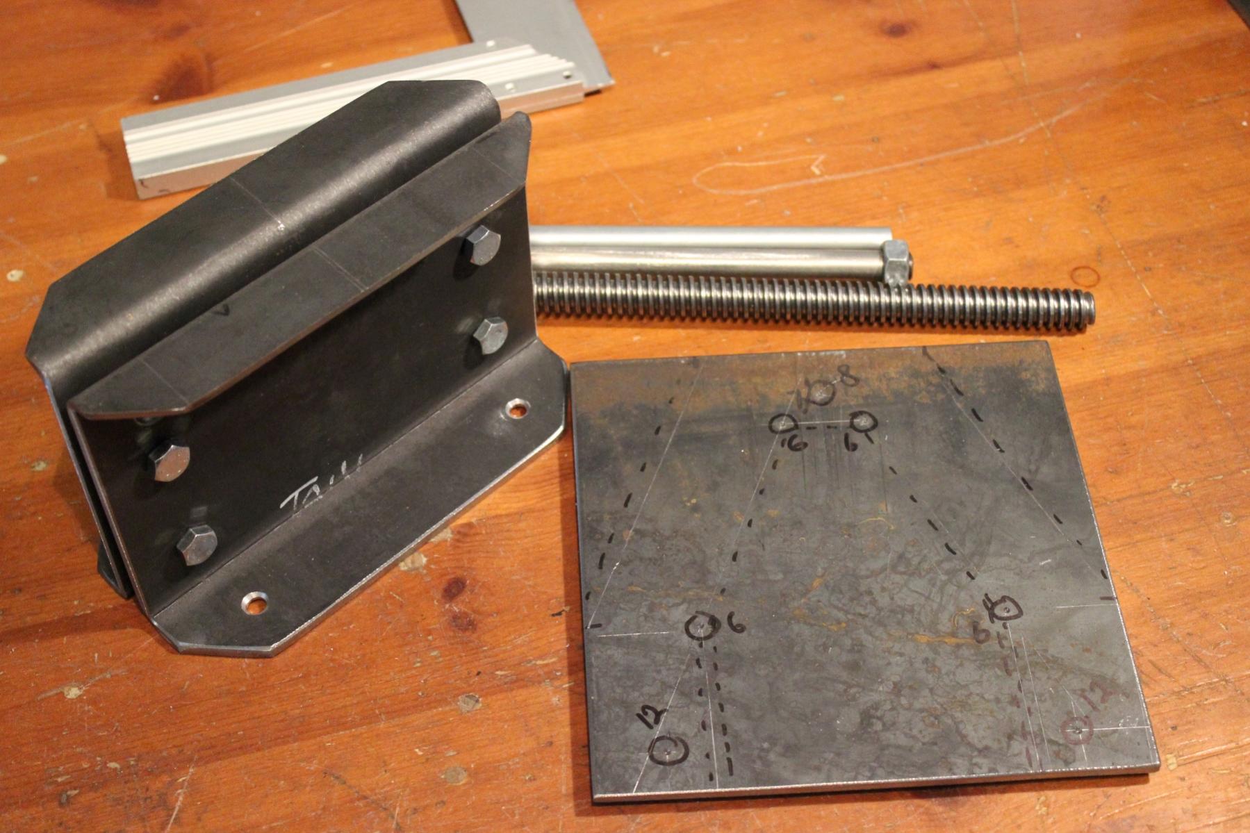

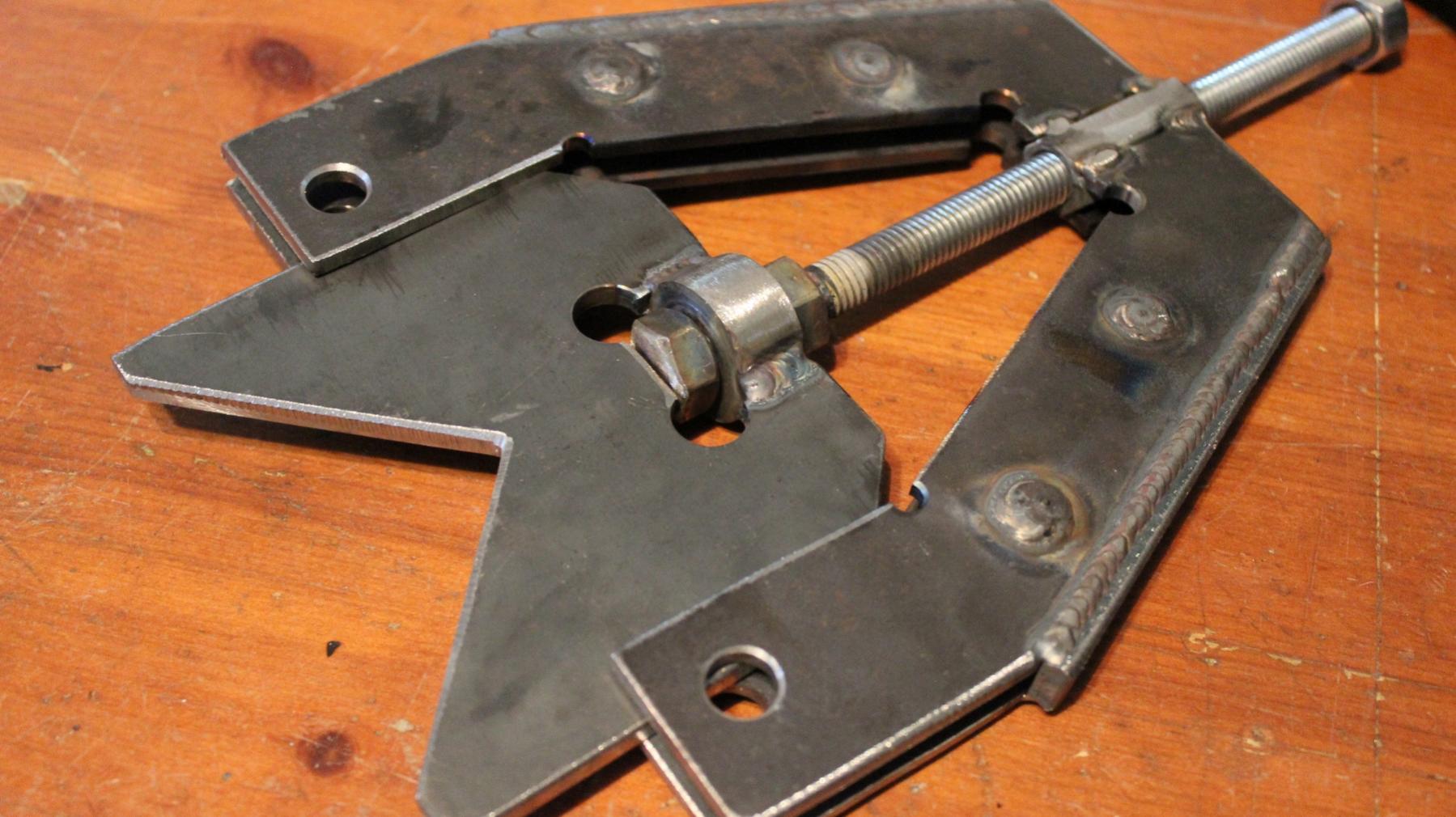

5 and 8mm steel plates.
M12 threaded rod, long and regular M12 nuts. Two 40mm long M12 bolts.
M8 nuts and threaded rod.
Alumine pipe 8mm ( inner diameter) x 8mm (lenght) pieces with 2mm wall.
Long M6 bolt and nylock nut for handle.
This project will continue with the soft jaws and tilting stand builds.
