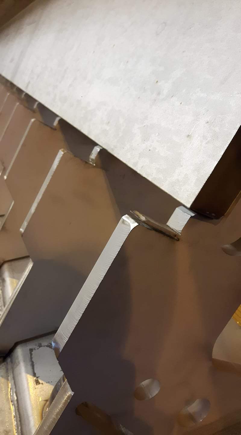

I use angle grinder every day at work. Nothing fits on its place without cutting here. Designers refuse to understand that if they order 40mm thick steel plate, its actually ~42mm thick.. never under 40mm. Still they design slots for 40mm thickness... So, i have plenty of possibilities to train my cutting skills. :)
Attachment 22565
Why not teach them about the 42mm sheets.

There's two reasons... designing is bought outside today, so there's no direct contact to them. Also we don't have separate plans for plate manufacturing. We use same plans than machinists, designers "refuce" to make "errors" to the final plans.
So. It is what it is...

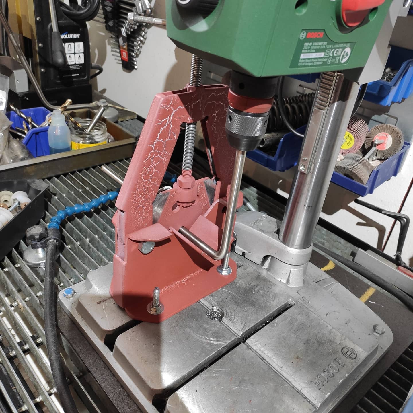

Here is a trick, how to align drill with a pipe vise like this.
Attachment 38932
" Trick " is a piece of axle that's bend to 90 degree angle.
Clamp one end to the vise, and tighten other end to the chuck.
Then tighten vise to base.
I also made some improvements to this.
Attachment 38933
Piece of angle iron is used as a longer lower jaw.
Clamped it to the pipe vise, then i weld it from both sides to lower part of the vise.
Then i made the opening for the upper / sliding jaw with angle grinder. This way it comes straight.
Before welding, i ensured that new longer jaw, and the bottom of the vise are at same level.
This longer jaw gives better support, and it works specially well when used in drilling.
