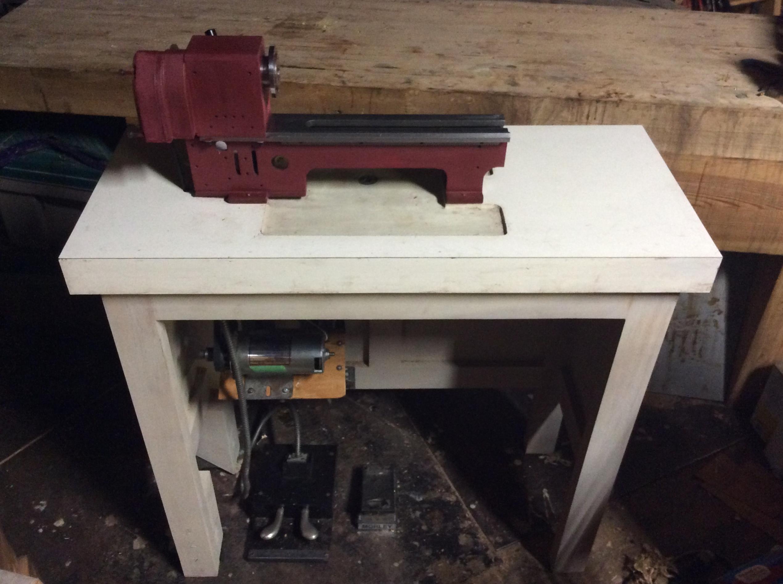

Little Machine Shop sells metal stands for mini lathes. They look alright but I think they’re really short.
I upgraded to a 7x16 lathe and made this bench for my now secondary and partially stripped 7x10 so I can keep things kind of clean and stable, and still be able to move it out of the way when I don’t need it.
The new bench is about 40x18”—two thirds the size of the old one that the new lathe is on now, but bigger and 4 1/2” higher than the LMS stand, at 39”. It weighs the same as that does not counting the motor and drive.
Attachment 23838
Finished
Attachment 23839

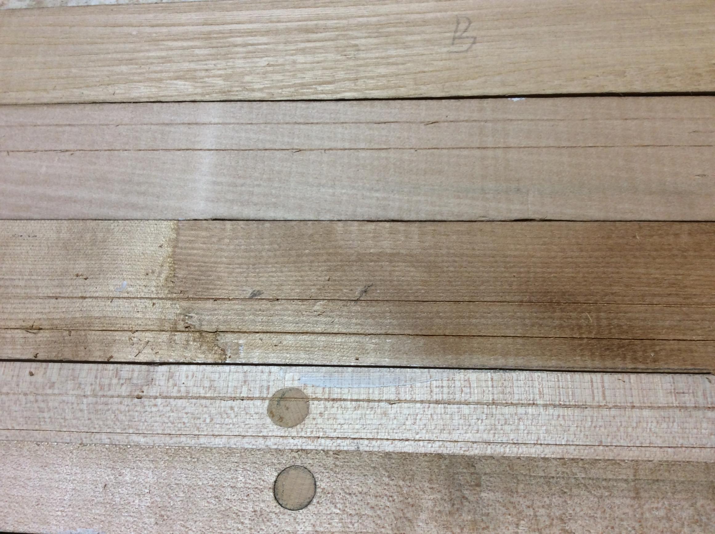

Select hardwood
Attachment 23840

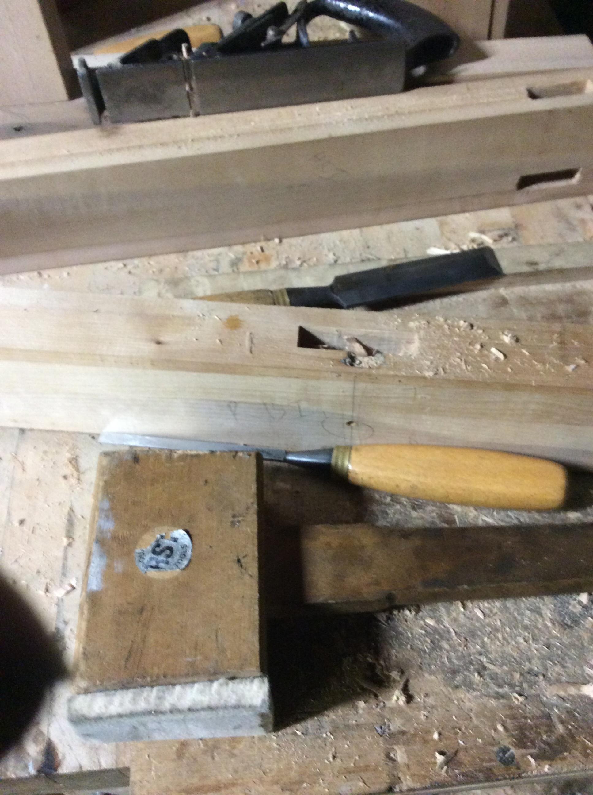

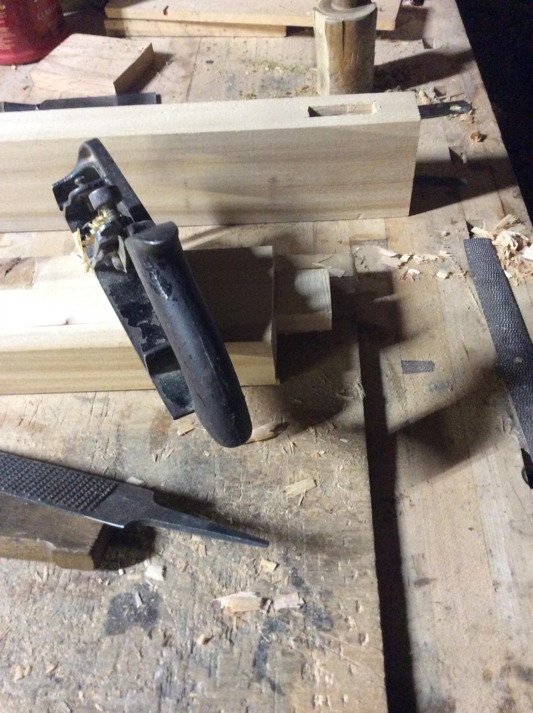

Mortise...
Attachment 23841
...and tenon

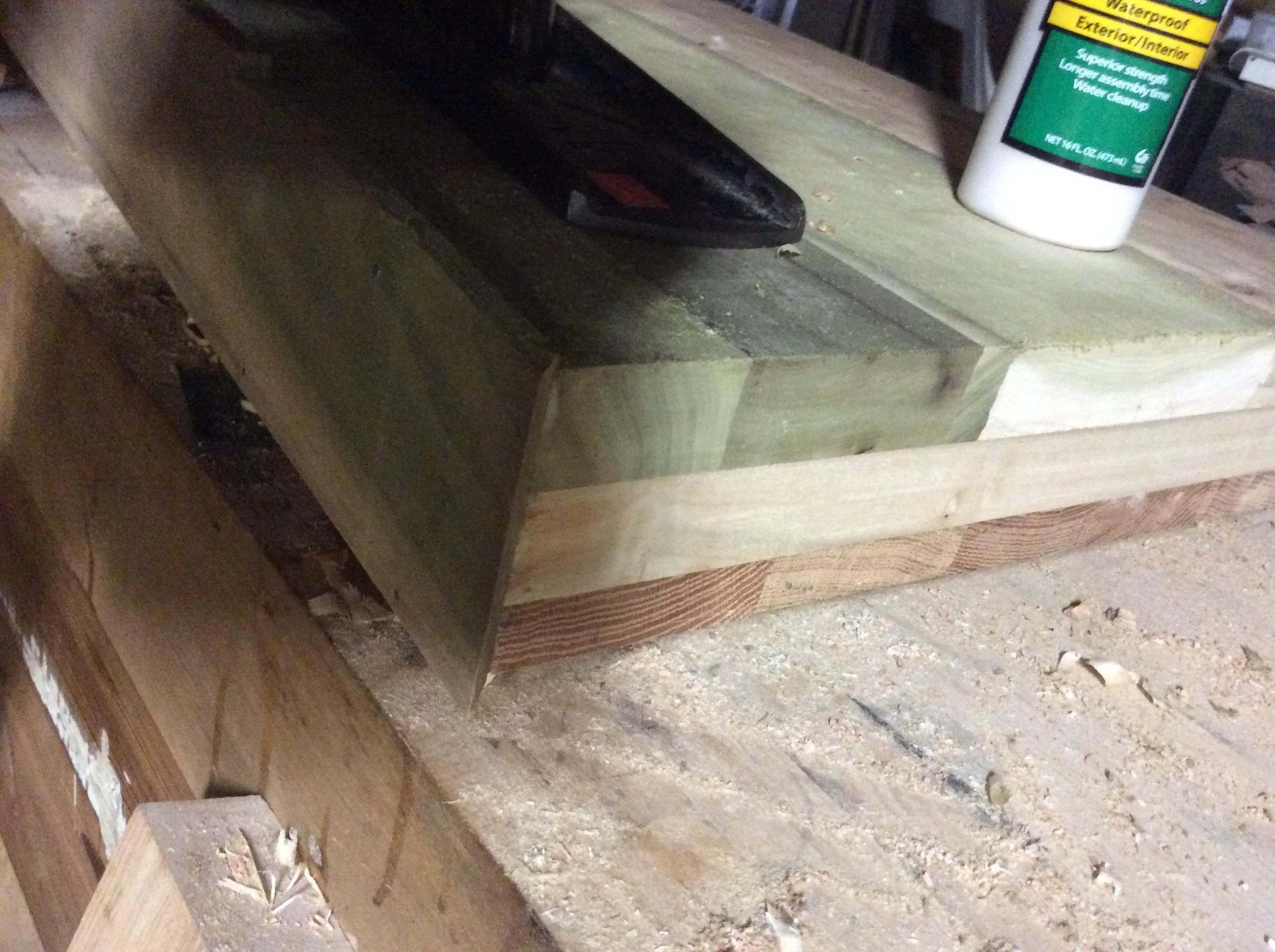

Attachment 23842

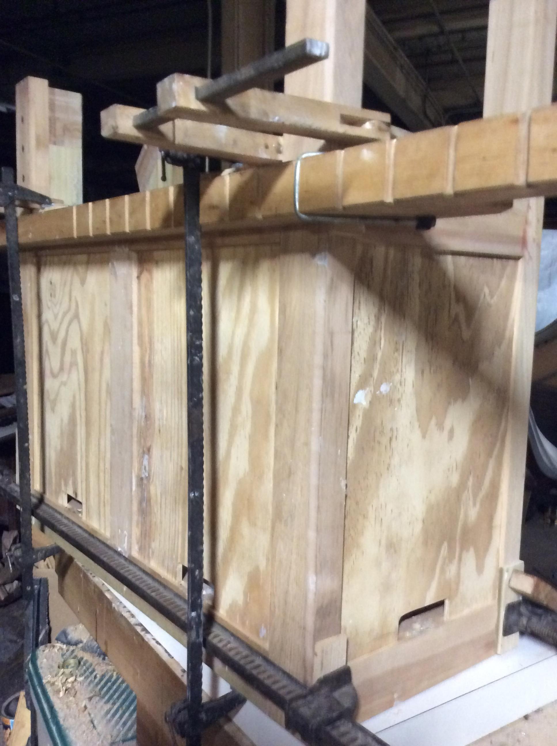

Upside down base...
Attachment 23843
...and upside down top
Attachment 23844

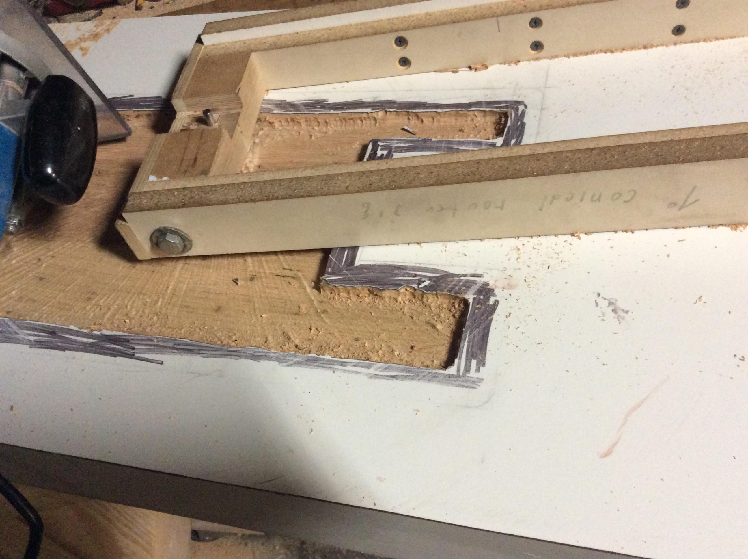

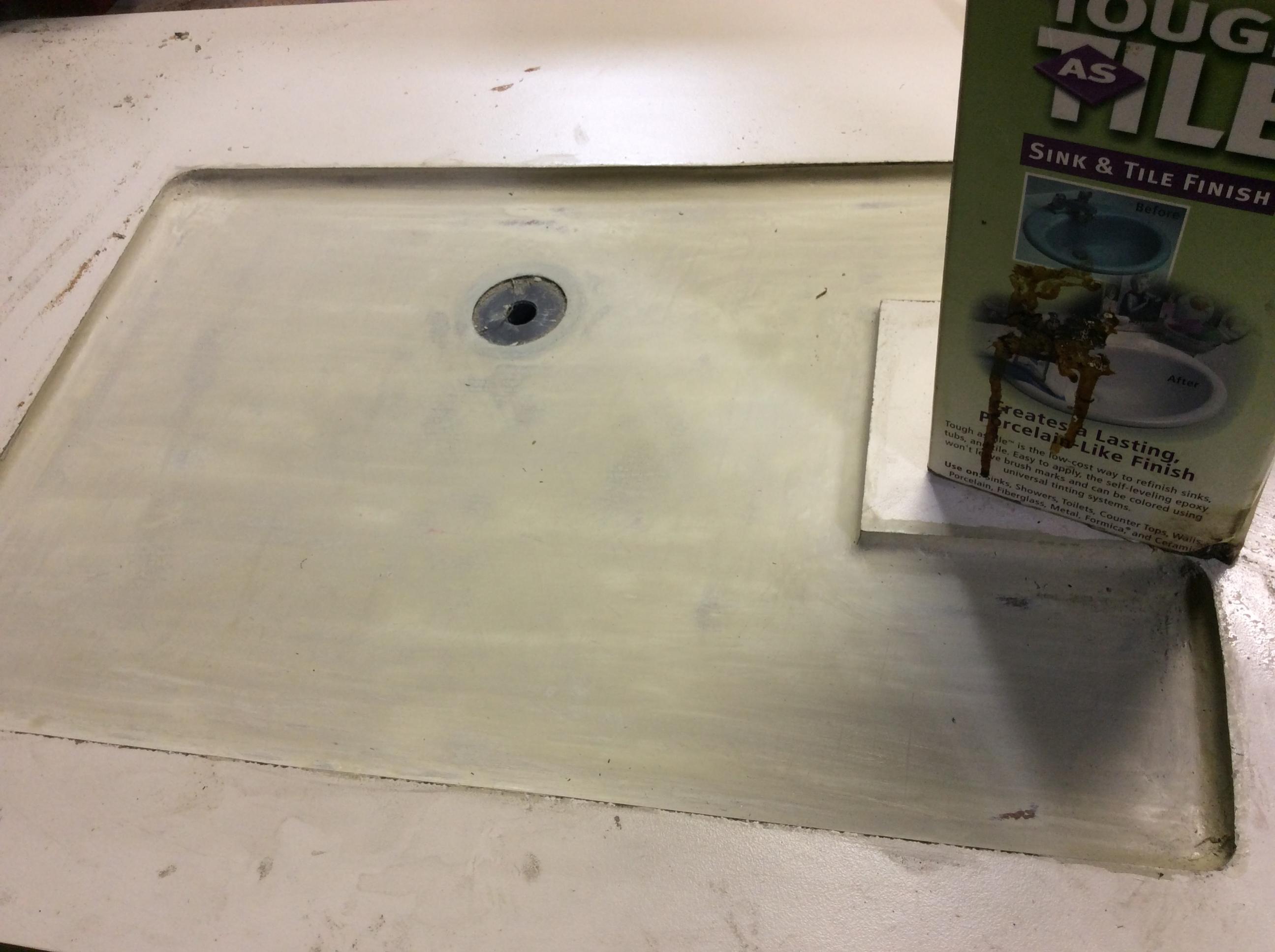

Routing the oak top layer...
Attachment 23845
...for a drain

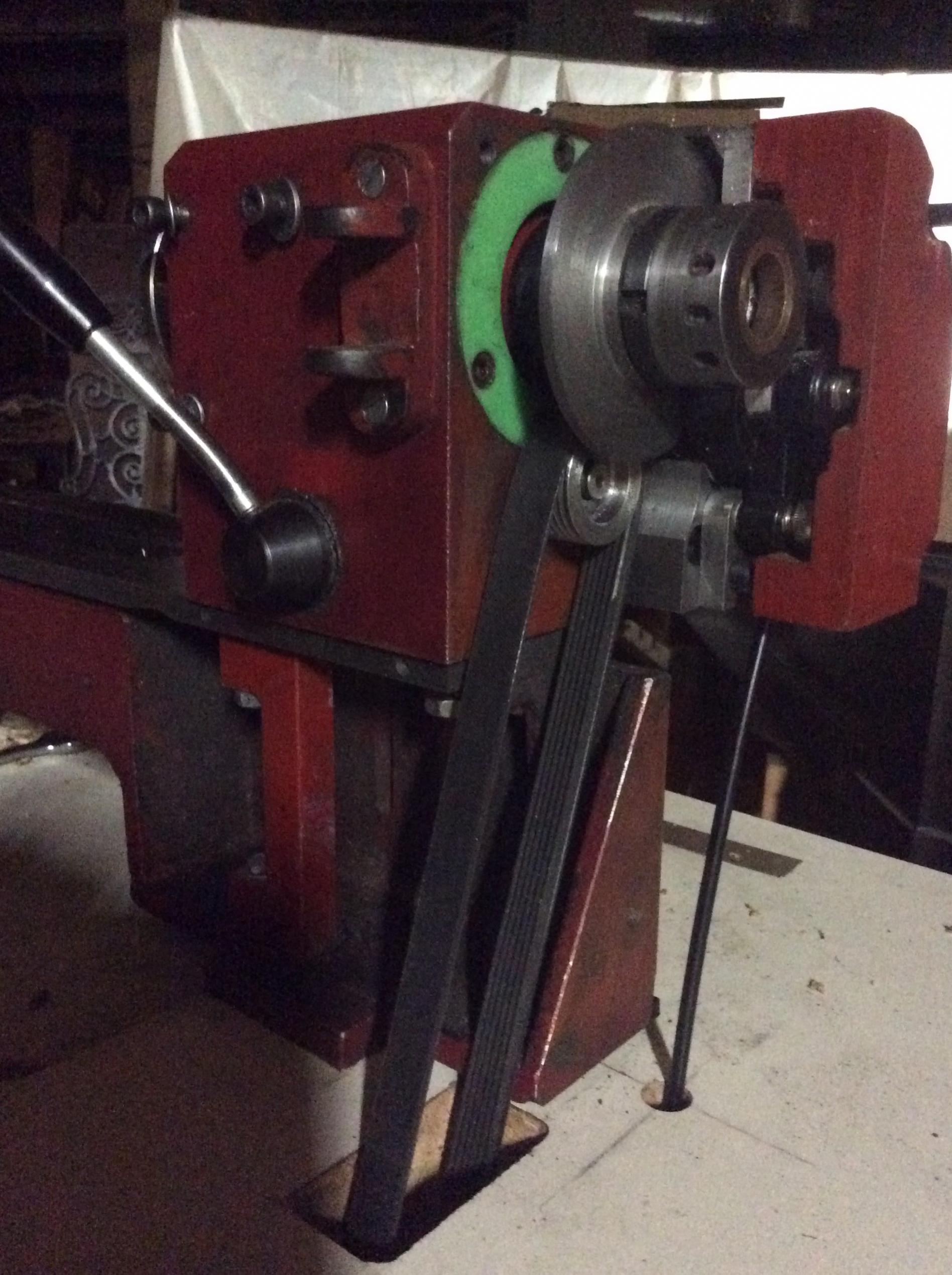

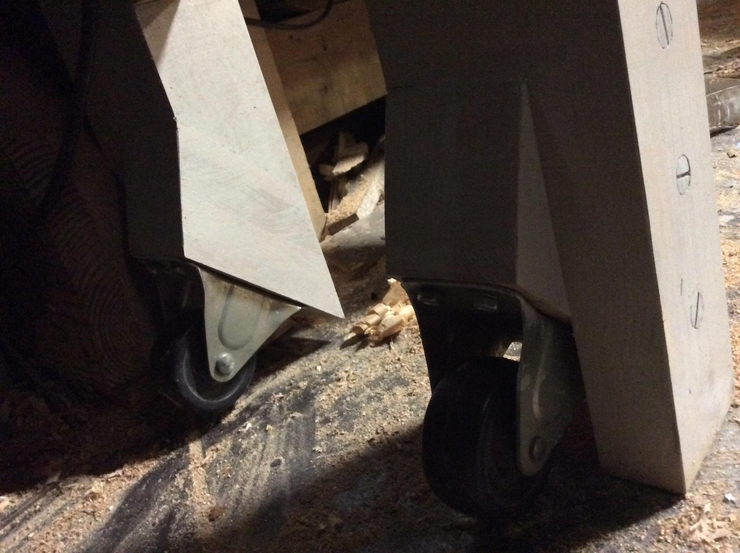

Attachment 23846

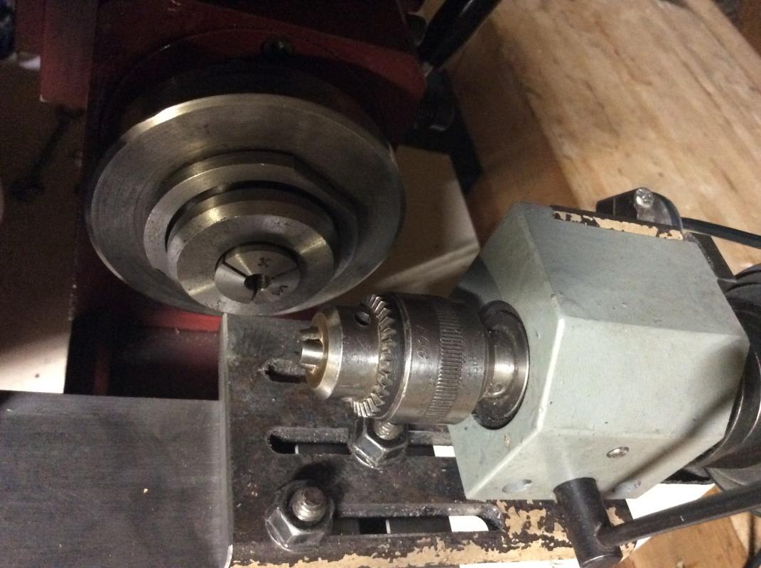

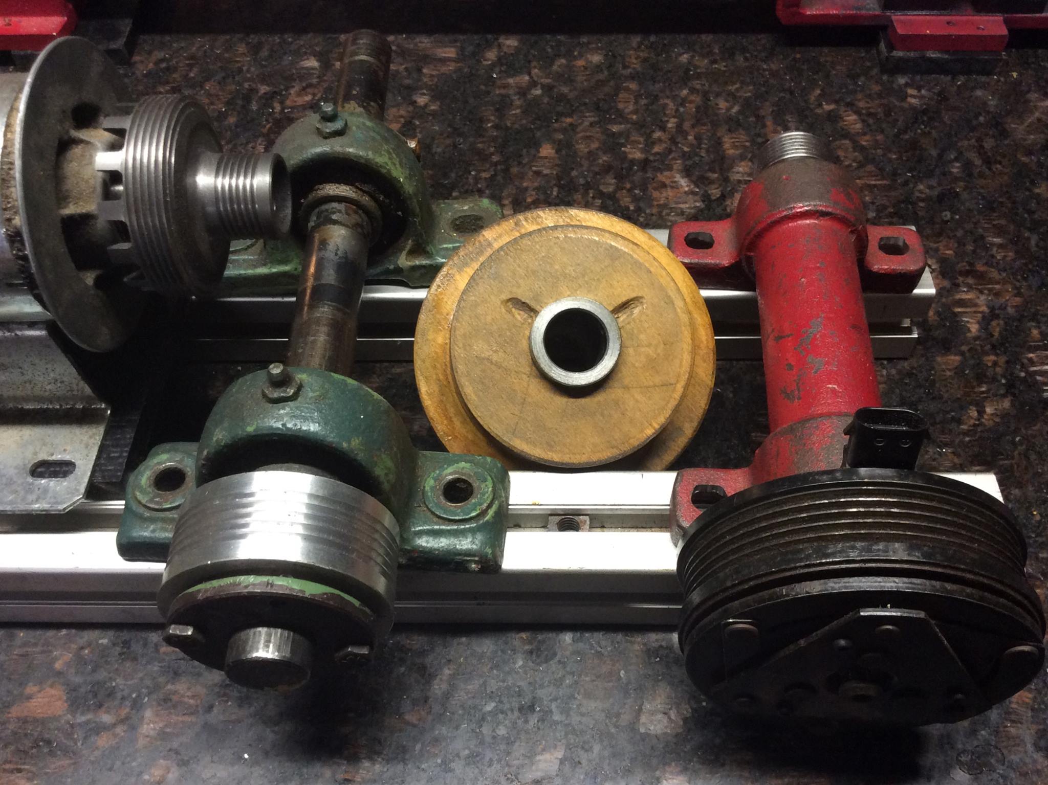

Wheels on the headstock end...

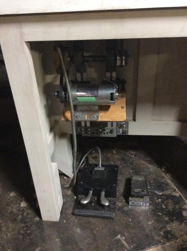

Attachment 23847

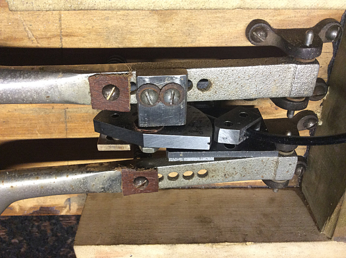

...and brake, clutch and accelerator pedals in front.
