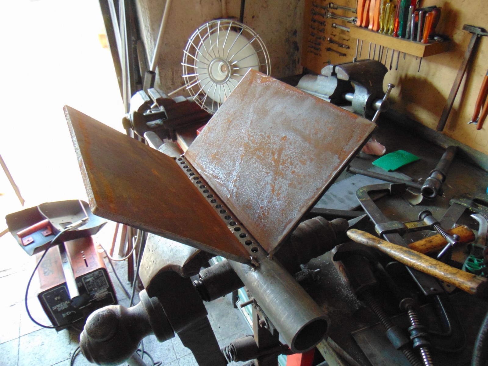

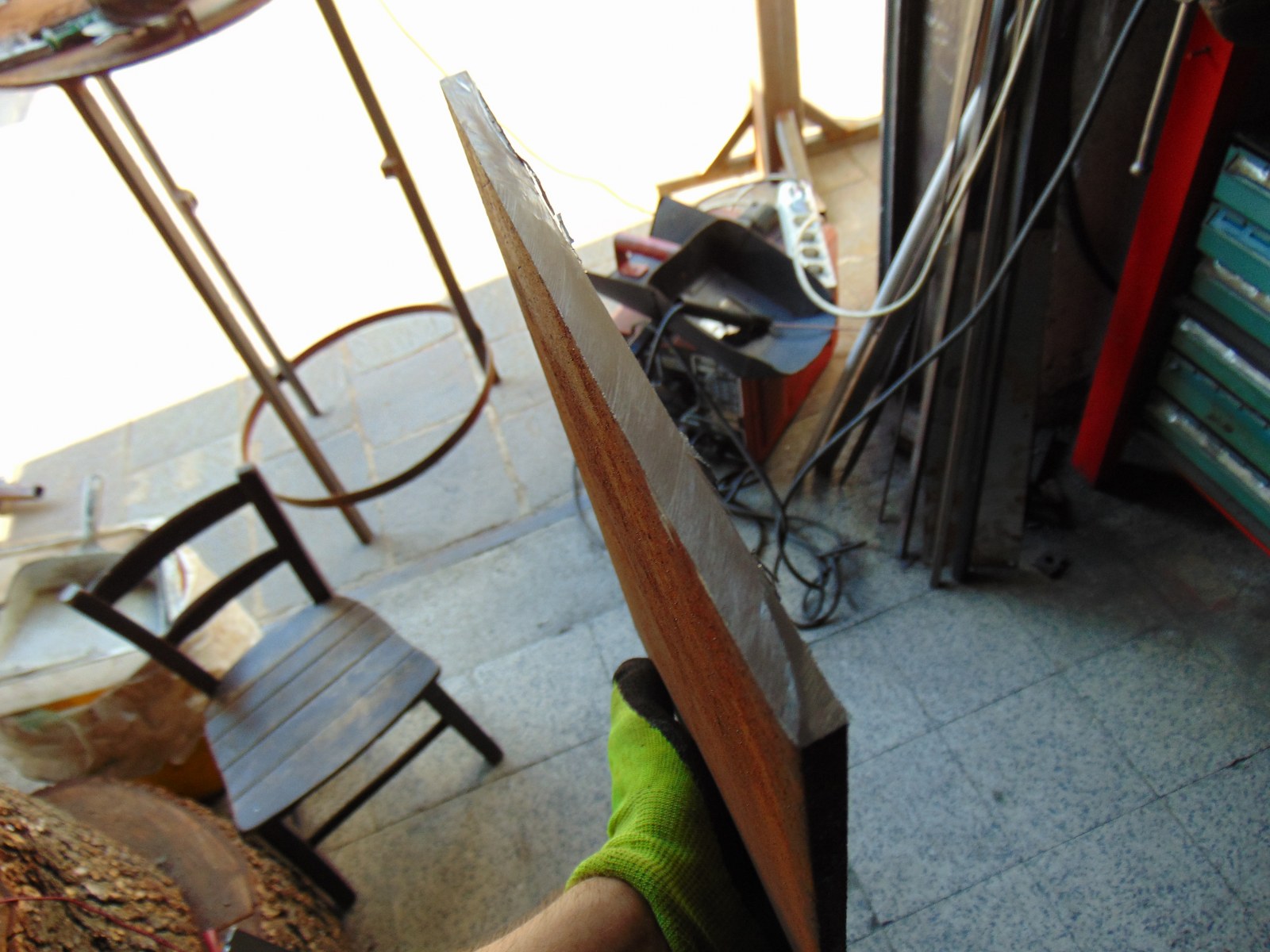

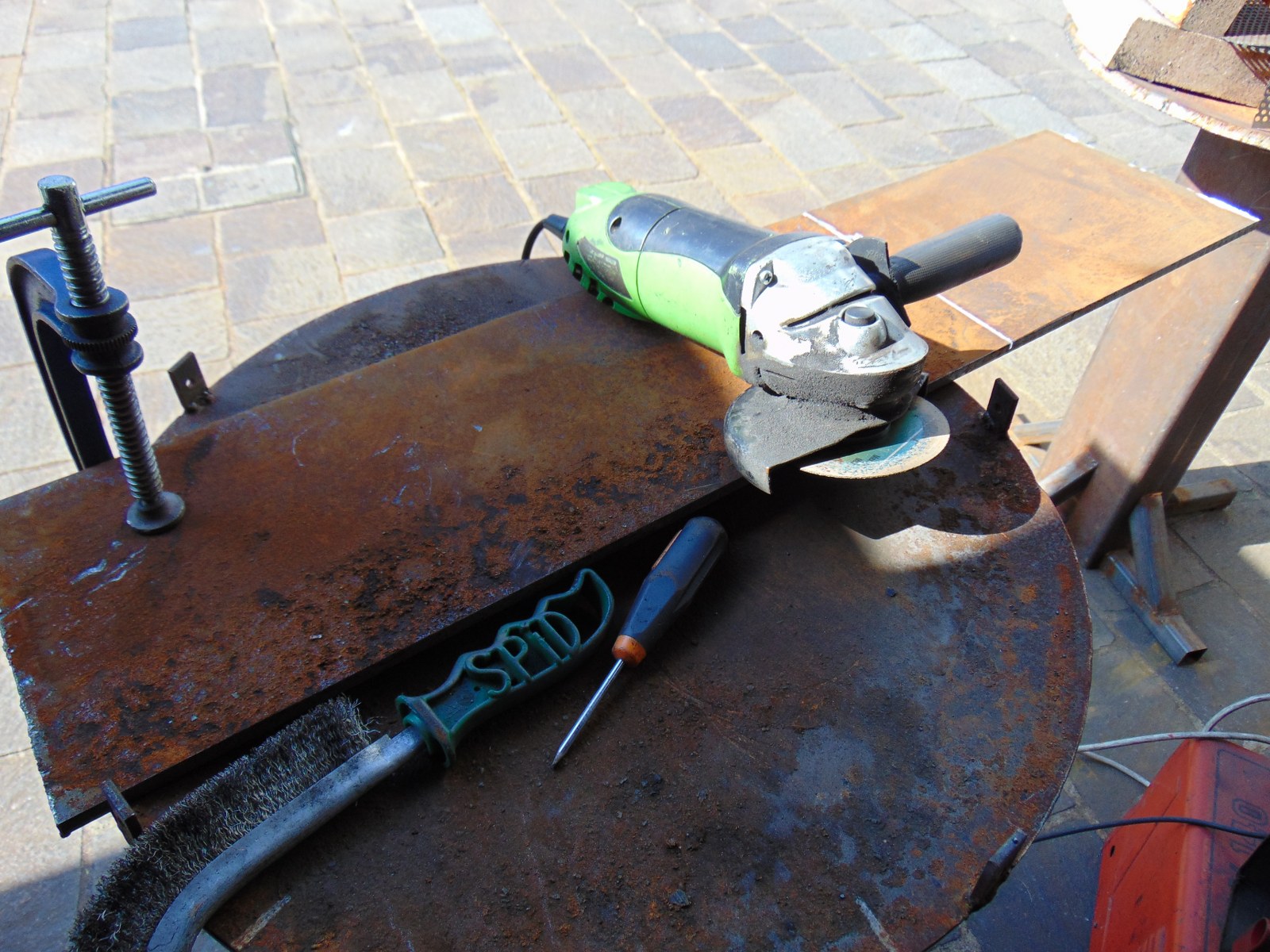

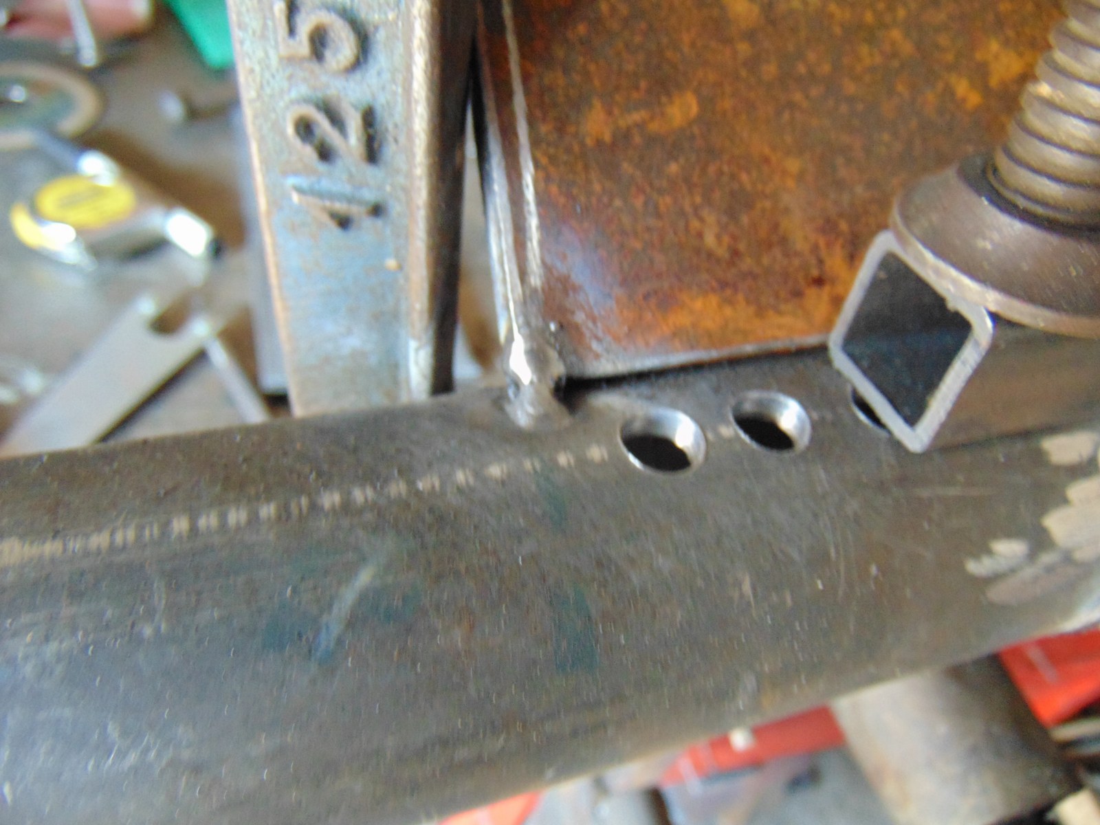

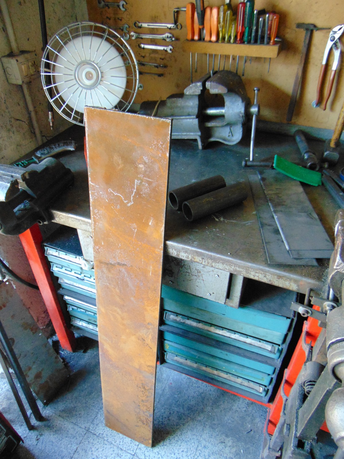

    Hi all!
    I'm trying to build a better forge, compared to the previous one that used too much solid fuel.
    The ballot was between normal type and V-type, I found this model to study Whitlox Wood-Fired Forges
    To be honest I don't like so much the light frame, it's insulated with firebrick and fiberglass, I think it's not practical to use and clean with coal or charcoal. It's interesting the regulation of air intake, my idea is to use a long rod to close the holes not used, easy to setup and to clean after use.
    I draw the air valve on my steel table , basically an aluminum portcullis that drains the flow to the air, with an horizontal knob fast to tune.

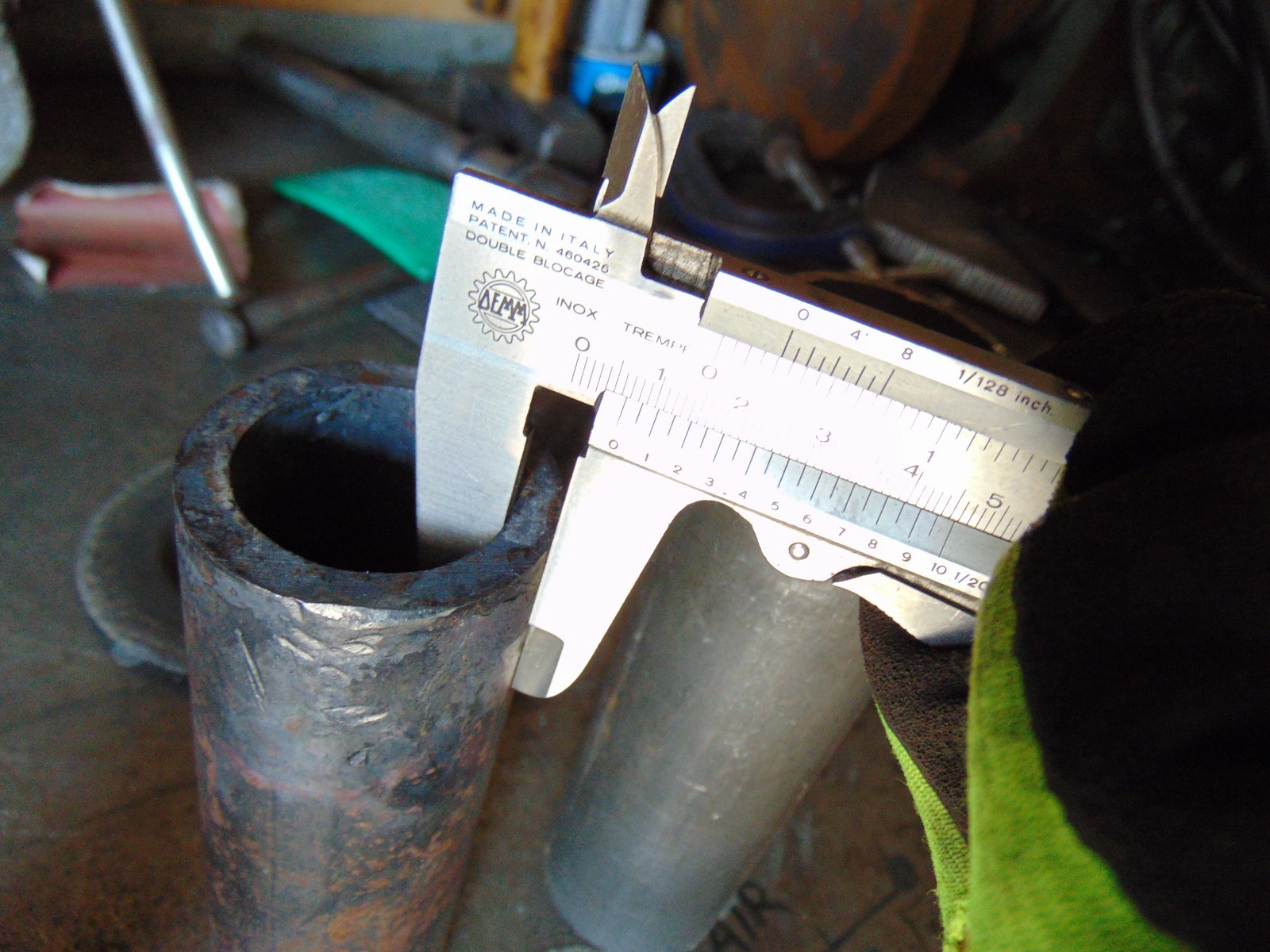

    Fireplace lenght is 30cm (12"), 20cm (8") width for the sides, thick 10mm.
    Air intake is composite, the central tube is double thick, about 6,5mm, the zone most used, I think
    As usual, stick welding.
    Some pictures

    Pressure of gas in Italy is close to 0,04 bar, you're right, but I don't want to use gas in my forge because it's not practical for my use, it has to be easy to move.
    Coal will be the fuel, the tube drilled is only for fresh air coming from the electrofan. I hope I got the size of holes, I got few experience with forge and solid fuels. The gate valve is far from perfection, lot of turbulence and reflections, but at least the flow is controllable due to generous size of the gate.
    Unluckily I will have to setup the flux at first power on, maybe I will change the holes, since I really don't know how much air is needed, I have to wait until it's over

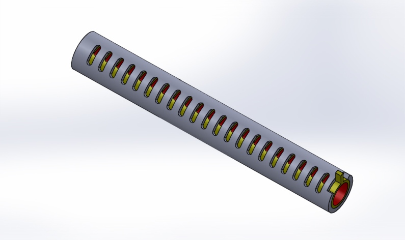

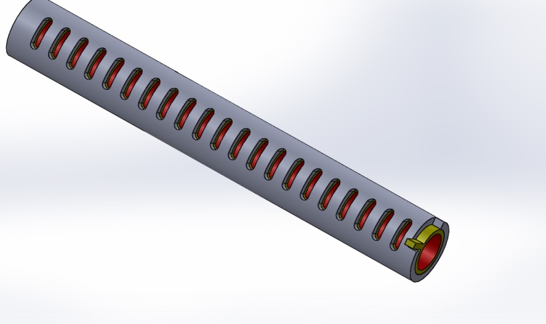

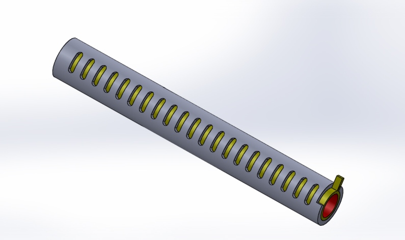

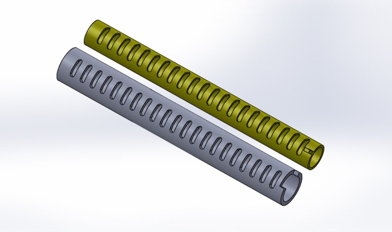

    When the need to control air flow in a long forge such as yours I might make this suggestion
    make 1 tube to fit inside of the other as it appears that your are doing then instead of having just round holes turn them into slots they will then become a variable venturi allowing for maximum flow to be evenly distributed under the entire length of the fire For the times when you find you only require a smaller shorter fire you could have an additional solid or plugged cylinder inserted from the opposite end of the valve which could be slid in or out like that of a child's Kazoo or it could be open ended and be the supply tube this would require capping one end of the inside tube
    Here is a quick design I drew up without a third tube
    New forge V-shape-vairable-lineir-valve.jpg New forge V-shape-vairable-lineir-valve-1.jpg New forge V-shape-vairable-lineir-valve2.jpg New forge V-shape-vairable-lineir-valve3.jpg

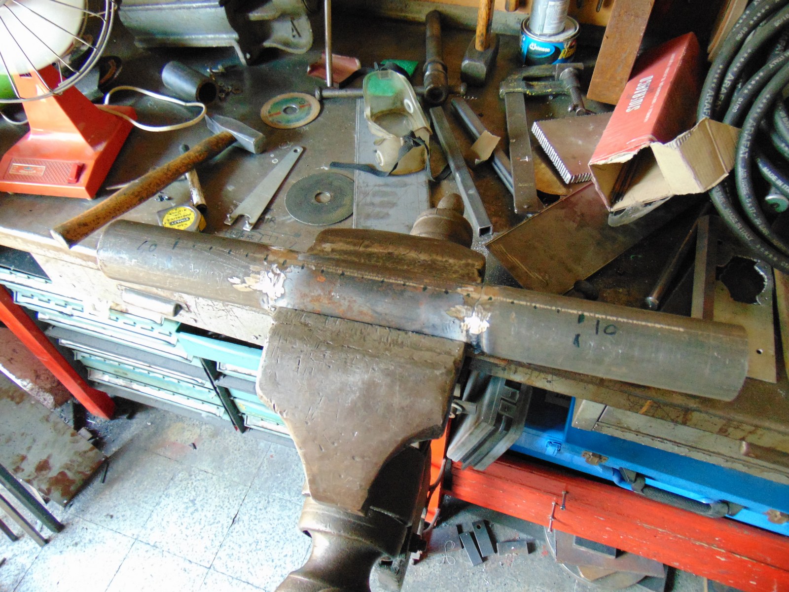

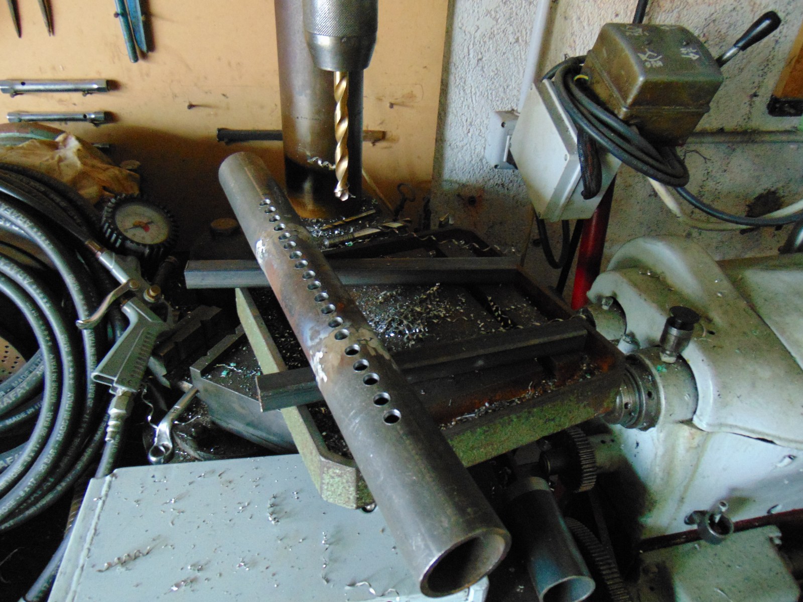

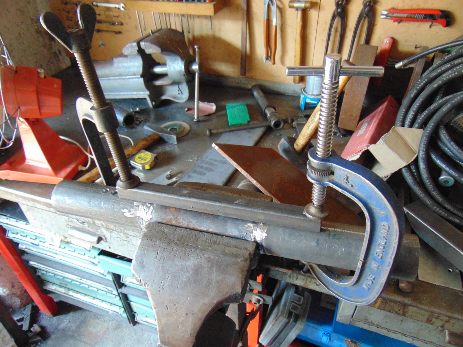

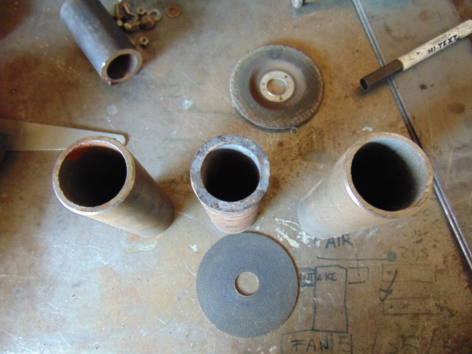

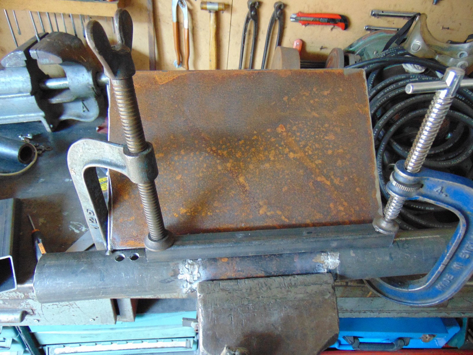

    Thanks for the advices!
    Frank and Toolmaker you're a great source of good info!
    I will keep the advices for a next forge, now I have different internal diameters and a tube plug , for sure, not fits perfect. Certainly it was a very good idea to use this system, making slots and regulate the flow of each part, more the possibility to make a waste gate and check air! It sounds like a well enginereed forge! ...Unfortunately I acted before asking
    Do you think I should dismantle and rebuild?

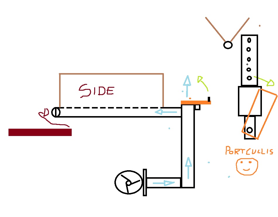

    Sorry for the bad drawing with paint
    The end of the drilled tube is opened, the round bar (bordeaux) is sliding so I can enter with a metal brush for cleaning, I hope! The other side is welded or kept with the screws and it's the air intake. I want to put the fan under the forge, at half meter, in order to keep the encumbrances contained
    that's more or less the schemati c

    I like the design of your tuyere as a whole with the holes in the pipe as you have made it. And upon doing further research not just relying on my own intuition.
    Looking at how you are planning on inserting the bordeaux to create a smaller area for when you only need a small flame is much like the drawings I posted sans the bordeaux I believe my design would allow for a much higher air flow but I was reading that it is not always the amount of air but the amount of positive pressure for a given volume. With the rotary type valve the pressure could more easily be regulated with or without a waste gate.
    In your design with the waste gate you may be able to achieve the same results only time and fire will tell us
    I think though that instead of mounting the blower at the bottom of the tuyere it might be advisable to mount it about half way up and provide an additional clean out at the very bottom
