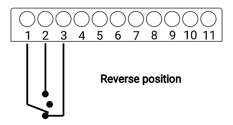

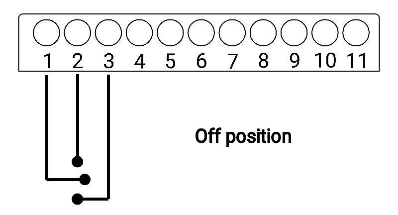

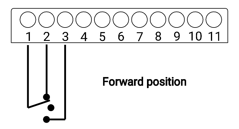

For now I've set the VFDs parameters to match the specs of the old motor, though I'm going to be playing around with various switches and the manual inputs to find interesting ways of controlling the saddle a little later on.
https://s3-us-west-1.amazonaws.com/f...e/100012-2.jpg
After setting up the drive, I made a quick and dirty manual control panel out of a short piece of galvanised right angle, bent it downward a bit to make it more comfortable to use and then installed it next to the MEM starter box that's the safety disconnect between mains power and the drive.
