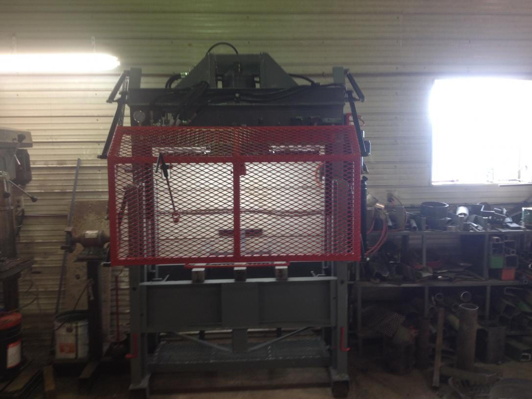

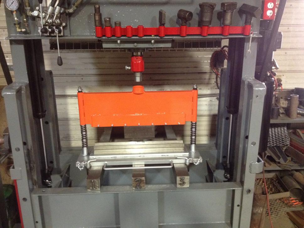

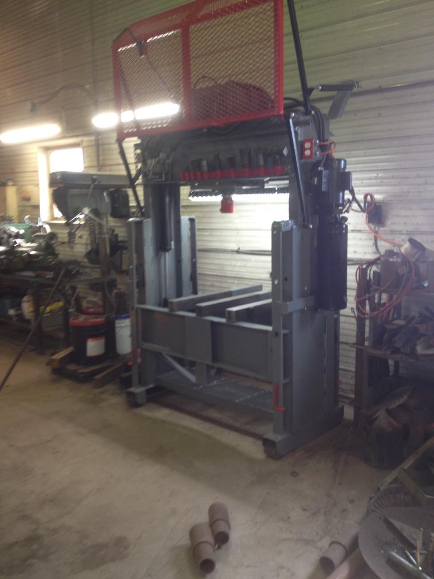

    Hi my name is Chris, we farm in saskatchewan,Canada. currently crop around 5000ac and have 100cows. Myself and my dad both worked as welders/machinists as winter jobs for 10+ years. Do alot of our own repairs and fabrication. here is some pics of a few recent projects. Press , bought from a closed welding shop 10yrs ago, finally got aroun to rebuilding it. new hyd's, hyd bed raise/lower, saftey cage, bed reinforcements and new paint
    24" press brake, 4way bottom die, couple different top dies, bottom plate is 1", top plate is 1 1/2", BB chevy valve springs fit perfect over 1" OD
