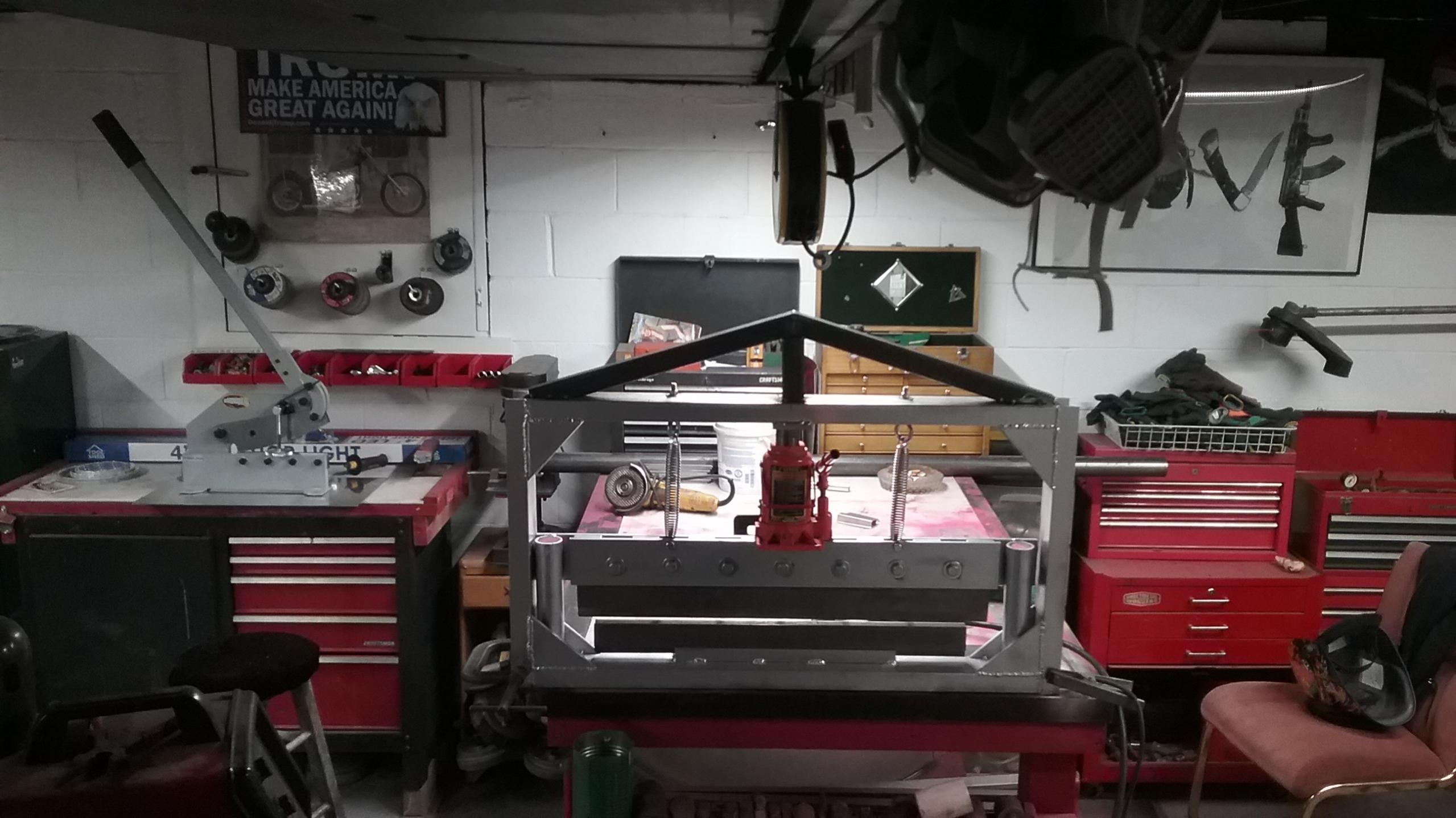

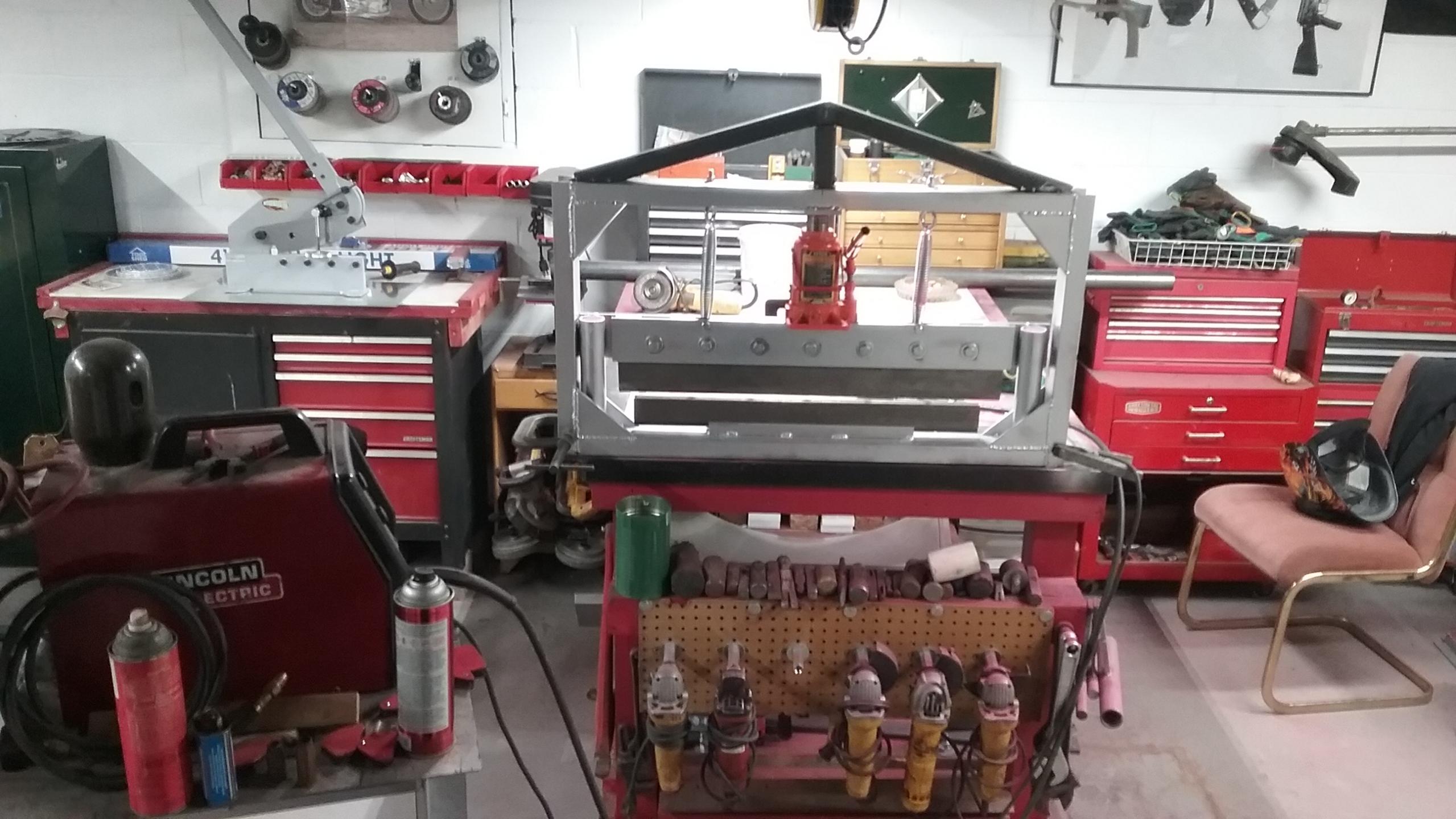

I added on a truss system today to distribute the force of the jack. I still need to weld it out. Making progress.
Attachment 22539
Attachment 22540
Hopefully this picture is better, my laptop is down so I'm using my phone.
That looks much better is that 1 1/2" sq tube 3/16" wall thickness? ASTM A500 B is the most common structural tubing having a tensile of 58,000. PSI should do nicely even 1/8" wall thickness might be enough with enough weld area. Either way a lot depends on the butt weld in the center, a strap there will help. Looking good though.
Yes sir, that is 1/2" by 3/16thickness tubing. I'll add a strap as well next weekend. I still need to add a back gage and a lowering stop. Plus, I think I need to build a table for it. Its getting there.
