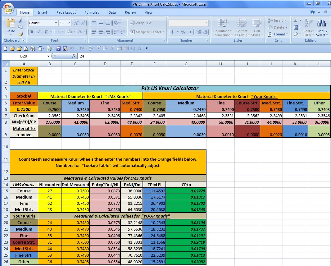

    Knurling is one of those tough things to learn when starting out. For me it took several months to get to the point of making "Good Knurls" consistently. I developed this Knurling Calculator along the way and it has evolved now to this "Online" version that anyone can use. It's been tried and tested by at least 30 people with skills well above mine, plus my rigorous testing. It will calculate material sizes from .1-7" and also give you how much material is needed to be removed to start your knurling process.
    I can say with confidence that this works with any knurling tool because it is based on the principle of an integer relationship of material size to knurl wheel diameter and number of teeth on the wheel. However, you will need to measure your wheels and count teeth, then enter the data in the appropriate fields along with your material size. Then the material size to turn to will automatically be displayed in the appropriate upper section. Keep in mind that only the "A6" & "Your Knurls" fields are left unlocked so as to prevent misplaced data from messing with the functions I have written in to it.
    I have also include a Metric Knurl sheet which has some metric knurls in it and have left enough room for lots of other Metric brands and sizes.
    I ended up writing quite a dissertation about it on my website starting with the basics and going through all the types and finally "My Method". So for the Newbies like me I would start there so you understand the fundamentals, remembering that just because you have a coolmacool spreadsheet doesn't mean you'll get "Good Knurls"!!
    I do hope this helps others as it was quite a vigil for me to get to this point!
    Enjoy and Happy Knurling...~PJ

    Thanks for this excellent info PJ. Much appreciated. I always have trouble getting knurls consistent and maybe this will help sort out the mysteries!
    By the way, I'm thinking of buying (or making) a cut knurler for my QCTP as I've read these are the most efficient way to cut and the easiest on your lathe when knurling. Have you used one? Cheers, Bill

    Thank you PJs for the link to your very informative web pages. I prefer the scissor-type knurling tool over the bump kind only because I can produce more consistent knurls with this method. I improved my scissor knurling tool by putting the adjusting nut at a safer distance from the lathe chuck (see Homemade Knurling Tool Improvement). I will using your spreadsheet for my next knurling project. Thanks, Paul

    Thanks for the kind words, Bill. I burned through a bunch of salvage material to get to the point of consistency and to test the spreadsheet, all the other parameters...plus a lot of "fingering" . Practice, practice, practice.
    I don't have any experience with cut knurler's although have seen the results from a CNC using them and they were pretty spectacular. Love to see what you come up with and the results. ~PJ
