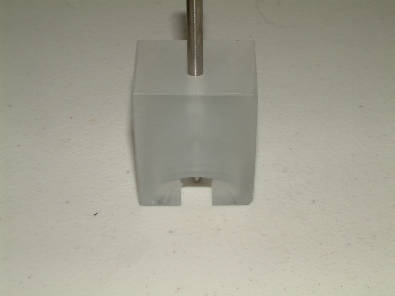

    Optical Punch Version 2.1
    Another minor mod to the optical center punch. I removed a small rectangle from the bottom of the punch. I thought the acrylic line at the bottom was interfering with the sighting in of the center punch. Just used a 3/8 emd mill and put in a slot down the back side and across the bottom. Left the base nice and solid so it does not tip over.

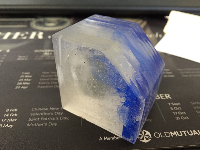

    I also had no ways of getting a block like that, but I have lots of old number plates I have gathered over the years, so I peeled back the sticky backing with the numbers and glued about 20 off 50 x 50 pieces that I cut from the number plates together and this is the result.
    I take it it needs a fairly fast speed in the mill. I have never worked with is stuff.

    Now that is a great way to get a block of plastic.
    I don't remember the speed I used but it was not real fast.
    In my case I step drilled to 5/8" and then bored it to eyepiece diameter.
    I would start out slow and increase the speed until it starts to melt!
    Then back it off a bit to prevent the plastic from melting.

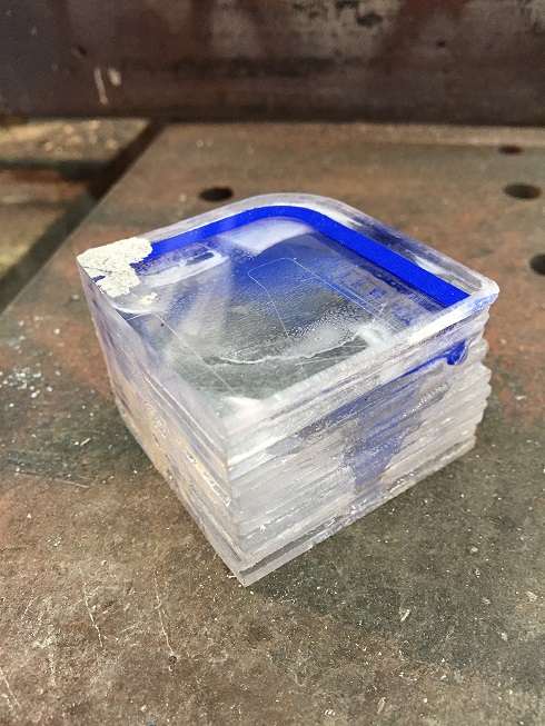

    Chose a brand new 10mm end mill and the mill was still set on 900 rpm. finish was good so stuck to it. According to that chart it was smack on.

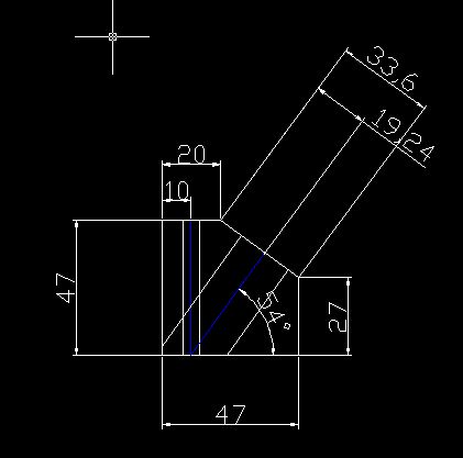

    Reading my mind... my next question was going to be how to get a 20mm diameter hole for the optic. Biggest I have is a 16.
    Just my sizes seeing I started with 50mm rough. It cleaned up at 47mm.
