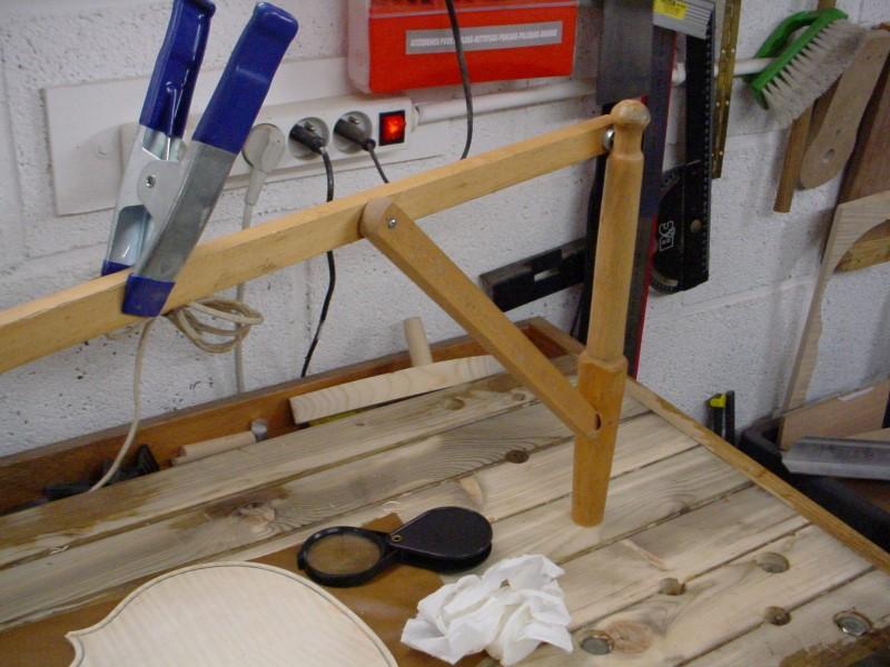

Here is strange gizmo I came up with visiting my scrap box.
I needed something that could serve as a third hand in order to hold different things over the bench, while I'm working with the other two (hands).
So I found in the scrap pile the relics of an old wooden sunshade. As I can never come to through out wooden pieces, this one eventually found a new life.
So here it is :
http://www.labellenote.fr/file/Woodw.../Portique1.JPG

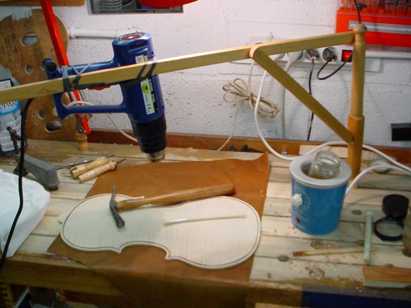

You can hold nearly what you want until it's not too heavy, but the reason why I wanted it is to hold the heat gun over the bench, while I'm gluing with hot hide glue. Keeping the work pieces warm gives you more open time.
http://www.labellenote.fr/file/Woodw.../Portique2.JPG
Note : the heat gun is fixed with a band of bicycle air chamber.
Next time, I will try to adapt the camera on it.

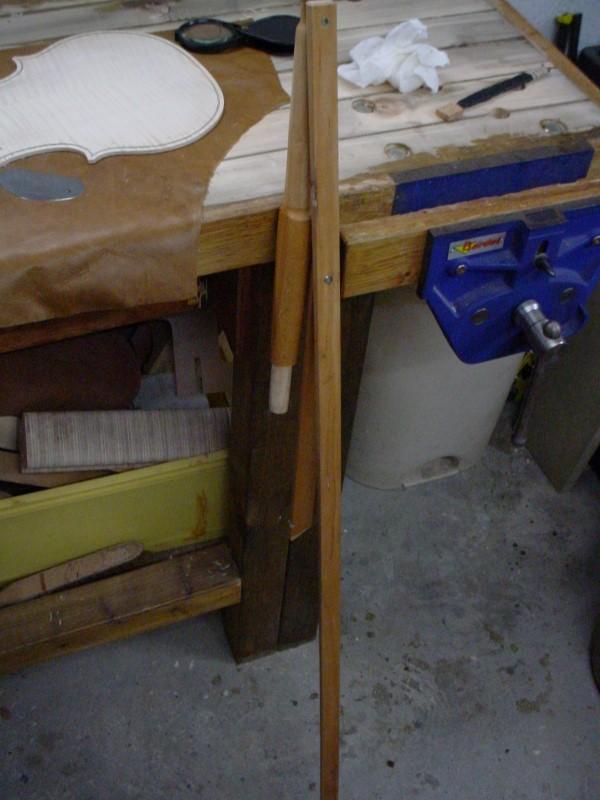

And the beauty of the thing is that : it is foldable and can be forgotten in a corner of the shop when not in use.
http://www.labellenote.fr/file/Woodw.../portique3.JPG
This is high tech... :cool:
Great job repurposing the sunshade frame. Can be swung in or out of the way. Collapsible to boot!
Great idea as usual, Christophe.
