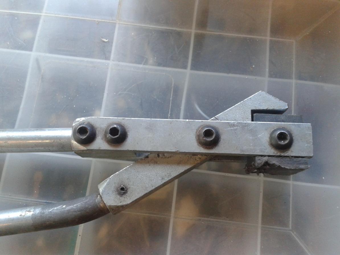

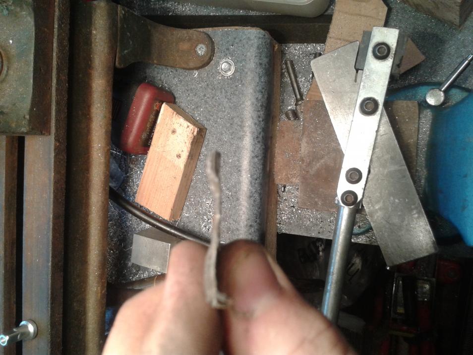

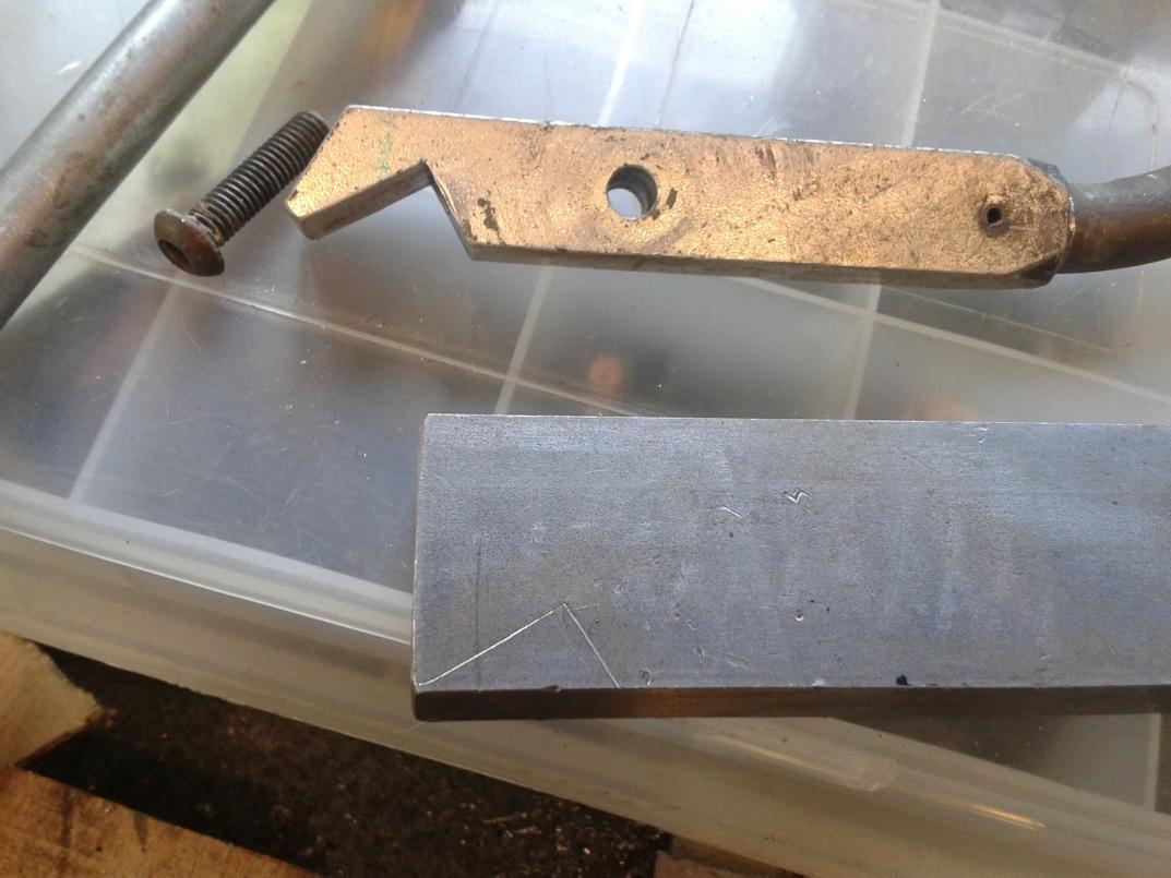

Hi this is my first submission on here although I have seen one of my jobs uploaded from the Instructable website.

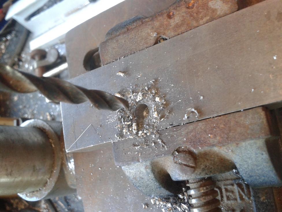

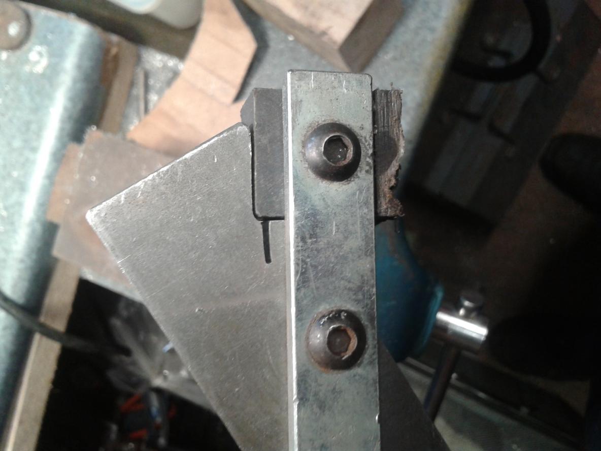

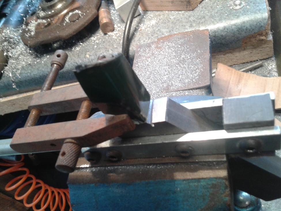

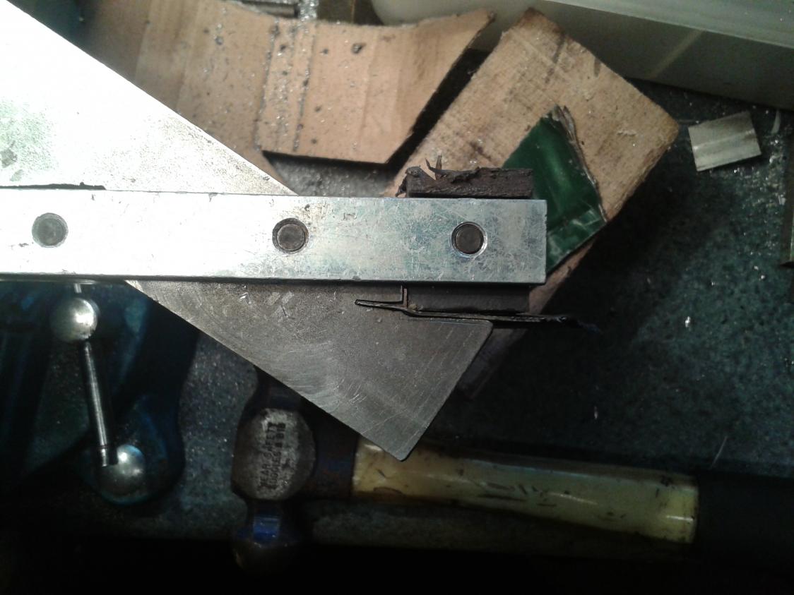

I have some new panels to go on my car and although I have welded several cars and bikes up before this time I wanted to overlap the panels for a better job and for that I needed an edge joggler I could have bought one but it's more fun to make having looke at several made using vice-grips I had a pair ready to go when I spotted my door skin edging tool and I decided to adapt that instead so the main arm part was remade to still fold door edges and with the beefed up block I used I could add a slot and reverse the nylon block and it was all good to go.
Attachment 994Attachment 995Attachment 996Attachment 997Attachment 998Attachment 999Attachment 1000
I know the slot isn't the straightest but it will suffice for this job I may comeback to it and change it a little.
