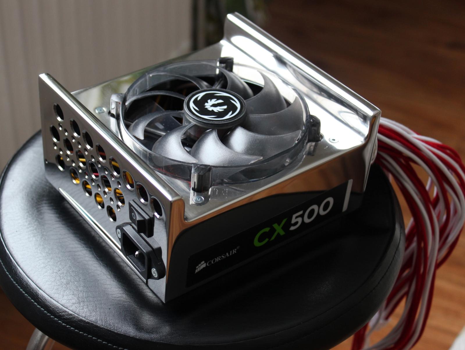

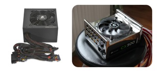

Wanted to get nicer look for my cheap psu.
Attachment 12266

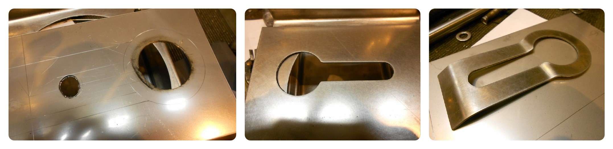

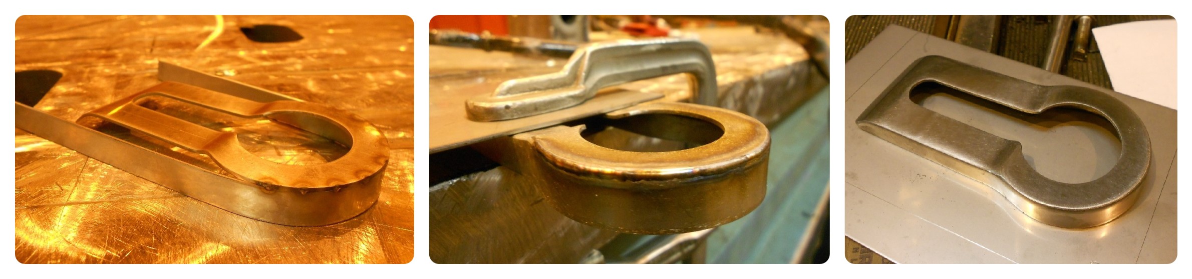

So i made new casing for it from stainless steel.

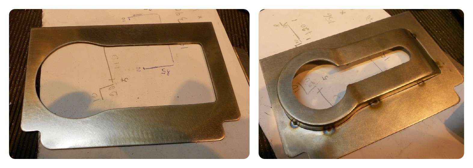

Used angle grinder and dremel for cutting.

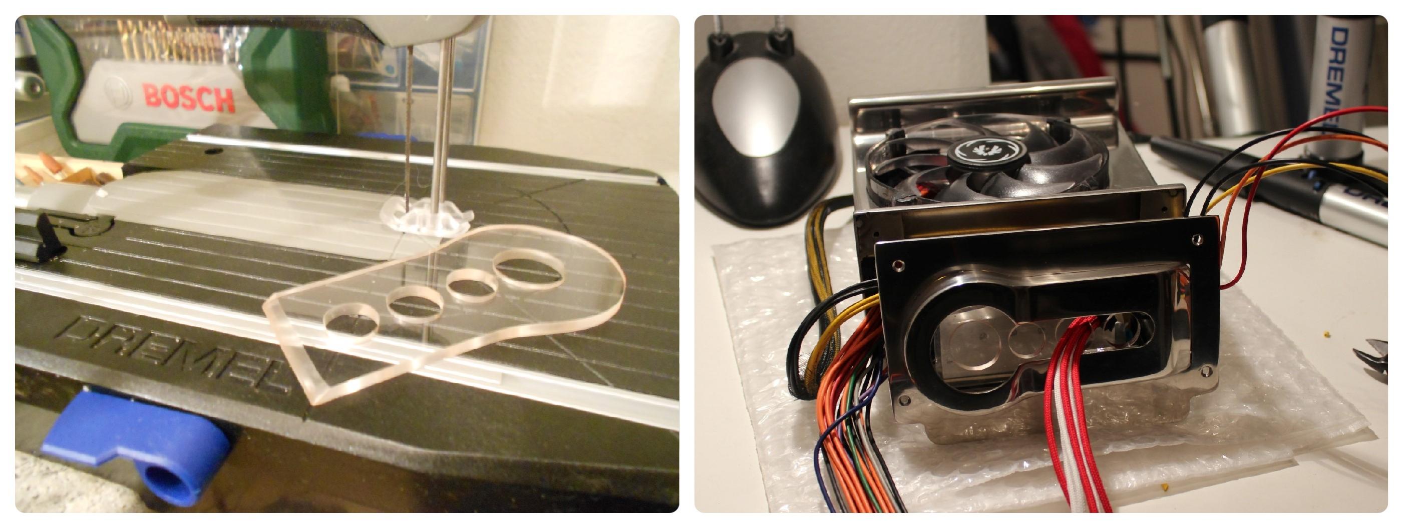

Holes are made with drill, bigger holes are largened with sanding drums and tungsten carbide cutters.
Used tig for welding.
Attachment 12267

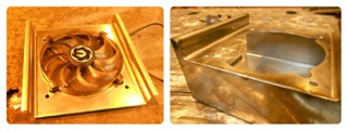

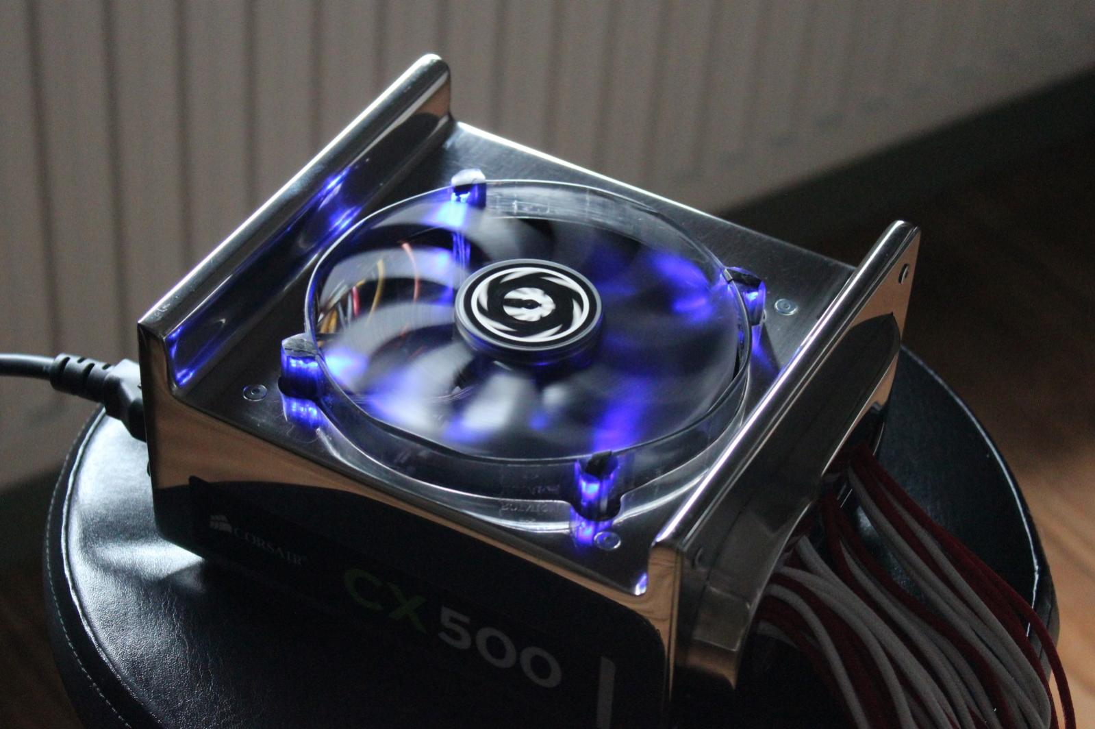

Fan is also re-shaped. Cut and grinded smaller.
Finally polished with wax and felt disk.
Attachment 12268
Attachment 12269
Attachment 12270
Attachment 12271

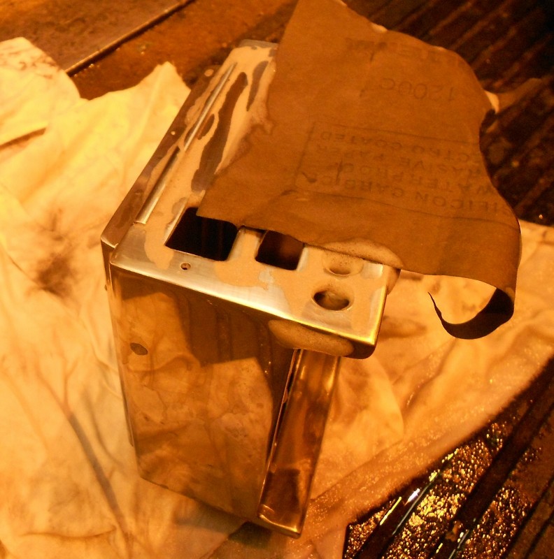

Wetsanded and rewired to get nicer look.
I also changed the caps for better ones.
