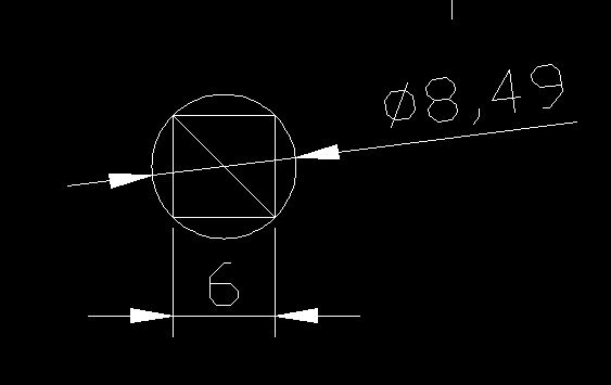

1 Attachment(s)
Great idea. Need one some 6 x 6mm HSS insert.
Small problem....need a 8.5mm Tap. Is there an imperial size close to 8.5mm Diameter.
Attachment 20993
The closest thing would be a 5/16" but at /312 that is only be 7.9mm the next size being 3/8" .375 would be 9.5 which would probably be the best size to grind square if using a corse thread tap there should still be enough of the threads left to do the cutting.
Going to try it with a M8 tap. Can not take too long to file out 0.25mm per side with a needle file.
Still fantastic idea.
Will this handle changing a 6mm Dia hole in a 12 x 12mm bar I want to use as a boring bar. Bright MS as it is only to open up a brass bush.

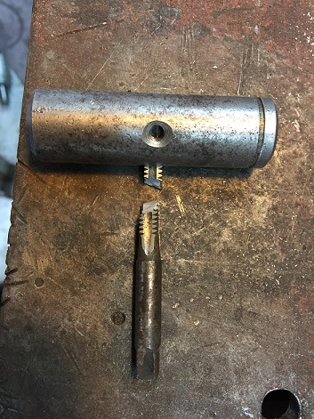

1 Attachment(s)
Don't try it on a piece of 22mm dia solid MS.
Attachment 21098
Fortunately I felt my little 5 ton manual press was struggling, so covered it with lots of rags and an old jacket so when it let go it was not too dramatic.
Ended up just filing it to square. Gave me a good start at least.
For thinner stuff I am sure it will work
