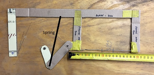

    So I have spent some more time on YouTube and found that one person added a spring between the crank and the frame.
    So as the crank goes down it puts tension on the frame. On the reverse stoke the crank raises and takes the pressure off the blade.
    Also a half scale mock up using plans received from Nelson. Seem to work quite well.

    The only thing you need to make sure of is that your motor is turning in the right direction. As the arm is down it pulls and the cutting needs to be on that stroke. Looking good, now it is time to make the real thing.

    Am going to use a wiper motor so 12V dc is easy to control direction.
    Any thoughts of using a pneumatic cylinder as a power source?

    You need a fair bit of power to run a hacksaw machine, a 12v wiper motor is not going to provide that and any motor can be reversed.
    I suppose a pneumatic cylinder is possible but that means you will have to run a compressor at the same time.
    Are you limited by your workshop equipment or just over thinking the project?.
    It will be interesting to see what design you decide on.

    Couple of improvements.
    Use Rod ends as bearings and orientate them in such a manner that they give me the ability to true up the blade once the machine is all built. We all know how quickly errors add up and then multiply it by a very long main frame member.
    When drawing up the machine using the original 5.5" stroke to see what to change to get a 10" stroke I realised that the longer I make the rear pivot frame (old engine con rods in the design) the less the blade was rocking and the more it started to move like a conventional power saw. So my drawing now shows the rear pivot frame as pivoting at the base of the frame holding the whole machine together.
    I am also questioning the wiper motor idea, but I have seen it on YouTube and it works. Not sure for how long..This machine will not be used for thin walled tubing. I think that type of profile will be a wiper motor killer, but as long as you have 50mm of steel in contact with the blade at any time and not tension the spring up too much I think it will last for the DIYer. If it fails it is an easy conversion to the more traditional multi pulleyed reduction design.
