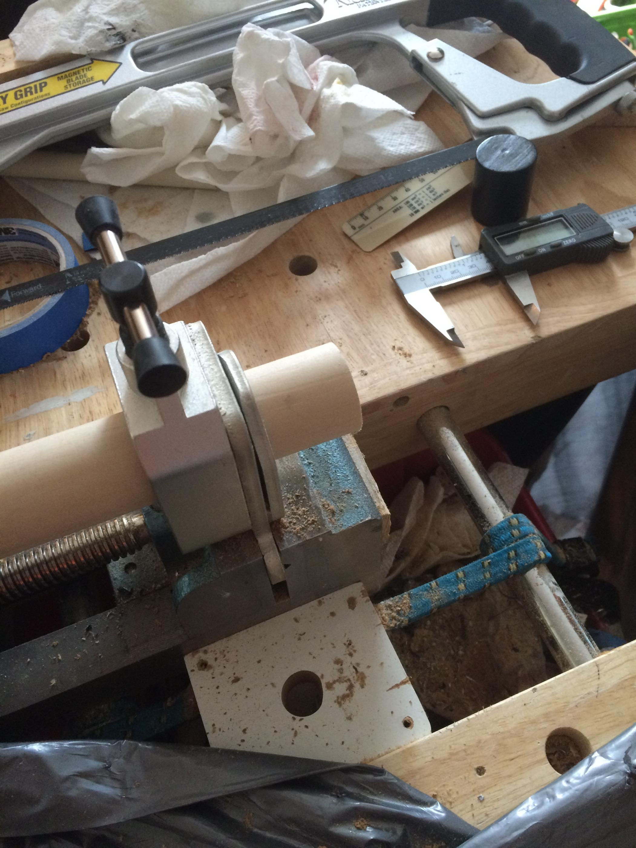

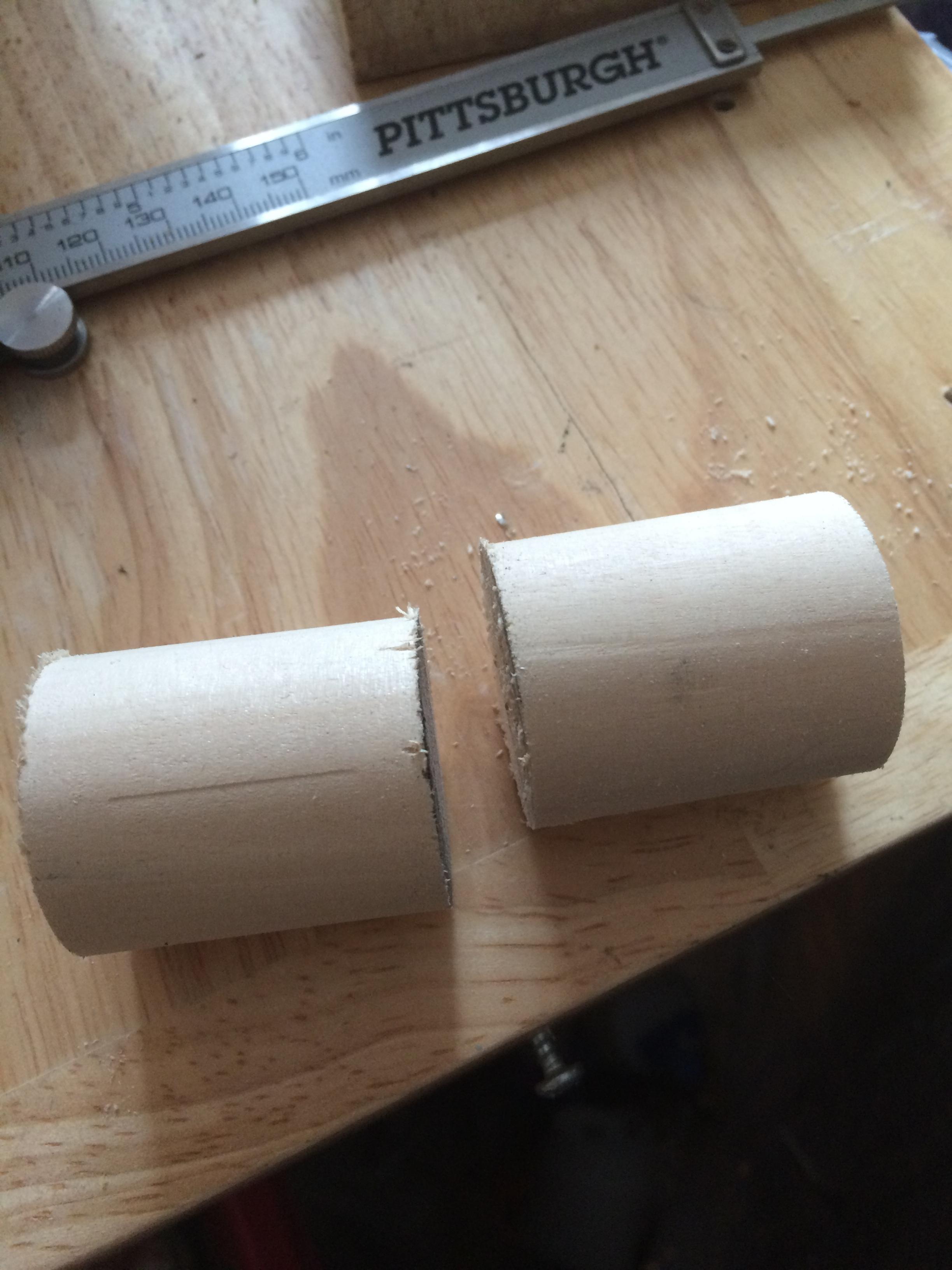

You can use a bicycle tube cutting jig that mounts on a vise for cutting dowels up to 1.25 in diameter. The cut is precise and clean. You can order the tool from any online bicycle parts supplier. Tony
Attachment 10393Attachment 10394
