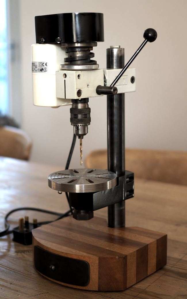

I have an Emco Unimat 3 lathe that I've had for a long time:
Emco Unimat 3 – glue-it.com
However, although the pillar mill/drill attachment is really useful it is a pain to keep converting the lathe between mill/drill and lathe. This got me wondering if I could buy another pillar on ebay and make a base and table for a permanent pillar drill.
Attachment 17384
The full article is here:
Unimat 3 Pillar Drill – glue-it.com
I've got a slightly more powerful sewing machine motor for it now and this also rotates in the correct direction so that it can hang down under the pulleys. The result is a tiny pillar drill that sits perfectly on the model making bench. Overall it is around 40cm high.

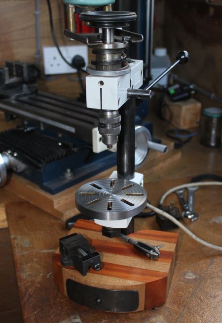

1 Attachment(s)
I've updated the Unimat Pillar Drill - the bracket that holds the table was never quite right with regards to the accuracy of the hole and so the table was not quite dead upright. So I filled the hole with Durafix and then machined the hole again in place on the pillar drill.
Attachment 28873
It's now absolutely spot on in terms of accuracy

editor@glue-it.com,
I own a couple of Unimat DB-200 lathes so I know what they are capable of doing.
I have not had a Unimat 3 in my hands, so I am wondering what diameter the post is? I am assuming it is larger than the DB post and therefore more rigid...
Could you tell me what the diameter is?
I've just measured all of the specifications:
Motor power: 120W @ 7000rpm
Ratios: 3.7:1 and 2.5:1
Spindle speeds: 1900rpm & 2800rpm
Spindle mount: 14x1mm
Spindle travel: 25mm
Throat: 64mm
Max chuck to table: 122mm (3mm drill bit max is ~85mm)
Dividing plate: 6, 8 and 10 holes
Divisions available: 1, 2, 3, 4, 5, 6, 8, 10
Table mount: 14x1mm
Column diameter: 28mm
Column length: 325mm
The column is 28mm diameter and never had a problem with rigidity of the column and have used this for gear cutting.
