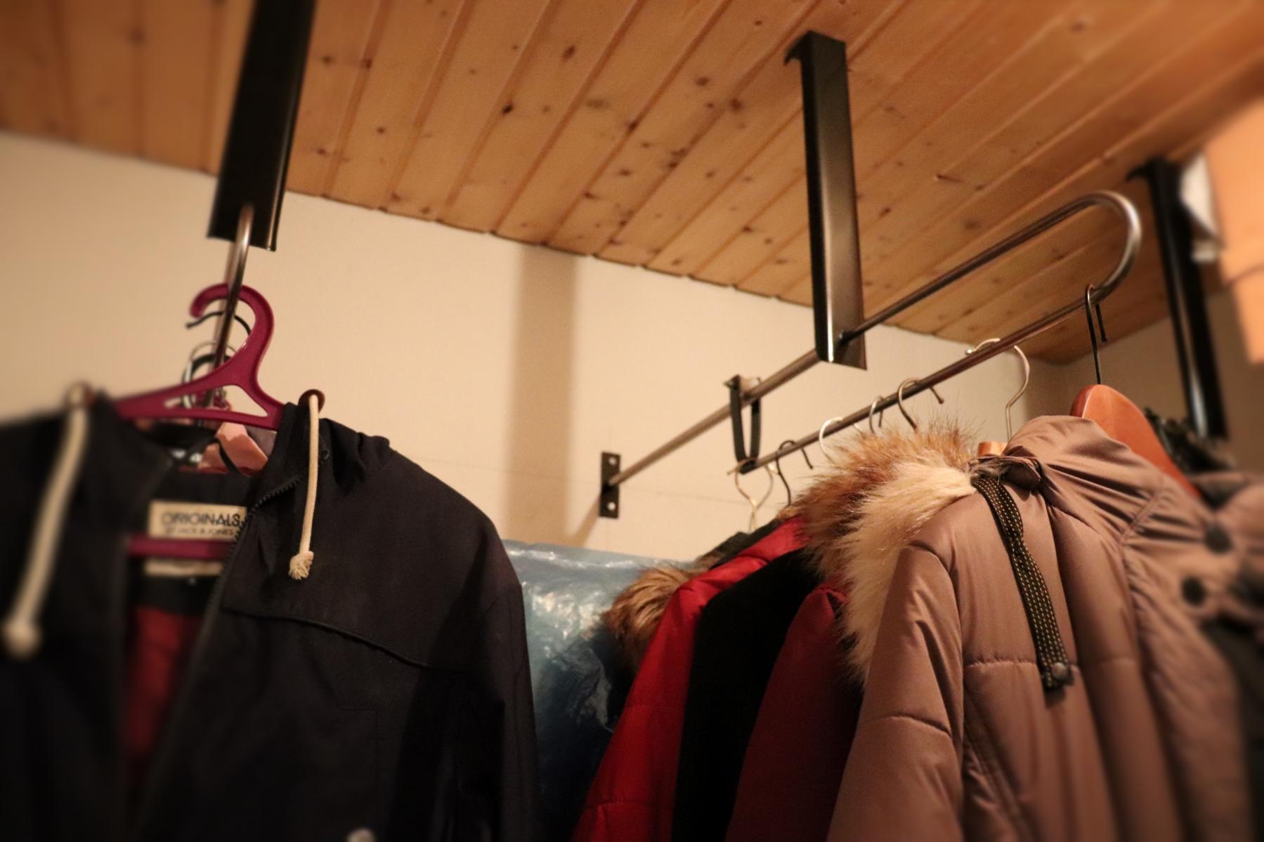

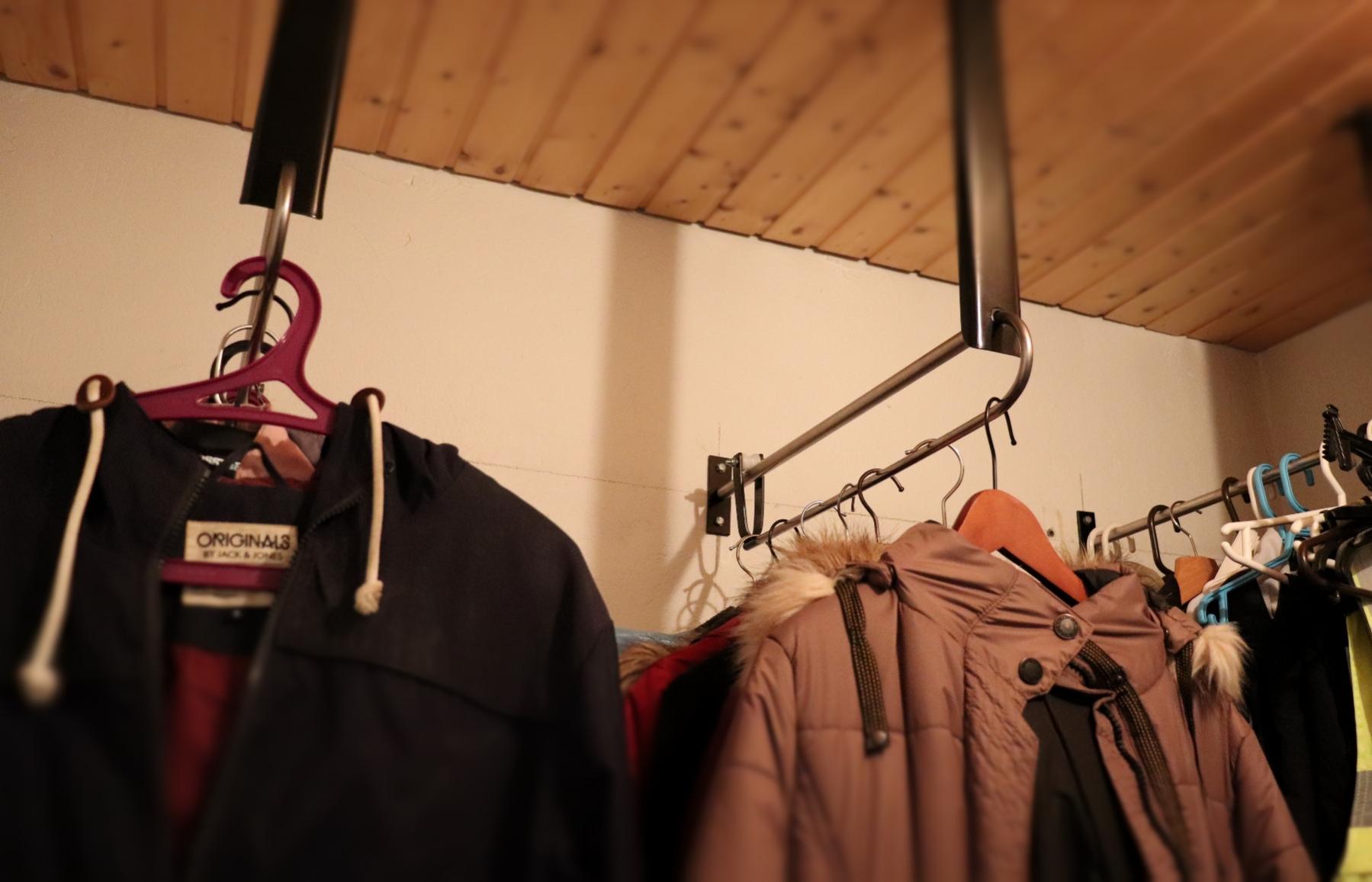

Pull out hanger racks..
Made a hanger racks to our basement. Similar design can be used in closet too.
Attachment 24483
Attachment 24484
Two 5 min videos:
Part 1:
https://www.youtube.com/watch?v=XOQv-1YQ5J8
Part 2:
https://www.youtube.com/watch?v=KjvP...ature=youtu.be
Materials:
2mm sheet.
16mm stainless pipe, and 10mm stainless rod.
3mm x 20 flat bar.
Nylon rod with 20mm dia.
Video is in two parts because some sites have been using my videos on facebook without my permission.
Tought that sharing it to two parts makes it little more difficult.
That's a great idea! I've been watching your other videos too. Some really great content.
Your idea really caught my eye. Rather than hanging clothes, what if I hung plastic drawer cabinets? Then I could make better use of deep storage spaces.
Thanks!
Rick
