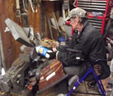

This little band saw cuts almost perfectly true but the pump is out so my wife has to sit there and baby sit it with coolant dribbling on the blade
Attachment 9009

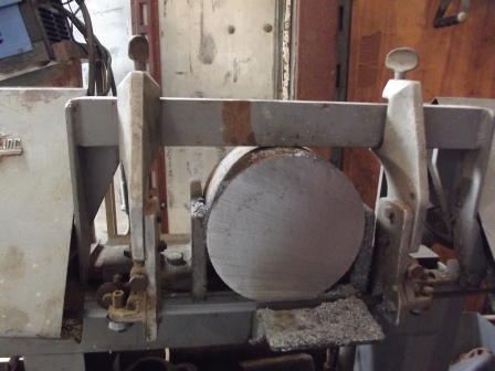

The band saw is pretty much at its max when cutting this size round bar
Attachment 9010

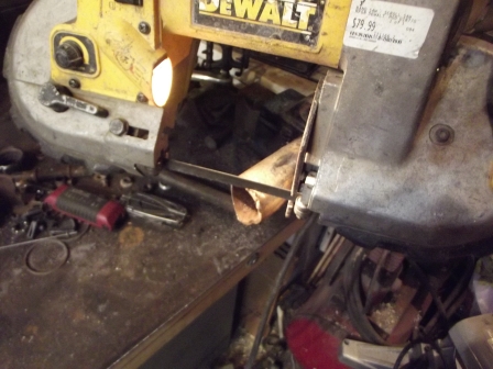

cutting a sadle cope in a 2" od tube with my hand held pawn shop special band saw
Attachment 9011

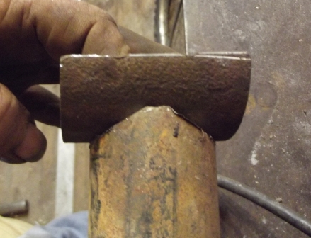

perfect fit to a half shell piece of pipe slightly relaxed to fit the sprocket housing of the bicycle
Attachment 9012

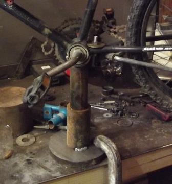

A couple of quick welds and the bicycle bolted to the stand free to be rotated 360°
Attachment 9013
