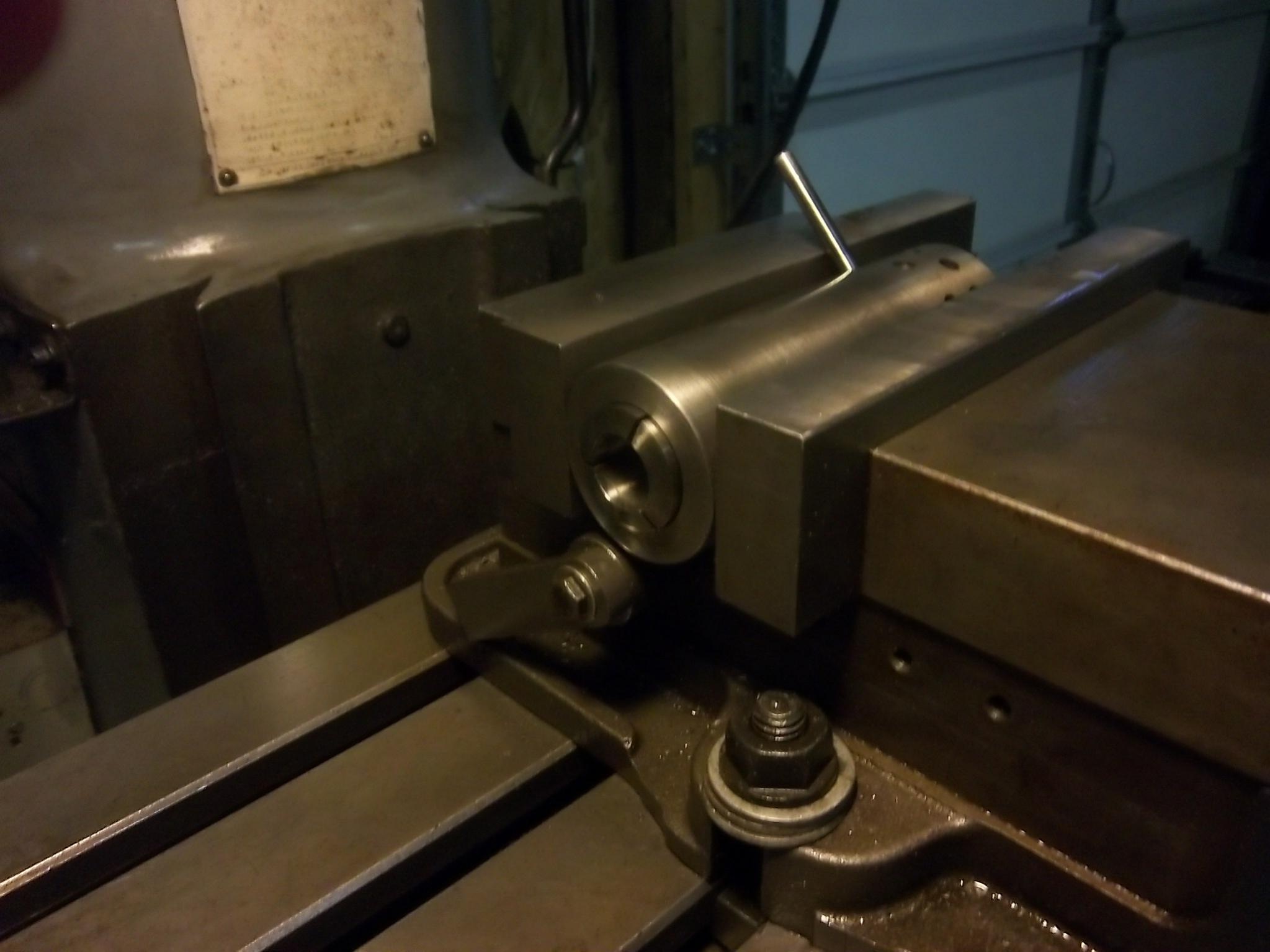

Attachment 8020 I built this to save from having to lift my heavy indexer onto the mill for small jobs. Any spacing of holes needed could be added. Just rotate the pin in the reamed hole against the solid jaw of the vise each time to index.

What a great, simple solution to simple indexing! Thanks for the idea!
