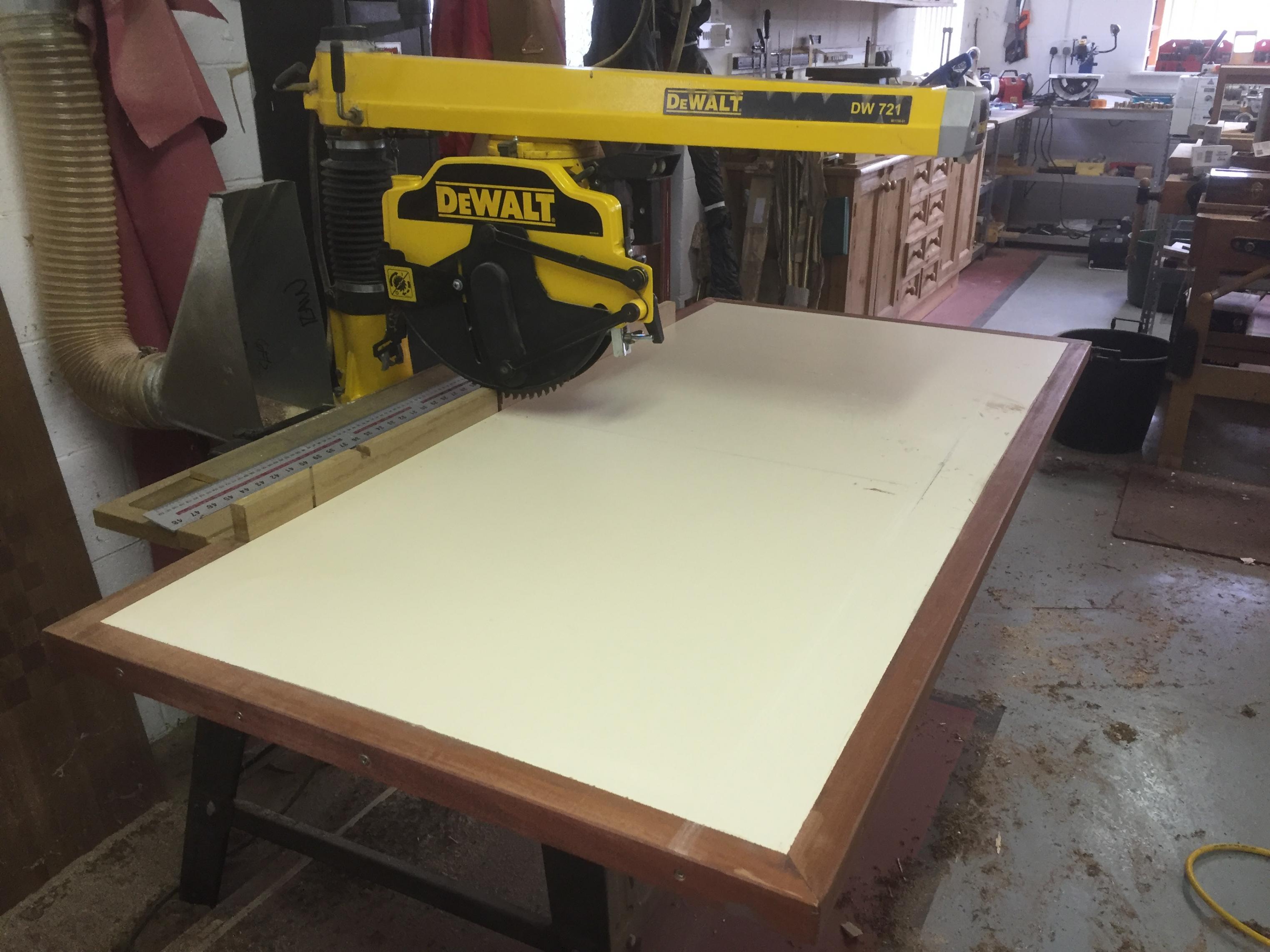

Firstly, there is the table itself, which in my case, is not sacrificial:
Attachment 8874
It is made from melamine-faced particleboard; for ease of cleaning and for slipperiness.

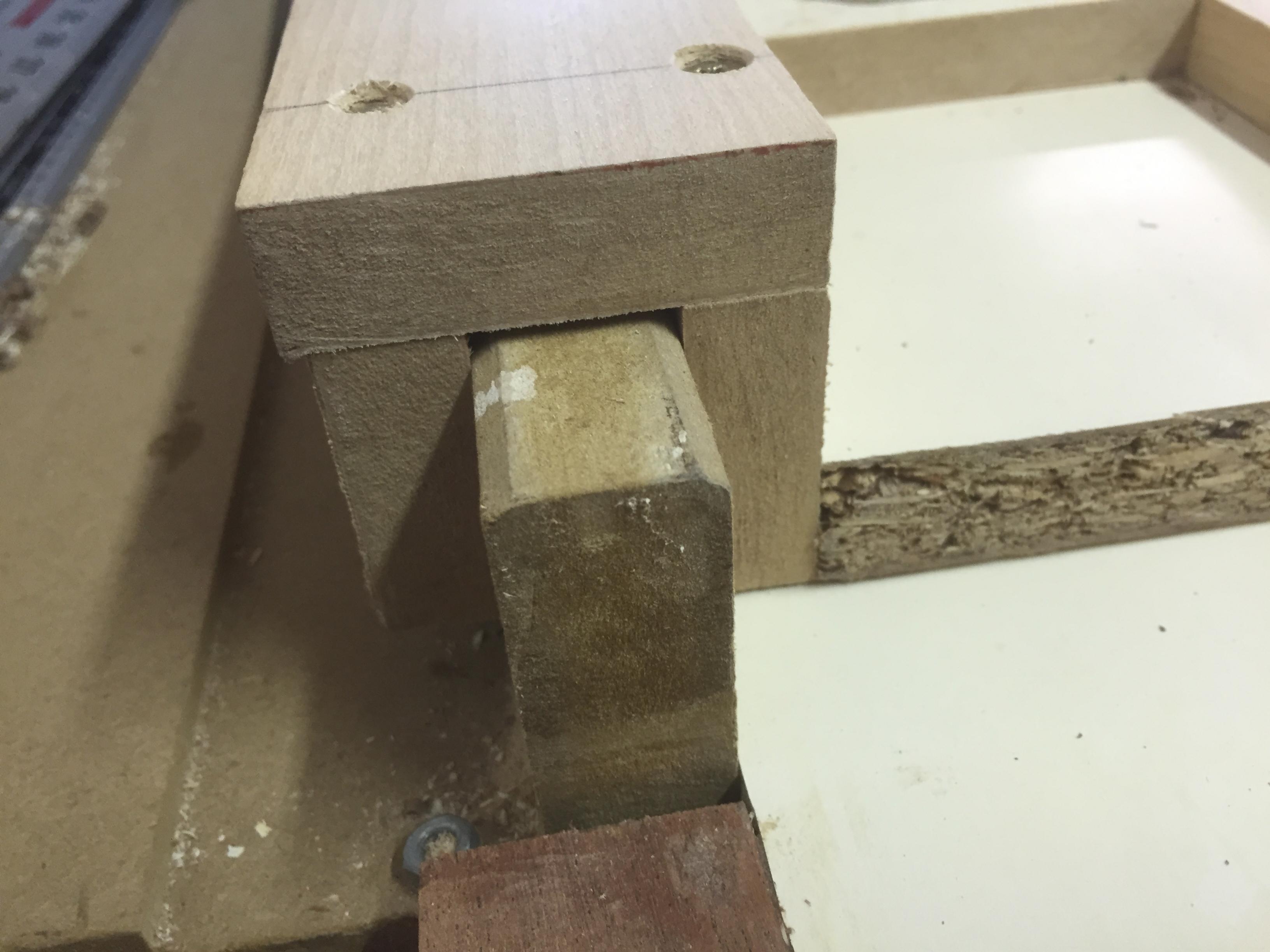

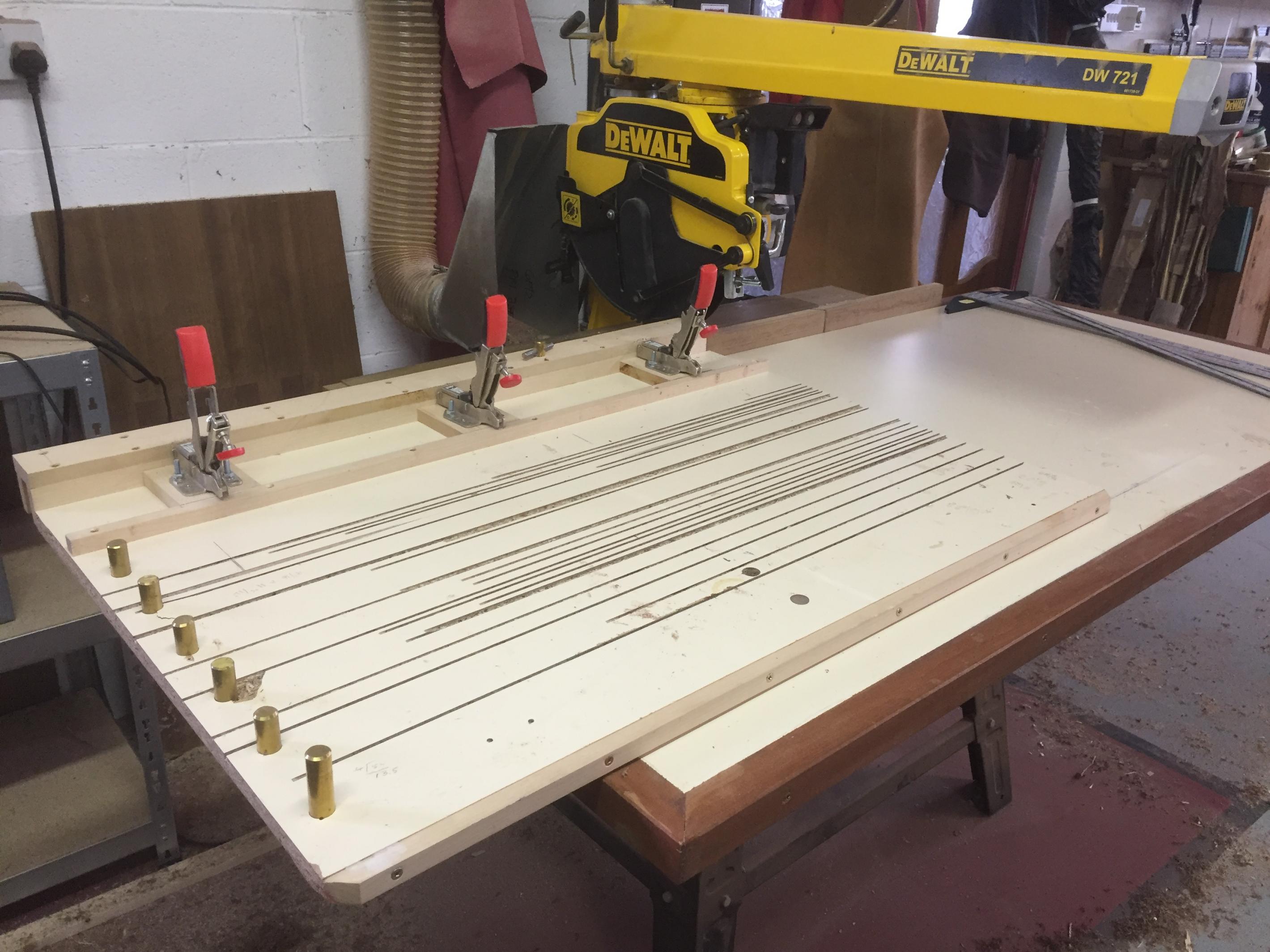

Next comes a sideways sliding table (x direction, that is) made from the same material. This might seem a strange idea with and RAS but, read on. The table is constructed in a way that it hooks over or straddles the rear fence of the original table in a way that prevents slop:
Attachment 8875 Attachment 8876
Kerf lines are visible on the auxiliary table in the photo from previous ripping operations; the auxiliary table is sacrificial.

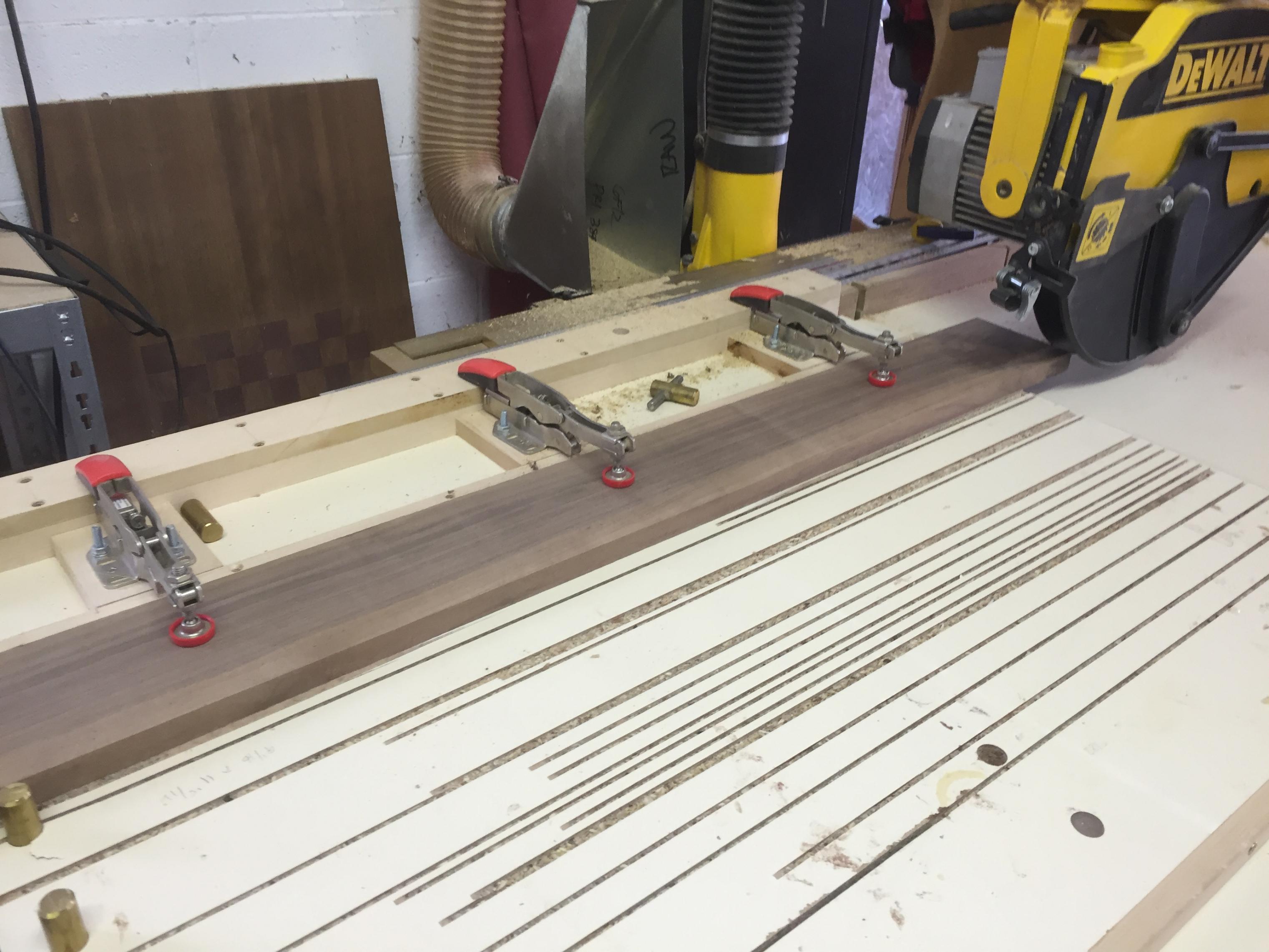

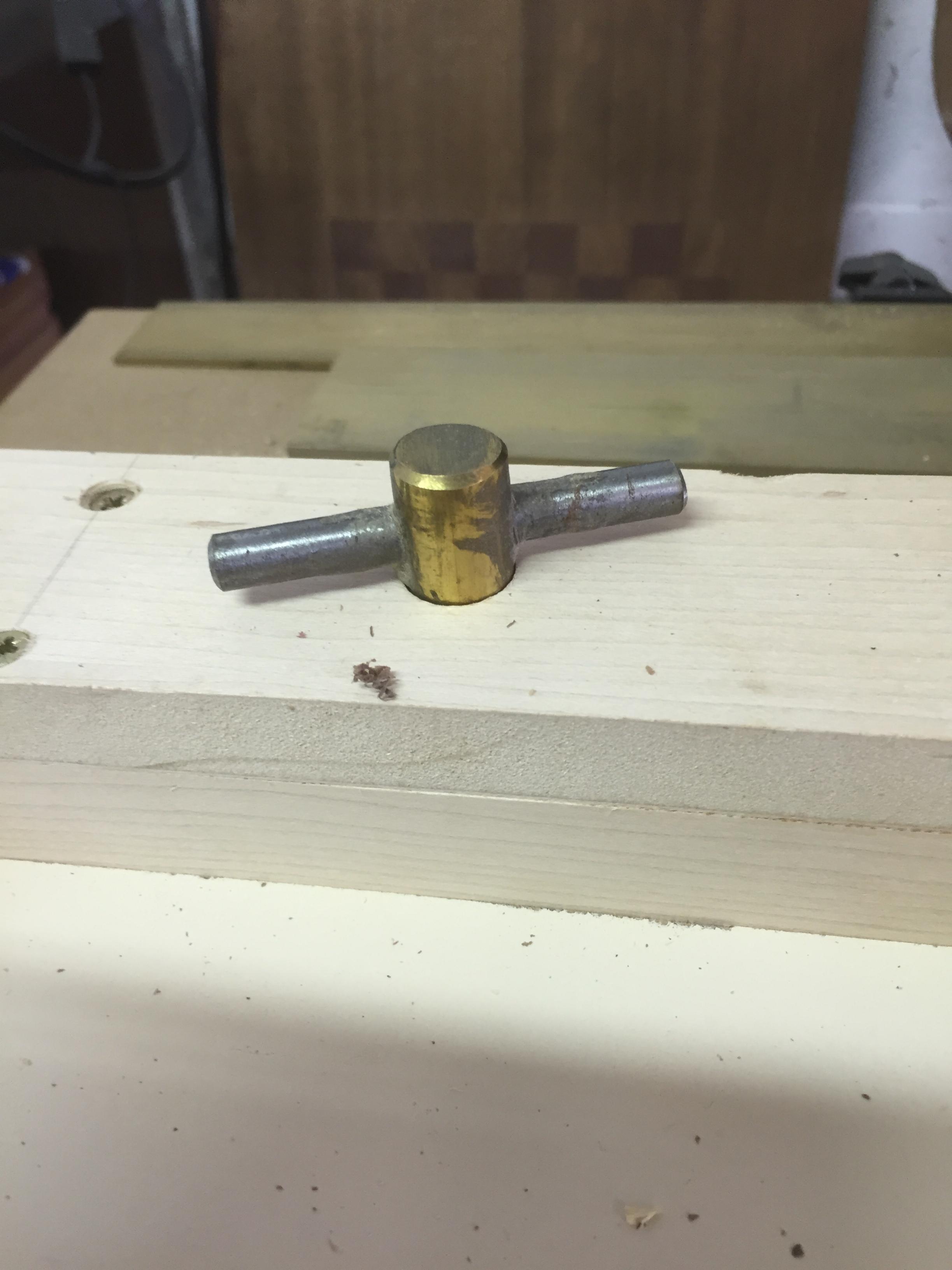

The back fence of this auxiliary table is designed to be exactly parallel with the original table's fence. Examination of the photographs will show that the are three clamping devices which hold down the work piece firmly when cross cutting or ripping. Another important feature of the auxiliary table is a pin which automatically drops into a corresponding hole in the original table's fence when aligned, thus, locking the auxiliary table into place when cross-cutting for example.
Attachment 8877

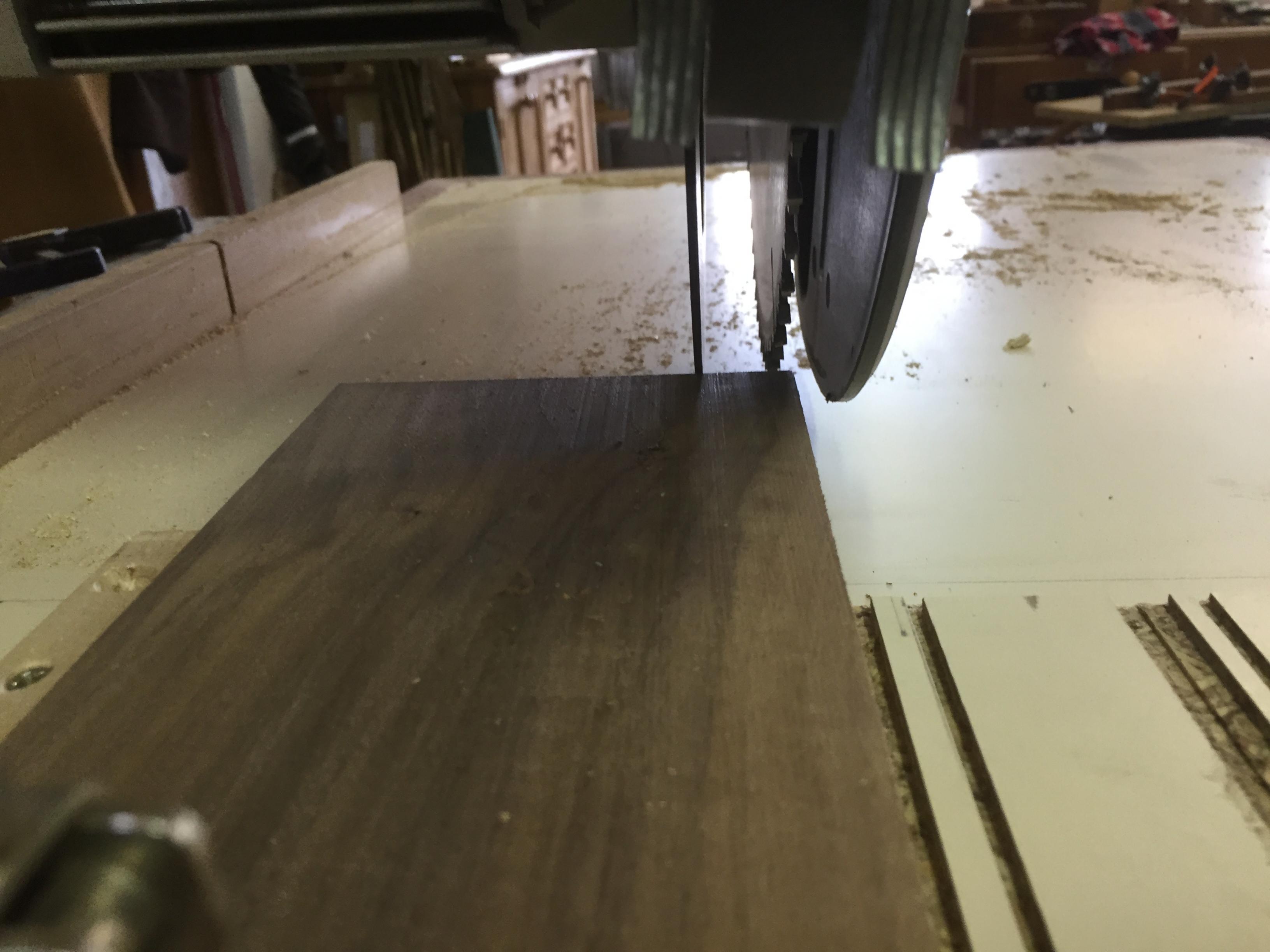

The following photo shows a board of walnut ready to be cross-cut to length. It is clamped in position. A stop arrangement to the right ensures that repeat cuts will be exactly the same. The auxiliary table's lock pin is in the down position, so everything is solid. The cut can be made safely and cleanly with no hands or thumbs needing to be near the blade. In fact, the cut cut could be made with just one hand operating the saw.

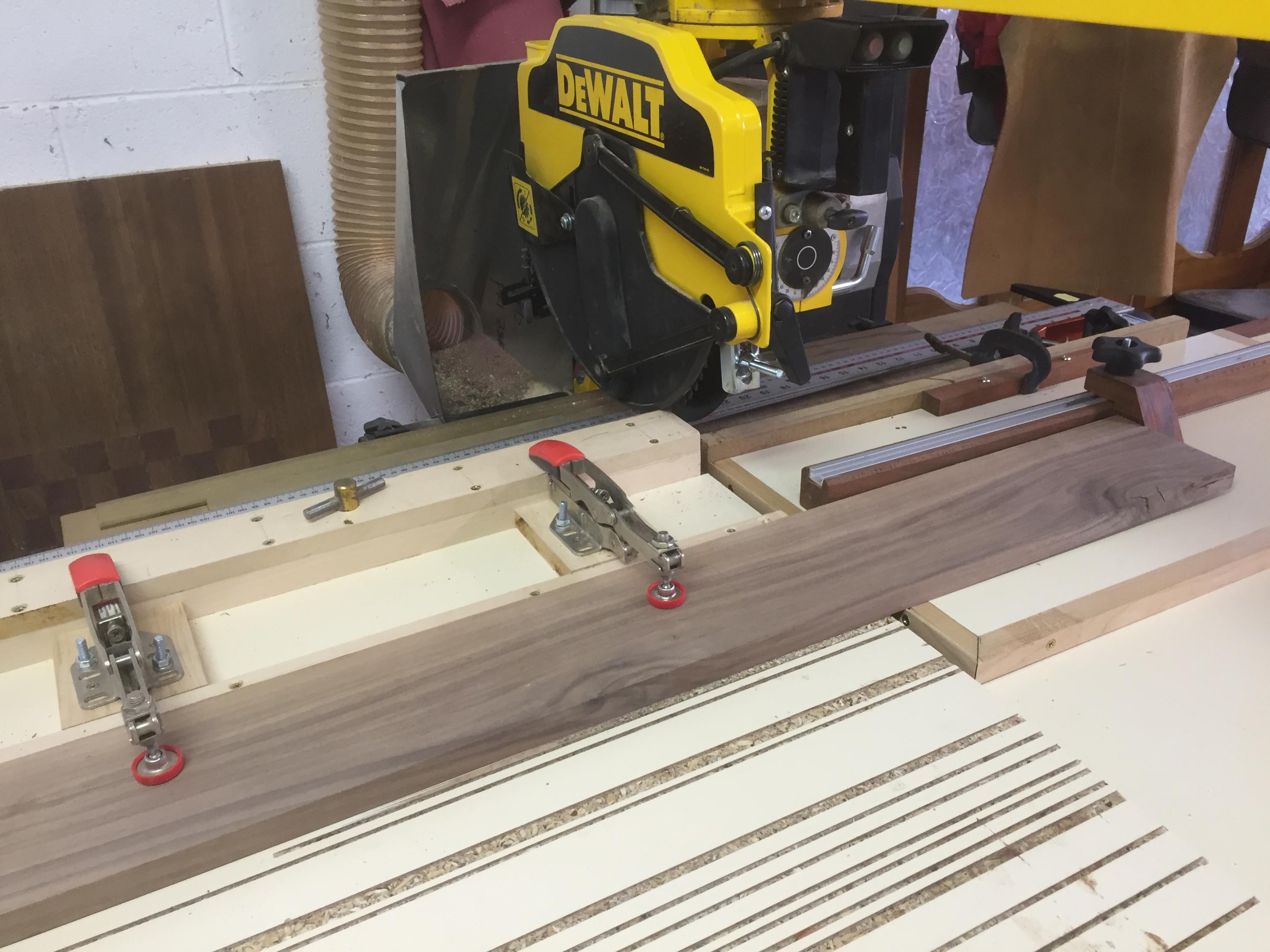

The next photo shows the set-up for a rip cut; here it is set up for trimming the edge of a board. It could just as easy be for straightening a board, ripping down the middle or be even set up to cut tapers.
Attachment 8879
Here's a view looking towards the blade:
Attachment 8880

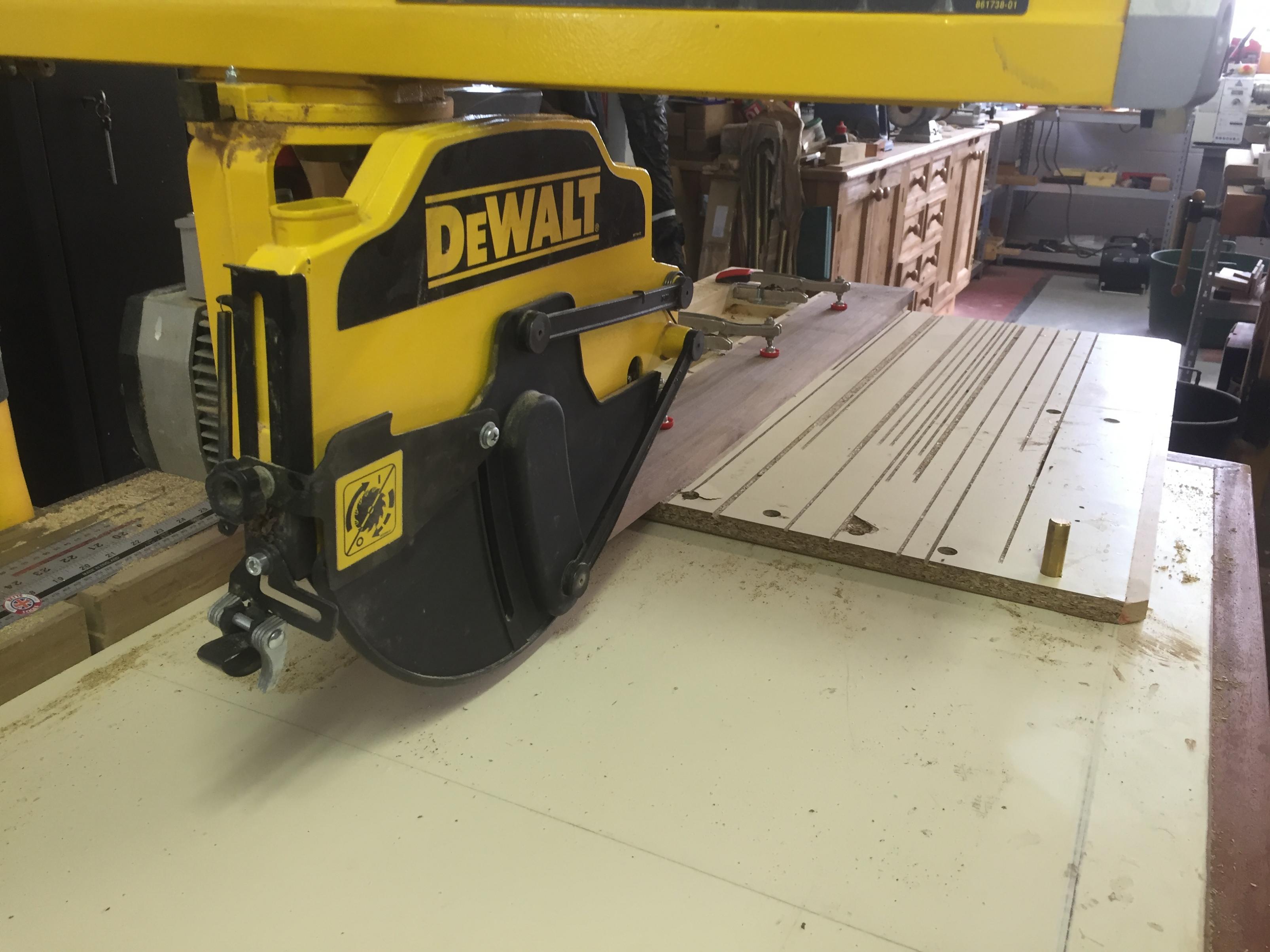

And finally, after the cut; the sliding table has been moved from left to right and the operator didn't need to stand in the line of fire of the blade. All done from the front of the table.
Attachment 8881
Now you can see why I wanted to use a melamine faced board for the tables as it slides relatively easily.

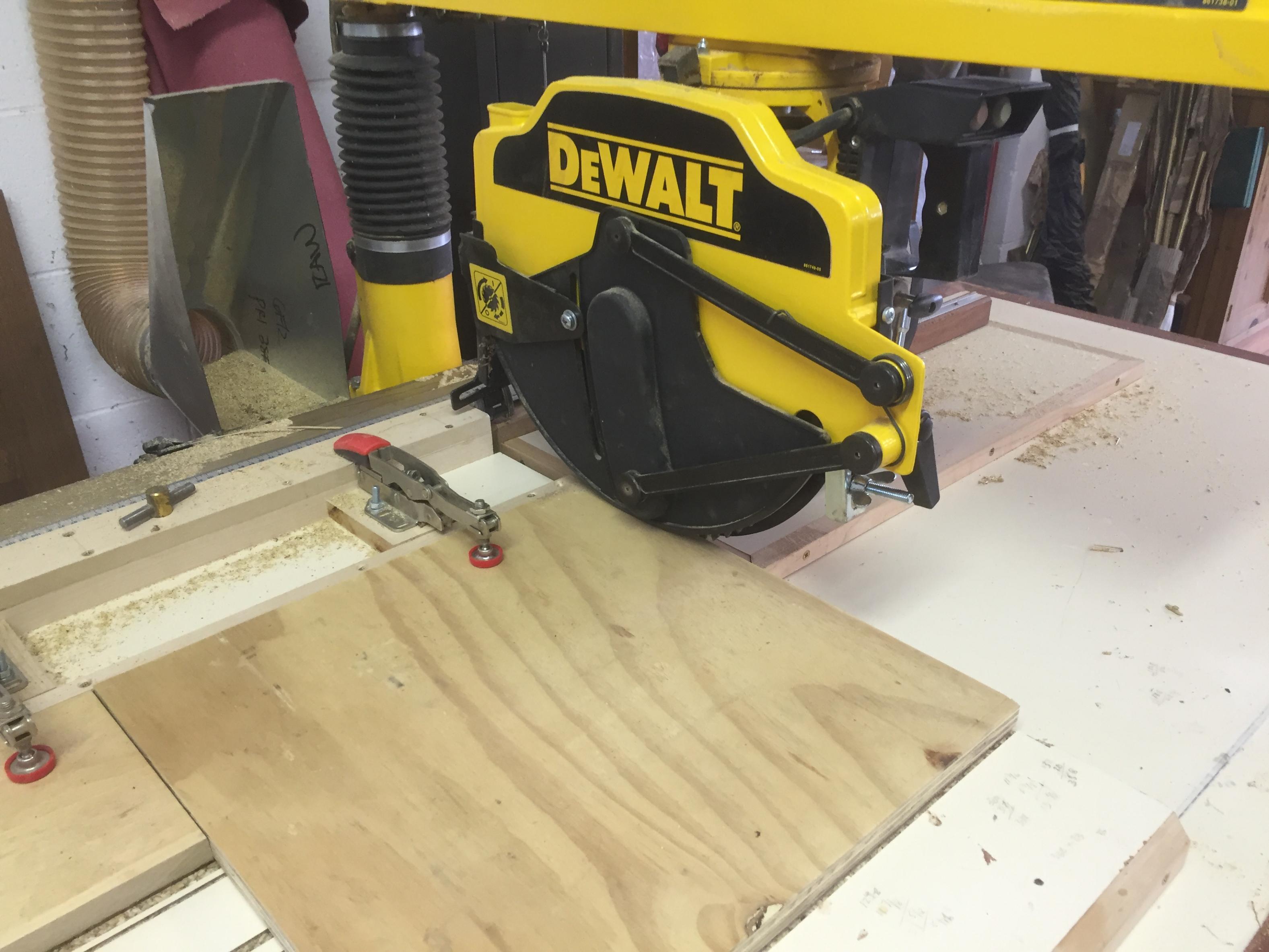

The set-up described above is also great for cutting medium to small sized sheet materials. The next photo shows a plywood square panel being cut to size. Cutting a panel like this is basically like doing long cross-cuts.
Attachment 8882

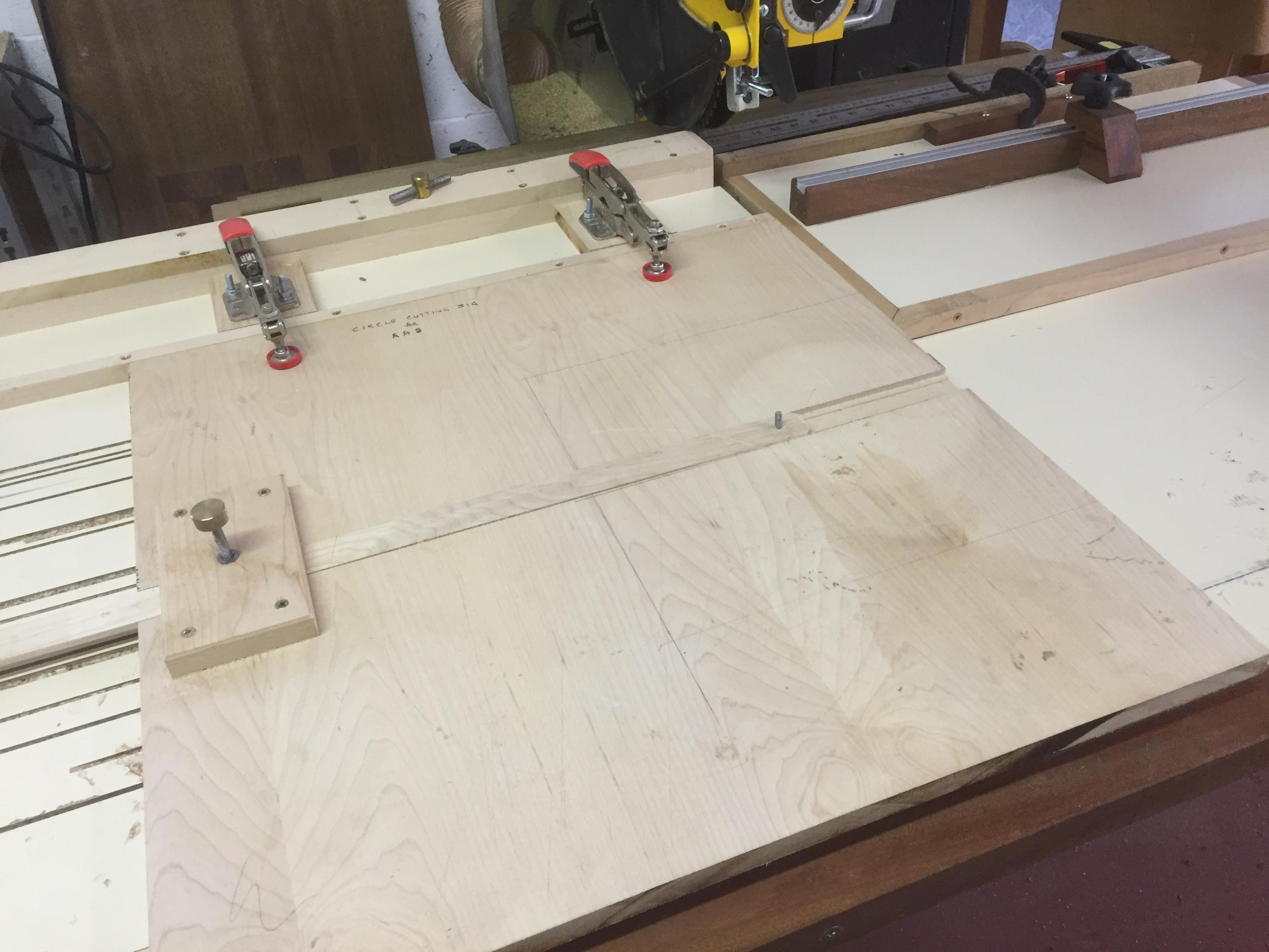

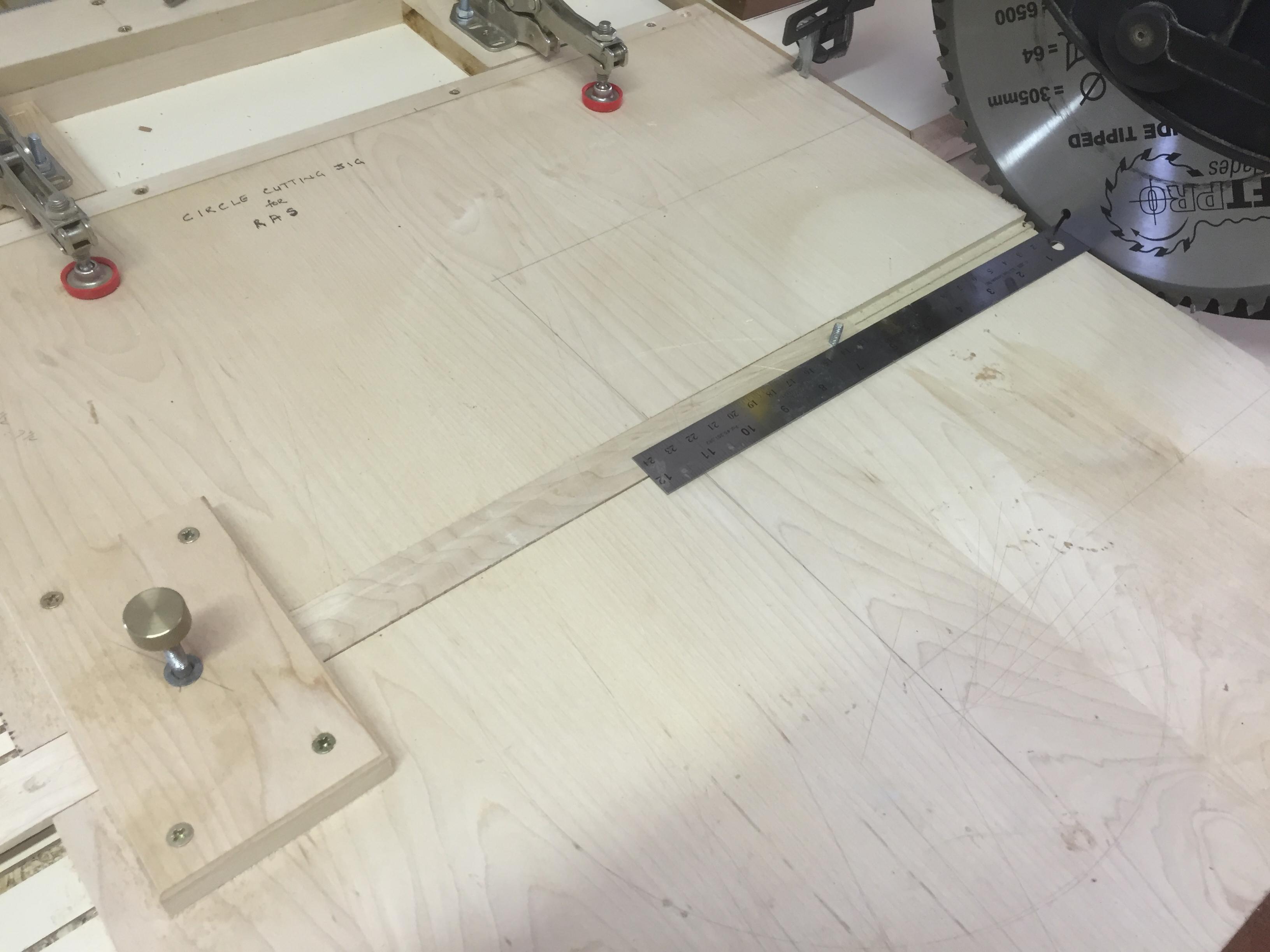

And now a nice little jig that simply clamps straight onto the auxiliary table. Can you see what it is? It may come as a surprise to know that it is actually a circle-cutting jig; and one that works remarkably well. How, you might ask, does one cut a circle on a RAS?
Attachment 8883
Well, the principle is very simple: keep cutting the corners off a square shape, again and again. and you will end up with a circle. Believe it or not, from set-up to finished circle only takes a few minutes.
The following sequence of photos show the setting up and cutting process:

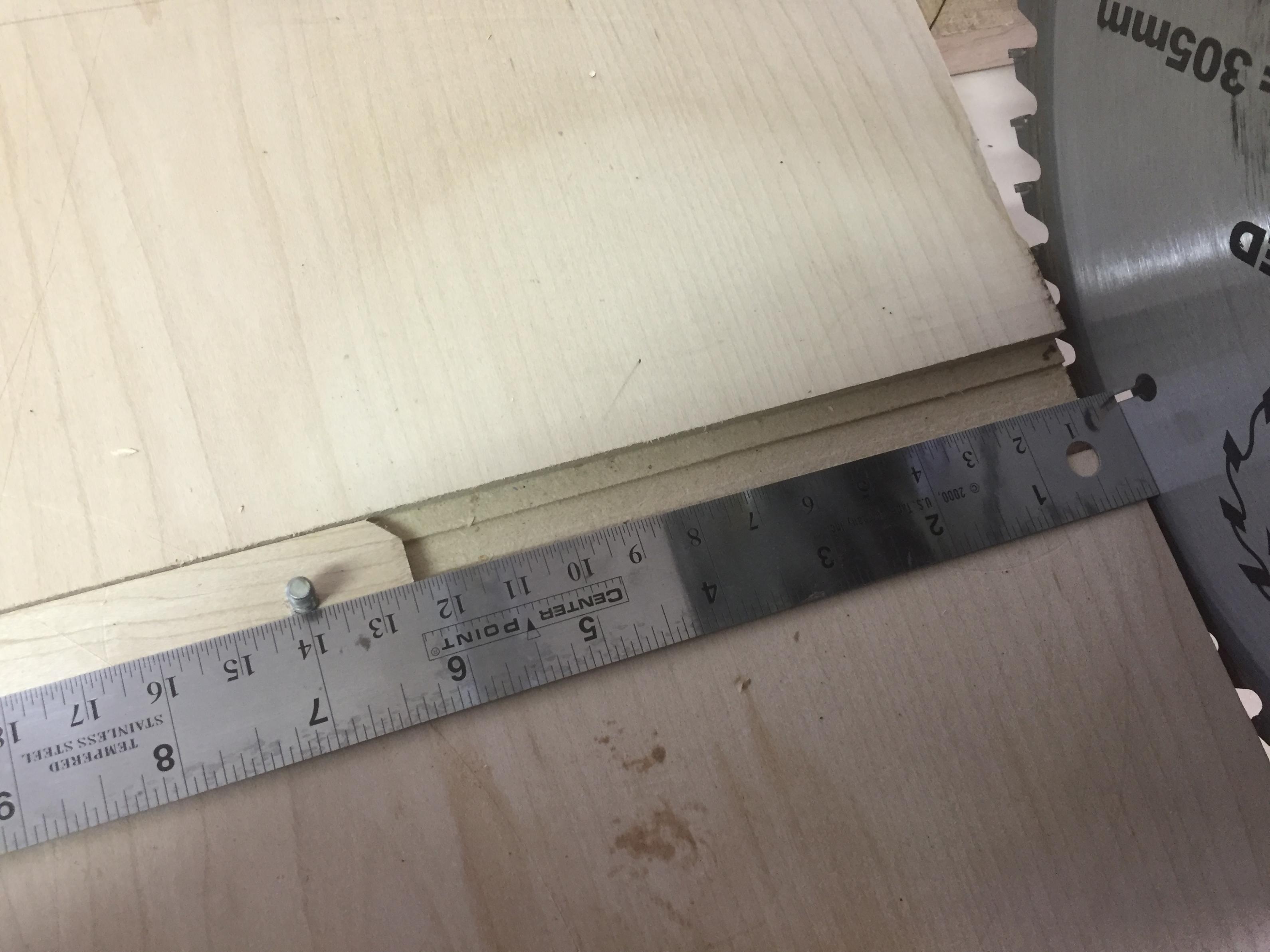

First setting the jig for a 14" dia. circle.
Attachment 8884
Now, see the knob on the left that tightens up the setting on the jig:
Attachment 8885

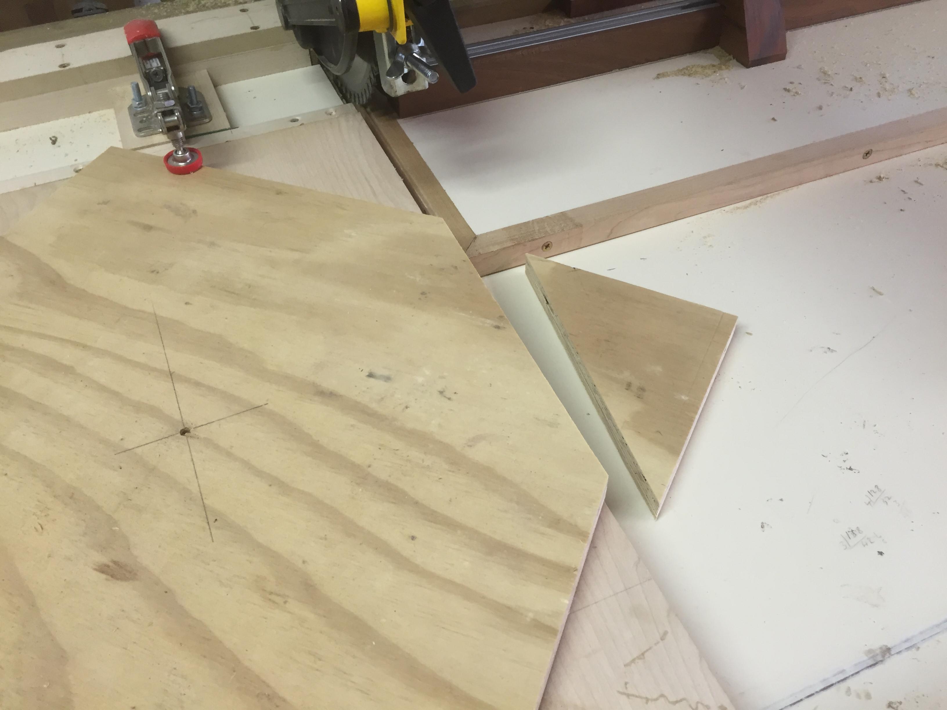

Now, imagine the square of plywood we cut earlier; we find its centre-point and drill an appropriately sized hole and drop it over the pin on the jig. Now, we simply hold it firmly in place and cut off the first corner; just as if we were doing a regular cross-cut.
Attachment 8886

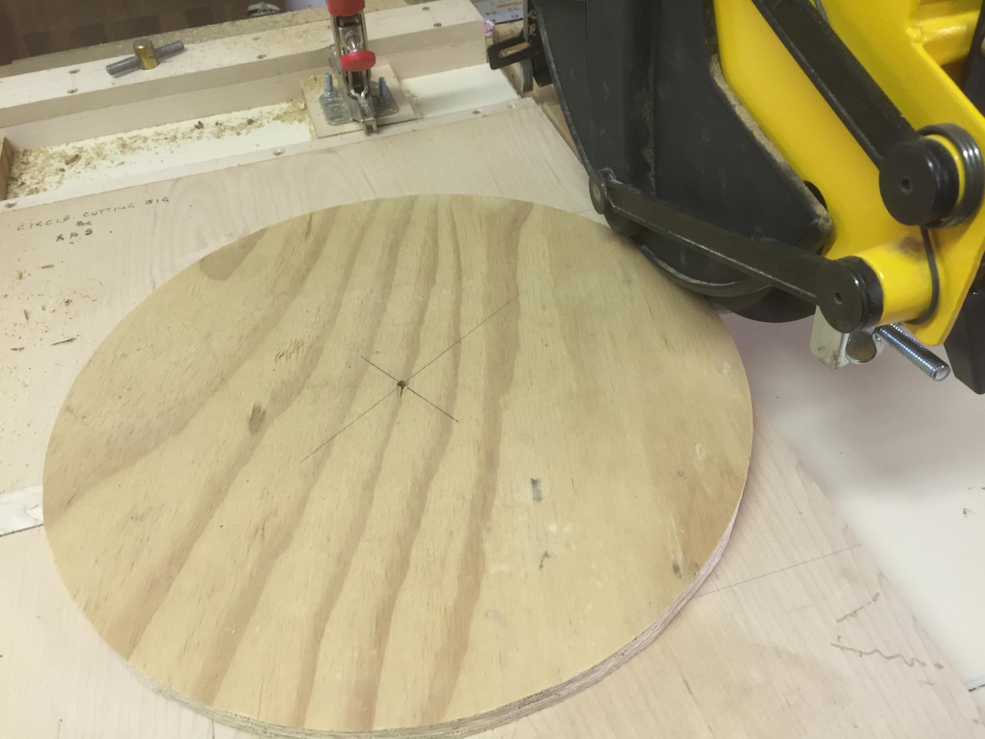

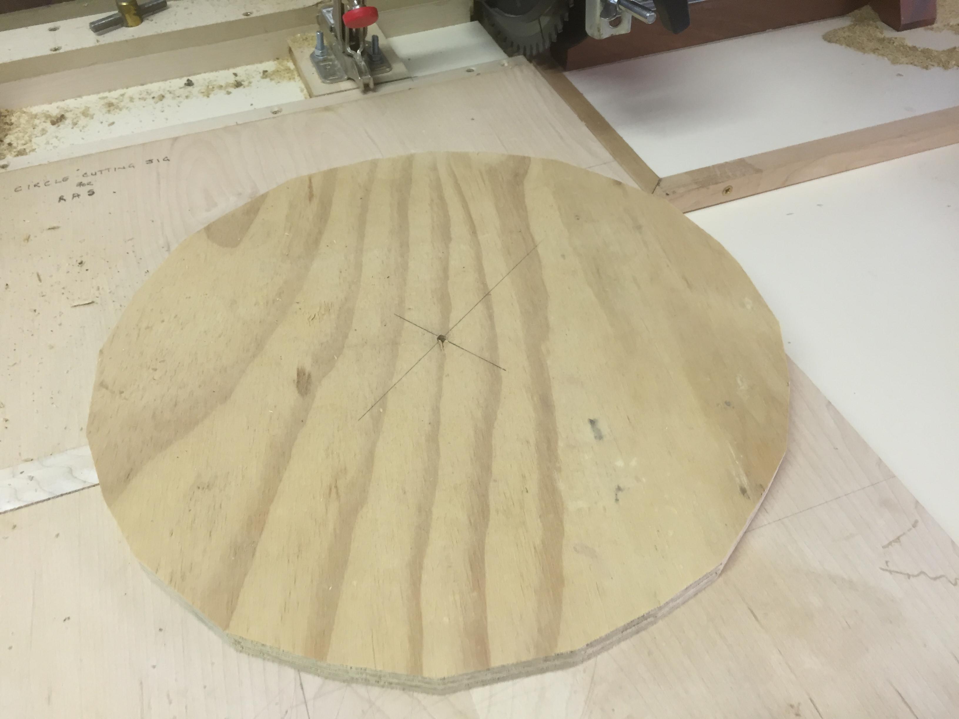

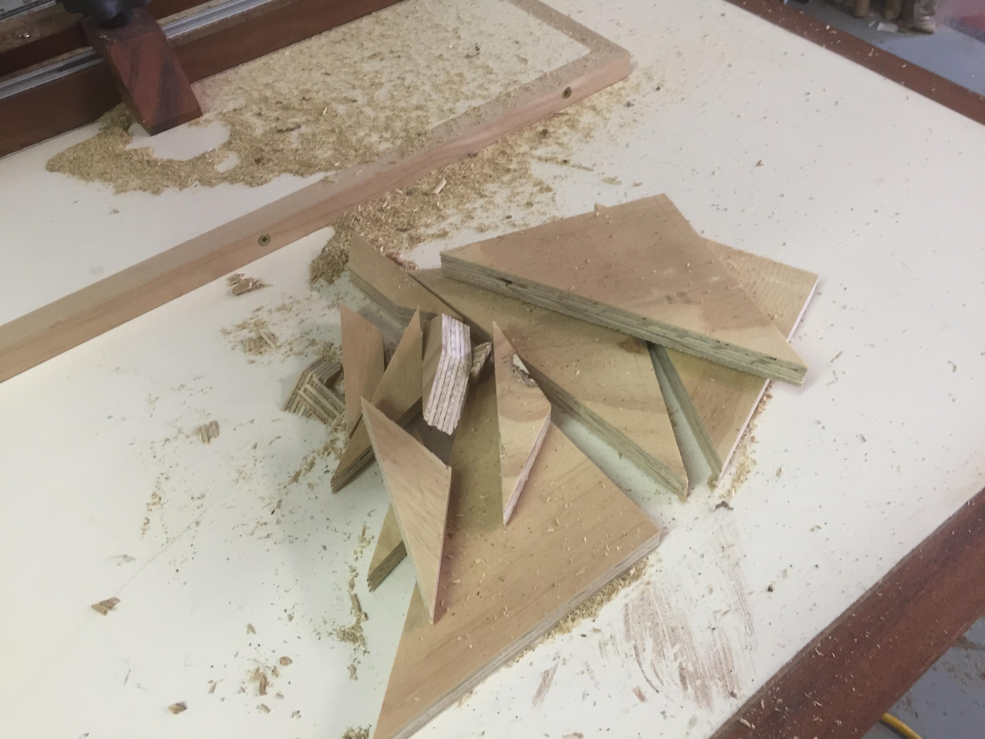

The photo above shows the first corner cut off. It is now only a matter of rotating the plywood 90 degrees and cutting of the next corner and so on. When all four corners are cut off, we start on the next lot of smaller corners until we end up with what we see in the next photos:
Attachment 8868 Attachment 8869,
A near-perfect circle and a little pile of debris.
All that is left now is to set the blade at the appropriate position along the arm and turn the disc-shaped plywood into the blade to trim off the hairs:
Attachment 8870.

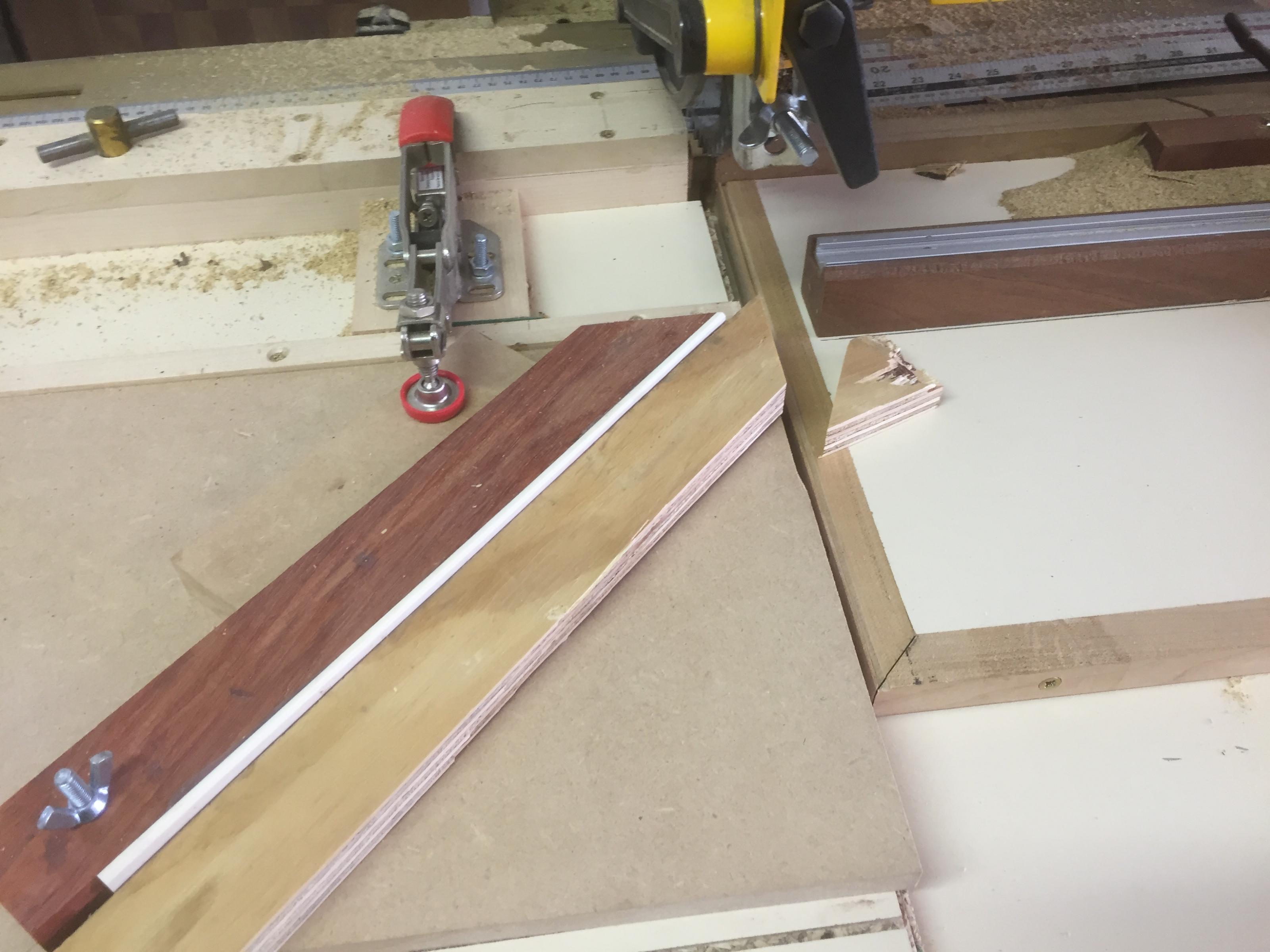

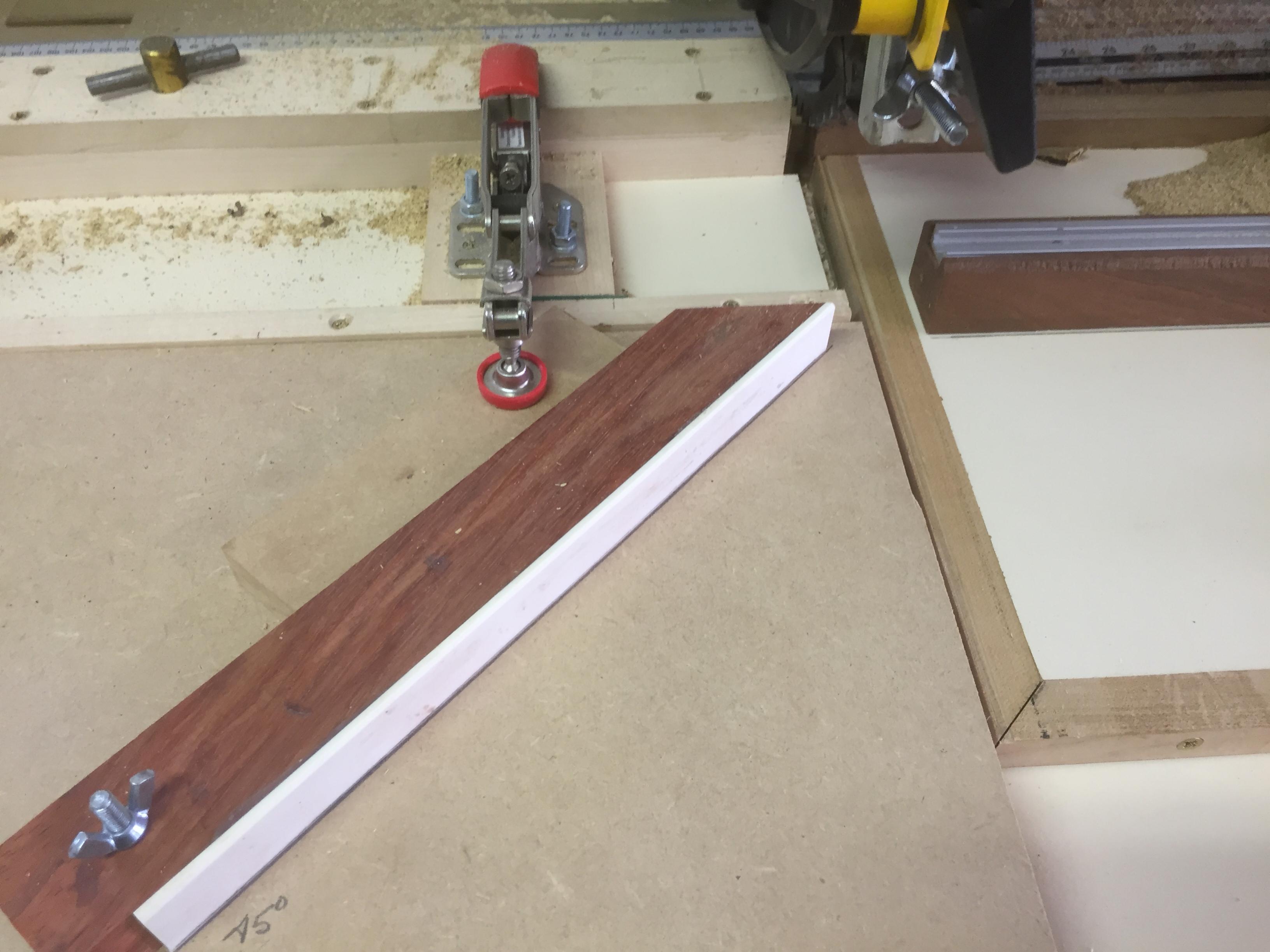

Of course, a Radial Arm Saw is capable of doing all sorts of unusual jobs but I will cover just one more of the common tasks that I use the RAS for; cutting mitres (perhaps 'miters' where you are). Again, this requires the simplest of jigs clamped down onto the auxiliary table. A fence fixed at the required angle to a piece of MDF :
Attachment 8871

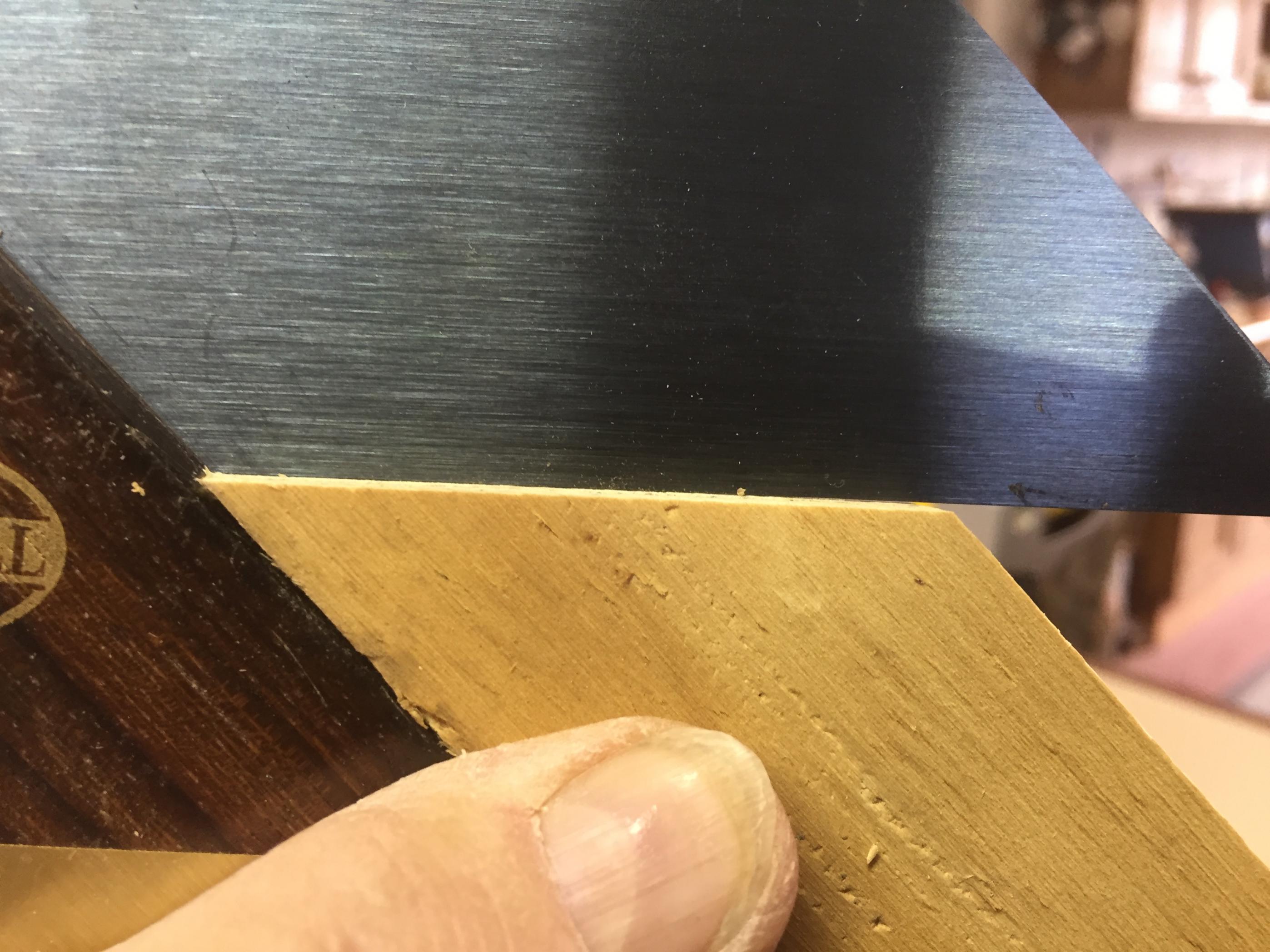

The final photos show a mitre (miter) after being nipped off the end of a piece of plywood and the cut being checked against a 45 degree square. Looks pretty accurate to me!
Attachment 8872 Attachment 8873
